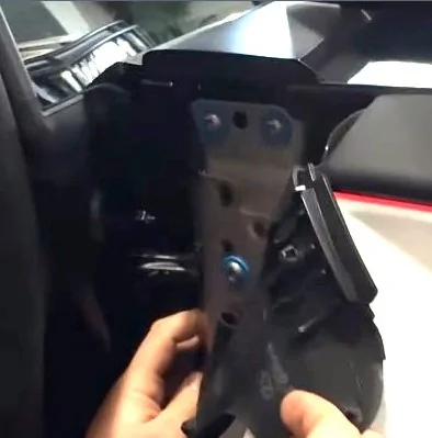

Guys, zoom in on the video. I posted a screen capture.
It appears to me, he pulls the trim back from the inside jam and removes the screws FROM THE INSIDE DOOR panel, that is NOTHING penetrates the SS exterior door panel. It looks like the mirror cantilevers over the top edge of the door to the outside. After removing the screws and disconnecting the electrical it looks like the trim would simply be snapped back in place. Yes, that is easy peasy.
It appears to me, he pulls the trim back and removes the screws FROM THE INSIDE DOOR panel, that is NOTHING penetrates the SS exterior door panel. It looks like the mirror cantilevers over the top edge to the outside. After removing the screws and disconnecting the electrical it looks like the trim would simply be snapped back in place. Easy peasy.
There's a hole that lives on the wet side of the trim.

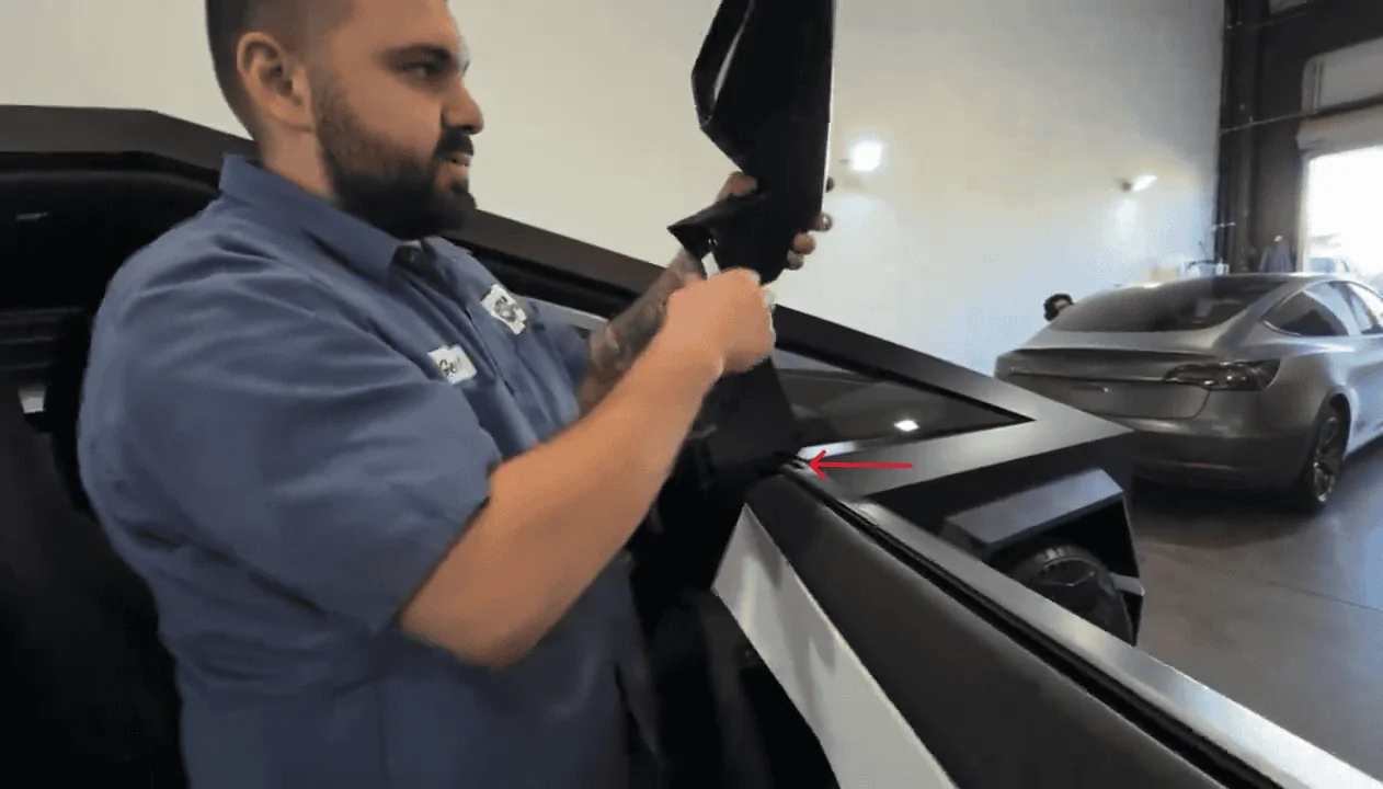

What covers the hole where it was installed?
Nice, but I would like to see what the outside looks like after removal. Does it leave a big hole?
I would anticipate that one or more of the bigger Tesla aftermarket companies will have a cool looking patch to cover the holes. And if not, then there are a ton of companies that you send your drawings to and they will waterjet some parts for you, and/or 3D print parts for you, or at a minimum, the 16 year old down the street with the 3D printer will make you something pretty cheap.

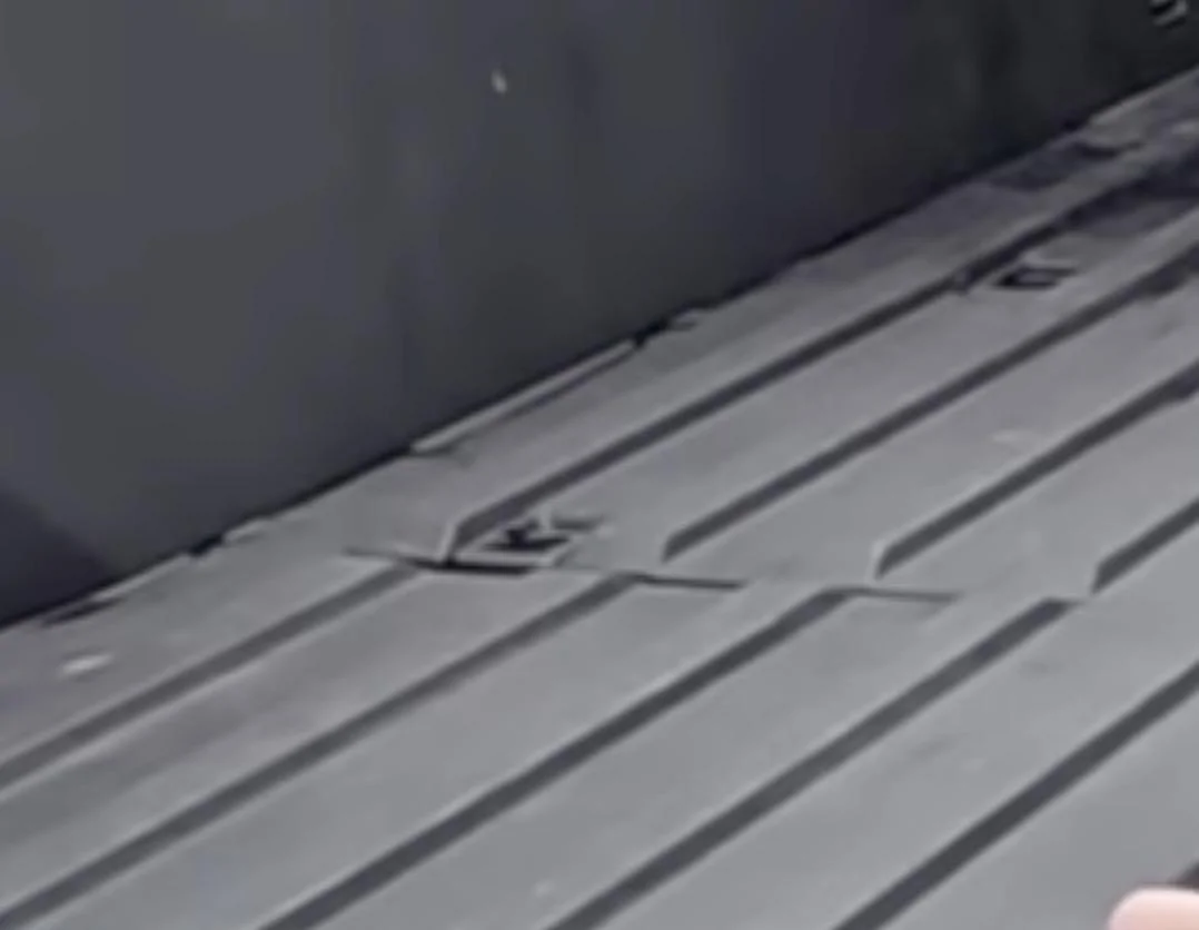

Found the video with the plugs (?)
Though these might be the roof rack plugs?
@cvalue13
I actually think those are bed floor pieces, removed for the D-Ring accessories that are installed.

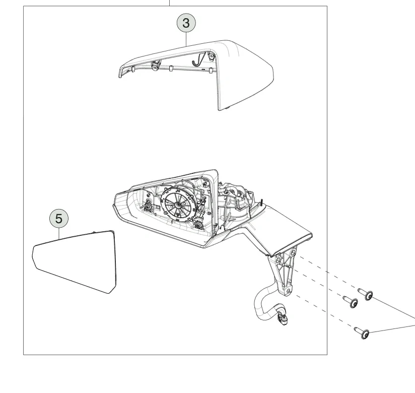

Parts diagram / schematic
