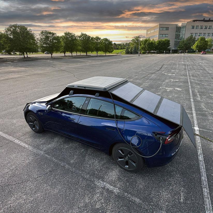

This has a built in 12V inverter and is only a level 1 charger. Possibly a small battery and charger controller too but not sure though.
I imagine that each panel will have its own micro-inverter because otherwise since those panels have different orientations and inclinations, each panel will have a different voltage, making otherwise any combination of string inefficient.
The typical usage will be to park in a east-west direction, so the front panels will produce solar energy in the morning, then around noon the top panel will produce solar energy, and then in the afternoon the rear panels will produce energy.
An alternative will be to park in a north-south direction, so most of the solar energy will be produce around noon time. This orientation would be recommended in winter because of the low inclination of the sun above the horizon.
I expect that the panels are in series, as is commonly the case for a lot of solar, and then MPPT controller / Inverter is used.
I would hope it has two mppt inputs. One on the front and one on the back.
