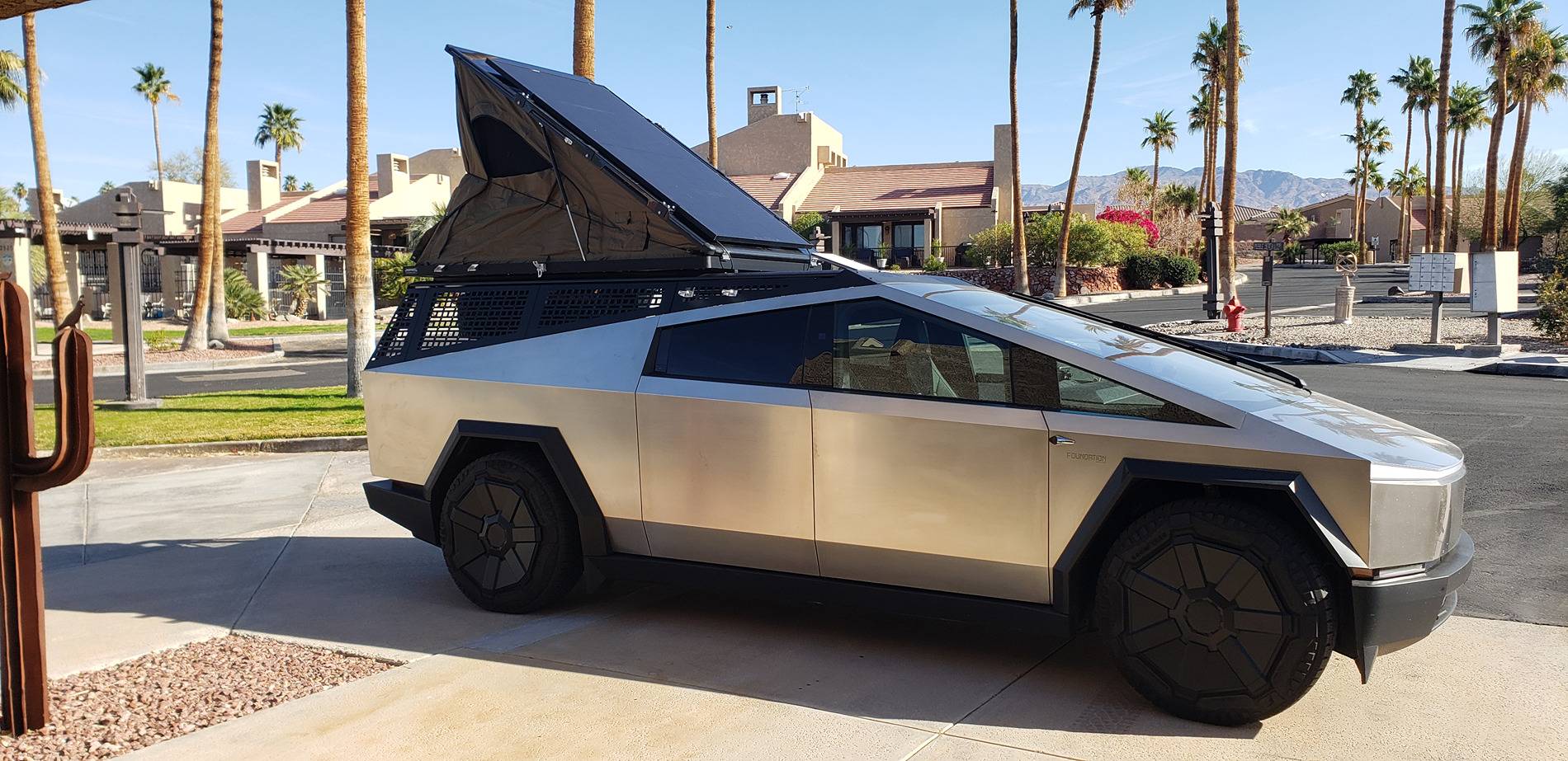

I ran another test charging my CT from the solar power station's 2.5kWh fully charged LFP battery (two EcoWorthy 12.8V 100Ah batteries wired in series). At 64degF ambient, it took 1 hr and 40 min to put 1 kWh of charge into the truck battery consuming 1.58 kWh of energy from the solar battery, reducing its SOC to 34%. That turns out to be an efficiency of 63% charging with the Gen 2 mobile connector at 950W (8A). I'm sure that the loss of efficiency is mainly due to the power conversion losses going from DC to AC and then from AC to DC into the truck. Recovering that energy via solar on a clear day takes 5 to 8 hours depending on whether I'm in camp with the tent open or on the road. My REC 420W Alpha Pure 2 panel was putting out 410W at noon today in full sun with the tent opened up.
Having solar energy generation on overland trips isn't going to significantly extend driving range, but it does help to preserve driving range by isolating electrical loads. Any time I plug something into one of the truck's power outlets, I'm reducing the driving range of the truck. Camp Mode is a huge range reducer. The more I can avoid draining the HV battery, the less stress I feel when located miles from the next charging station. There's no substitute for carefully planning trip charging stops, but having solar does help to make trip planning easier and safer.

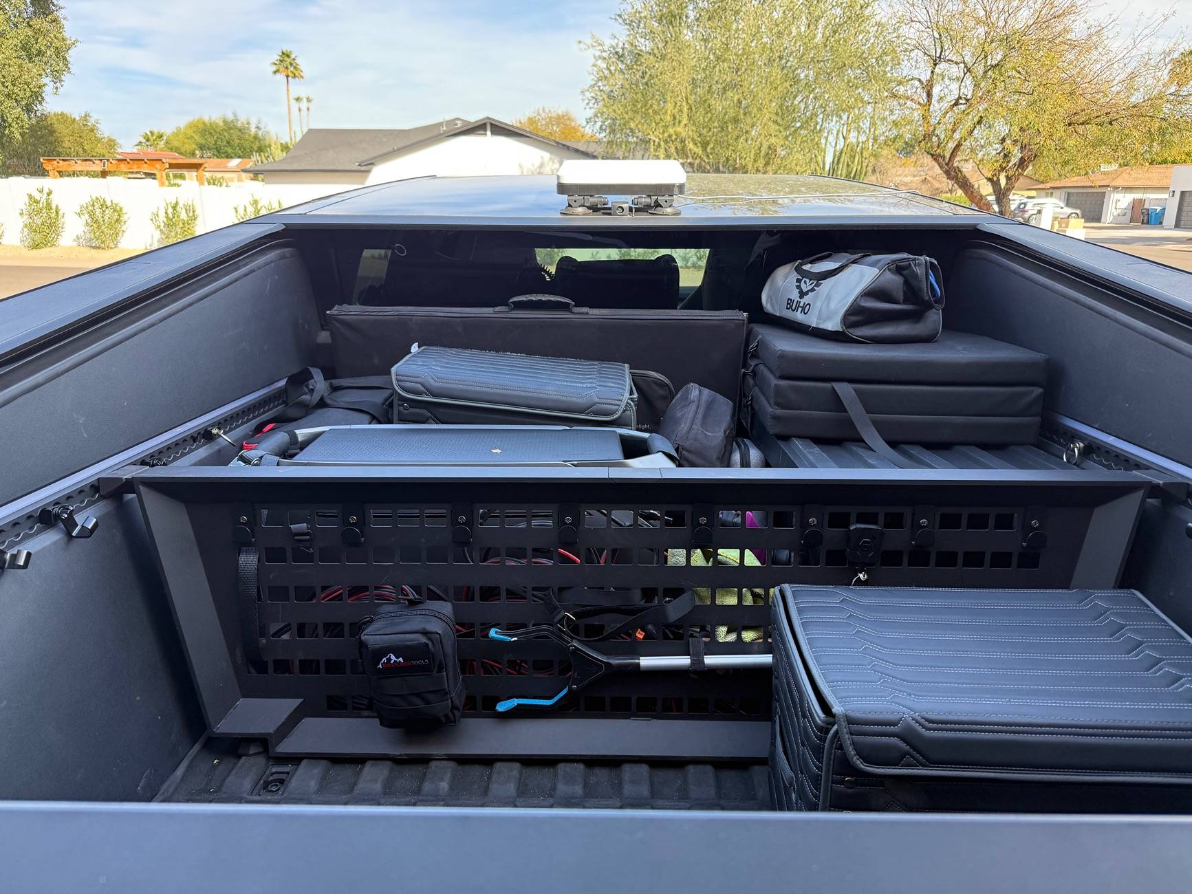

The picture of my bed shows my “daily carry”. It includes the generator strapped to the divider and the solar panels folded at the very back.
In my view that takes up less room than any range extender and potentially can add significantly more range if used intelligently.
I have wondered before if anyone has considered putting something like a delta pro ultra at the very back of the bed.
It’s a bigger battery with a MUCH bigger solar input and would still take a lot less room than a range extender. Probably also cheaper all told but I’m not 100% sure about that.
Tesla Cybertruck Solar Charging the Truck IMG_1646

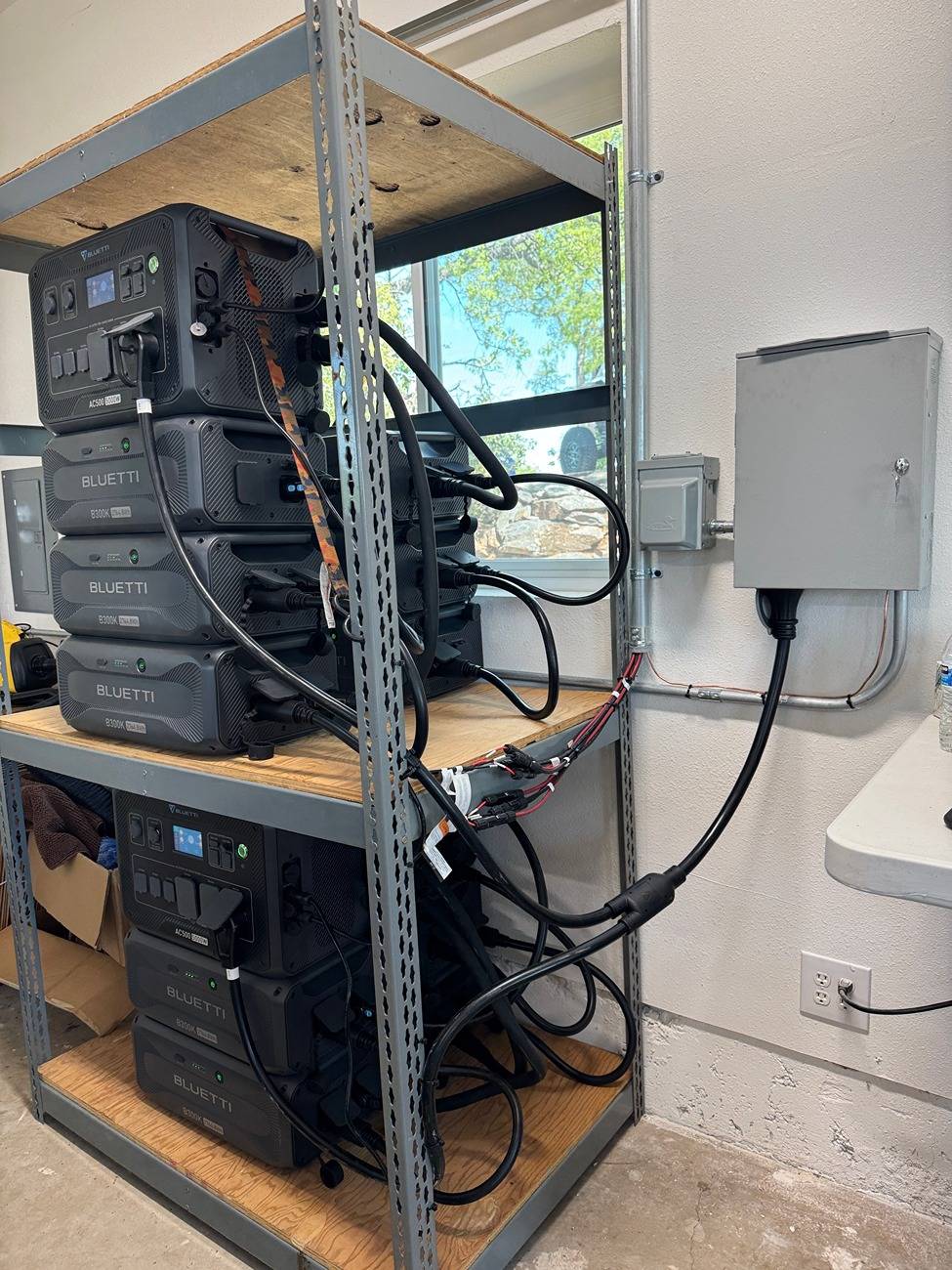

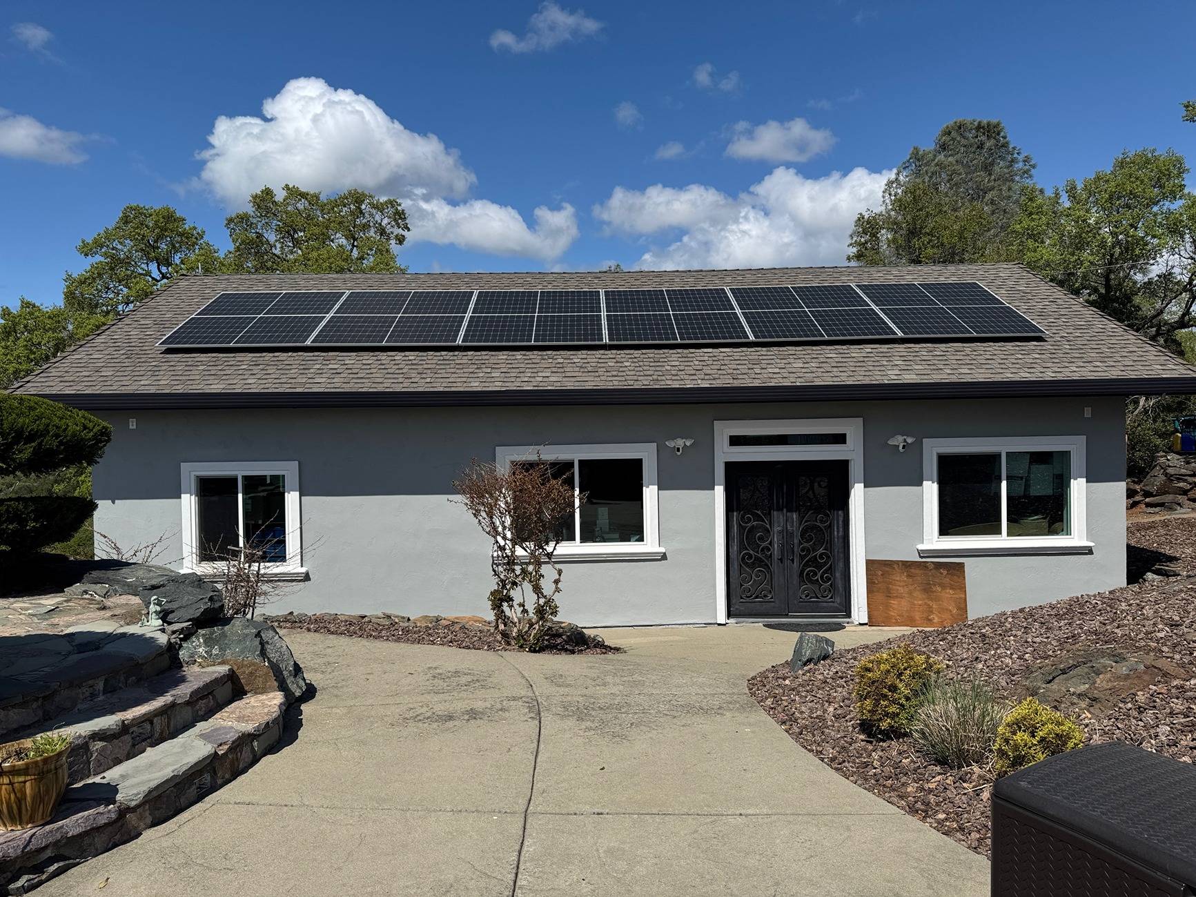

My solar setup is not portable but it is off grid, and substantial.
I pull 27kw-30kw daily out of this to recharge our shop truck.
So basically I can add 25% battery to the truck daily, but you can see just how much equipment that takes.
Basic specs:
2 x Bluetti AC500's in split phase
12 x B300K storage batteries
12 x 480w panels on roof
1 x Bluetti distribution box
1 x Wall connector
Tesla Cybertruck Solar Charging the Truck IMG_7361
Tesla Cybertruck Solar Charging the Truck IMG_7363

Impressive setup. Love it. Those numbers make sense to me. I can trickle charge my car basically while camping, Could not rely on my portable setup to produce anything meaningful other than to ensure I can make it to a supercharger and that I don’t exhaust the truck with my camping needs.

Wow, nice setup! I have a Bluetti 500AC and a smaller Bluetti (maybe a 300AC? I’d have to check!). But the small one I put in the frunk and feed it with the 48 volt frunk accessory voltage and then the little Bluetti powers a DC fridge. The AC500 goes in the bed and at camp I charge that with 600 watt portable panels, and I use the 500 around camp and to have in case I need a mile or more charge to get to a Supercharger.
I like the Bluettis. Great setup, man!
