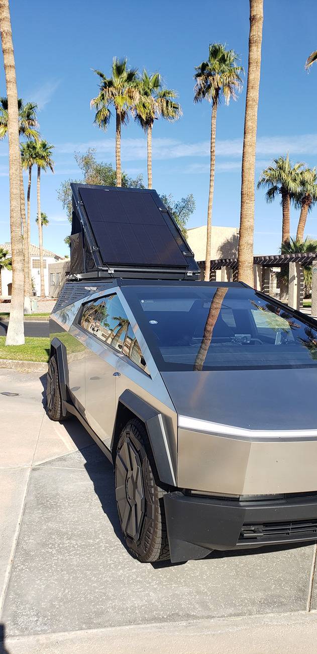

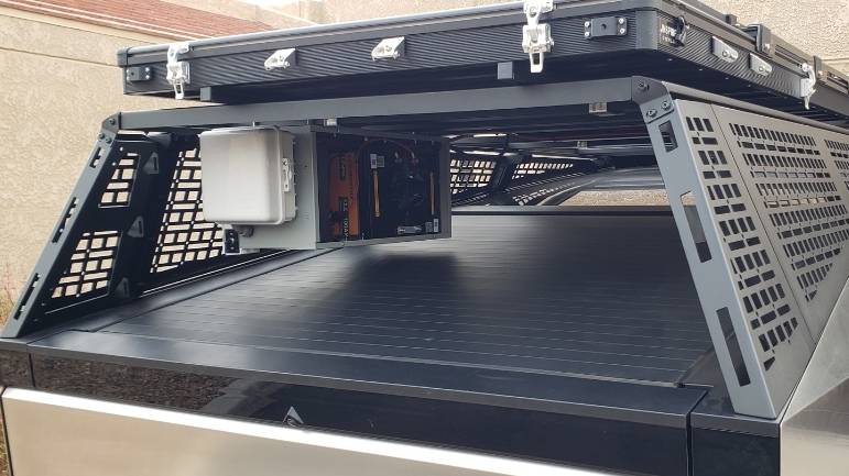

I have done the same. I used a 420W REC solar panel charging a 2580Wh LFP battery with a Renogy 20W Rover charge controller. I charge my CT using a 1000W inverter at 8A. The battery is constantly being charged from the panel as the truck is being charged. Even on a good sunny day, however, the panel tops out at 320 to 340W so eventually charging stops to recharge the solar battery. The issue I've found is that the efficiency charging this way is very inefficient, less than 50%, making the charging process extremely slow. I use my CT's solar generation to supply power for accessories - refrigerator, tent A/C, electric blanket, Starlink, camp lights, etc.
I ran another test charging my CT from the solar power station's 2.5kWh fully charged LFP battery (two EcoWorthy 12.8V 100Ah batteries wired in series). At 64degF ambient, it took 1 hr and 40 min to put 1 kWh of charge into the truck battery consuming 1.58 kWh of energy from the solar battery, reducing its SOC to 34%. That turns out to be an efficiency of 63% charging with the Gen 2 mobile connector at 950W (8A). I'm sure that the loss of efficiency is mainly due to the power conversion losses going from DC to AC and then from AC to DC into the truck. Recovering that energy via solar on a clear day takes 5 to 8 hours depending on whether I'm in camp with the tent open or on the road. My REC 420W Alpha Pure 2 panel was putting out 410W at noon today in full sun with the tent opened up.
Tesla Cybertruck Solar Charging the Truck RTT Deployed
