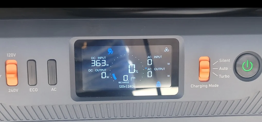

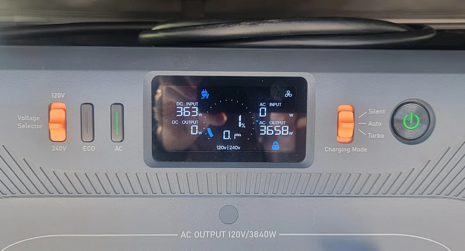

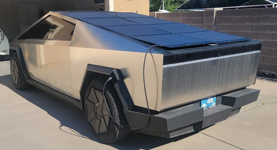

I did some more testing today - particularly wanted to see if the "System Switch Recovery" setting would work as desired. Short Version: It works; but not as desired. Hopefully a future firmware update will enhance it.
Today, I just set up the two panels on the tonneau. In summertime, this could be a pretty good setup for my latitude but this time of year is about 30 deg off so my power is limited to half (was getting 350W from both panels combined). At camp, I would probably set up on the ground with a better angle but this was good enough for my test.
Tesla Cybertruck Solar Trickle Charger Setup (with Black Friday deals) 1764103909855-5s
The Apex 300 worked flawlessly. You can see it charging the truck at a decent rate 10X the solar input:
Tesla Cybertruck Solar Trickle Charger Setup (with Black Friday deals) 1764104012469-85
When it got to zero it shut down but continued to charge the power station battery from solar:
Tesla Cybertruck Solar Trickle Charger Setup (with Black Friday deals) 1764104086196-zh
So far so good. I was curious at what point it would turn back on. 50%? 80%? 90%? Any of those would have been fine. But no, it turned itself back on at 5%. Other than that, it did work. I watched it cycle about three times where it charged to 5% started charging the truck for about 5 minutes and then shut back down. Not optimal for LiFePO4 or any common battery chemistry so for now I will have to throttle the truck charge rate to prevent this. Hopefully, in a future firmware update, it will let us set the SOC at which it turns back on.

How many miles/hr was the truck getting here?
With my two panels 30degs off from the perpendicular, I was getting 350W - which is about 1mph per my driving style. Optimally aligned, that number should double.

That makes sense but, well…not exactly what I meant. If you’re charging at 3.5kw how much are you adding to the truck in miles/hr?
Guess I can just check that with my wall connector by turning down the amperage
Inside the truck it said 8mph on the charge rate if that is what you are asking. I had to dial the current down to 15A to keep it below the 3800W limit of the power station.
