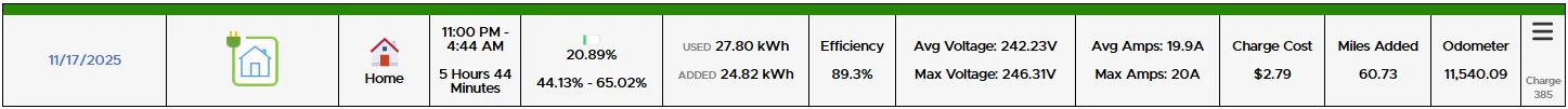

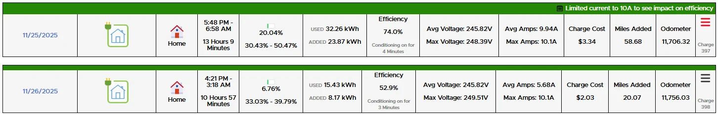

I ran a couple experiments the last two days. Charged overnight at 240V/10A and again at 240V/5A. Compared those to a prior 20A charge. Mongo is (surprise) right - doing the math it comes to about 500-700W power being wasted just to charge. So 1300W in will be only 50% efficient.
Tesla Cybertruck Solar Trickle Charger Setup (with Black Friday deals) 1764240273937-ss
Tesla Cybertruck Solar Trickle Charger Setup (with Black Friday deals) 1764239749696-u
I tried to break down the losses to static and IR but ended up with a resistance of -10 (yeah negative 10) Ohms resistance when I fit the data. So wire loss is insignificant and the increased efficiency at higher current is not just the reduced impact of a static load. It appears the DC converter is tuned for higher current (truck wastes not just less energy for the same charge but less power at 5kW rate than at 1.4kW)
Avg AAvg VAvg PUsed kWhAdded kWhTime%hoursAvg P InAvg P addP wastelinear loss (R=-10)static loss
19.9​
242.2​
4819.8​
27.8​
24.8​
5:44​
89%​
5.7​
4848.8​
4329.1​
519.8​
-199.0​
718.8​
9.9​
245.8​
2443.3​
32.3​
23.9​
13:09​
74%​
13.2​
2453.2​
1815.2​
638.0​
-99.4​
737.4​
5.7​
245.8​
1396.1​
15.4​
8.2​
10:57​
53%​
11.0​
1409.1​
746.1​
663.0​
-56.8​
719.8​

Very nicely laid out. Even slightly more baseline consumption in my case. My math was around 800w. 500w would be better.
I know what you’re saying to be true about efficiency at lower rates from my past experience. The big question in my mind is what I’d get out in terms of mph added from about 2kw which is about what I’ve been able to consistently achieve with the solar panels I carry. Four of these:
