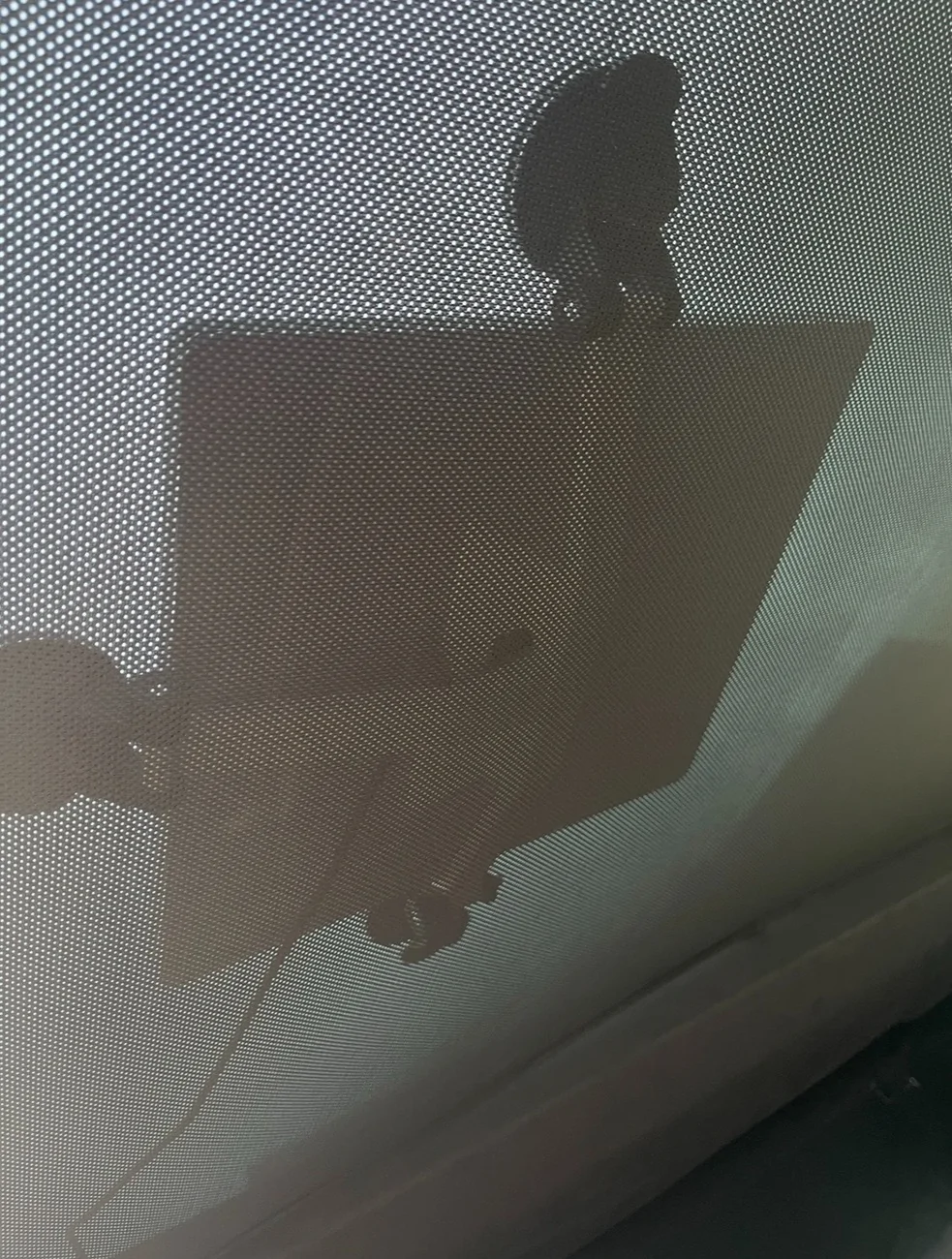

I got my Contronx suction cup Starlink mini mount and put it over the backseat between the glass and shade screen. I'm using the AC outlet in back of console for power. Today, along with FSD 14.1.7, was first test drive. Worked flawless, 150Mbps down while in motion (per passenger monitoring). Excited to have sat comms in the CB, the future is now.

pic 1, I can't seem to attach 2 pics to a post for some reason right now

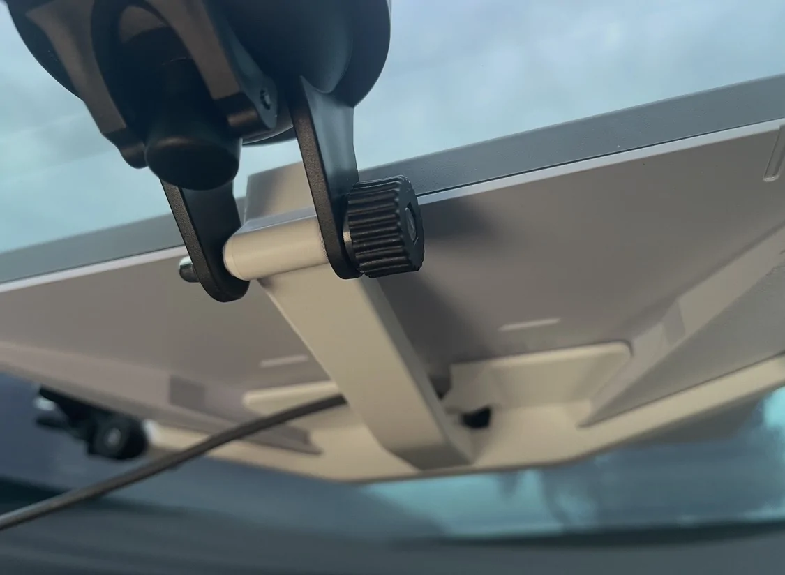

I've been using this for months and it works GREAT! There is a little play between the dish and glass that would rarely but sometimes rattle and I cut and squeezed in a couple of small pieces of foam and that was fixed.
Light weight super easy to install, ran wires down the inside of the B pillar to the rear outlet as noted the OP.
