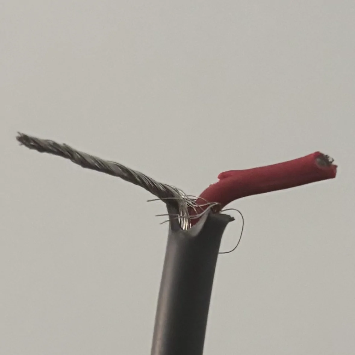

So I’ll ask a (potentially) really stupid question now. I had an extra OEM Starlink power cable so I sliced it open to take a look. Looks like this inside, with a group of wires in a red sleeve and a group of wires with no sleeve.
Could this be spliced into the frunk feed? With the red-sleeved wires spliced to red and the no-sleeved wires spliced to black?
I cannot tell if there are multiple connectors in the red-sleeved wiring. Based on experience I’d bet that there probably are multiple conductors in the red-sleeve. The mesh wiring underneath the very outer sheath is usually for RF-shielding that is connected to ground and in addition to signal sheilding it provides structural strength. It would not be typical to connect this as a return path for a DC voltage. I would look at how many separate conductors there are bundled in the red sheath or elsewhere in the cable. I hope this is helpful.
