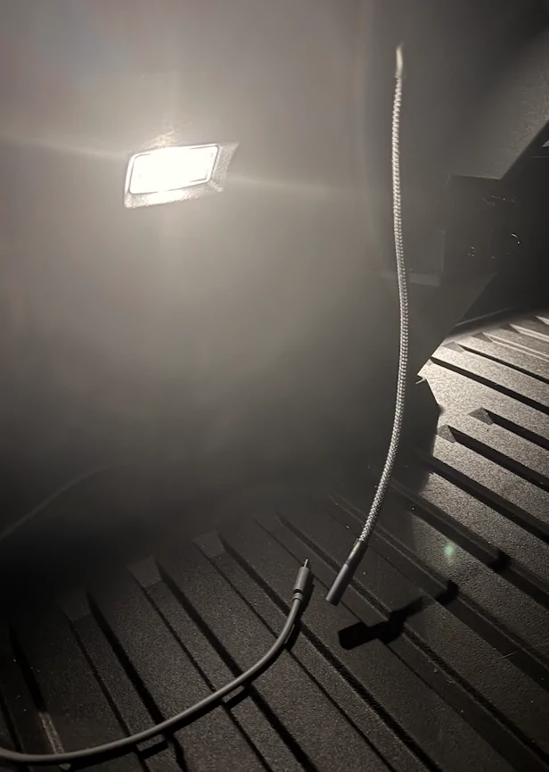

I put an elbow adapter between so its easier to plug.

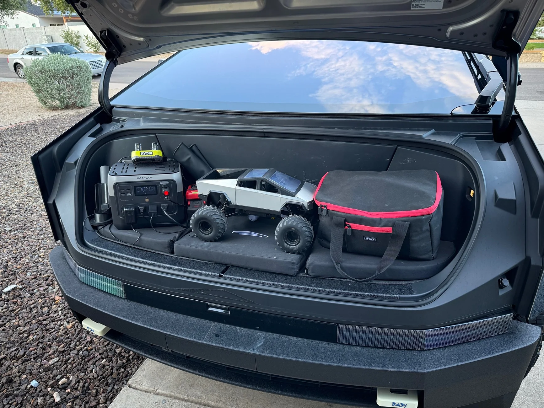

I use an Ecoflow river 2 pro. Need something that has a less than 400w solar input and can accept 48v. There are other options like the Pecron E1000lfp which allows you to limit the solar input to 8amps with manual switch and have much bigger inverters than the river but it fits very nicely in the frunk too. And as an added bonus can accept usb-c charge.
