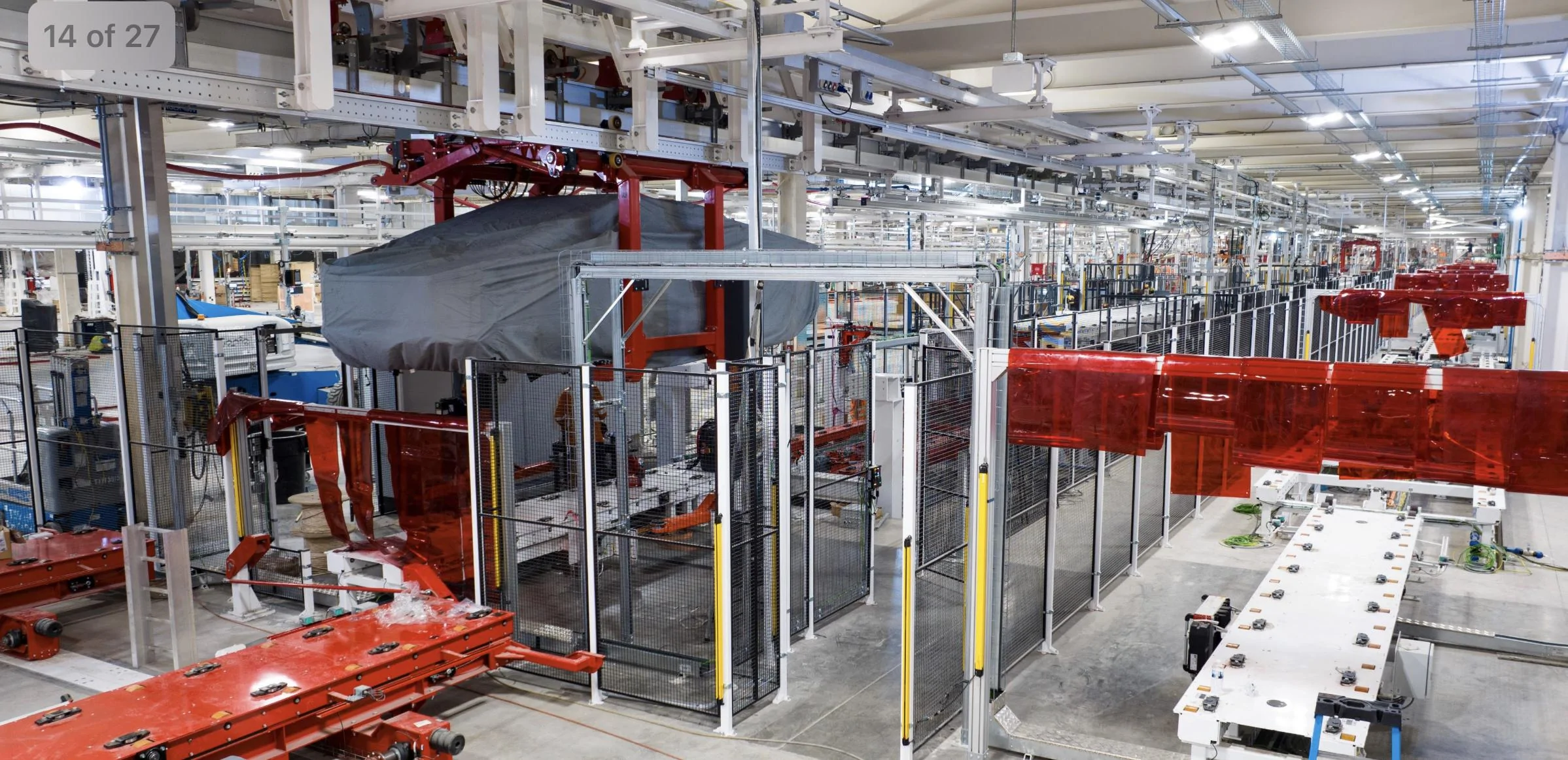

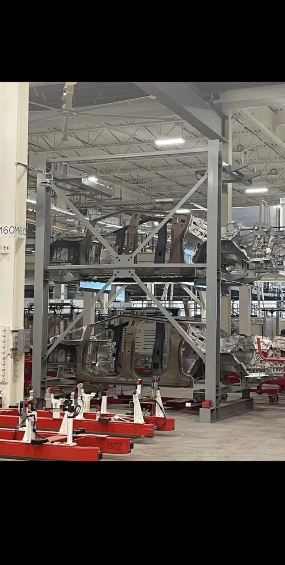

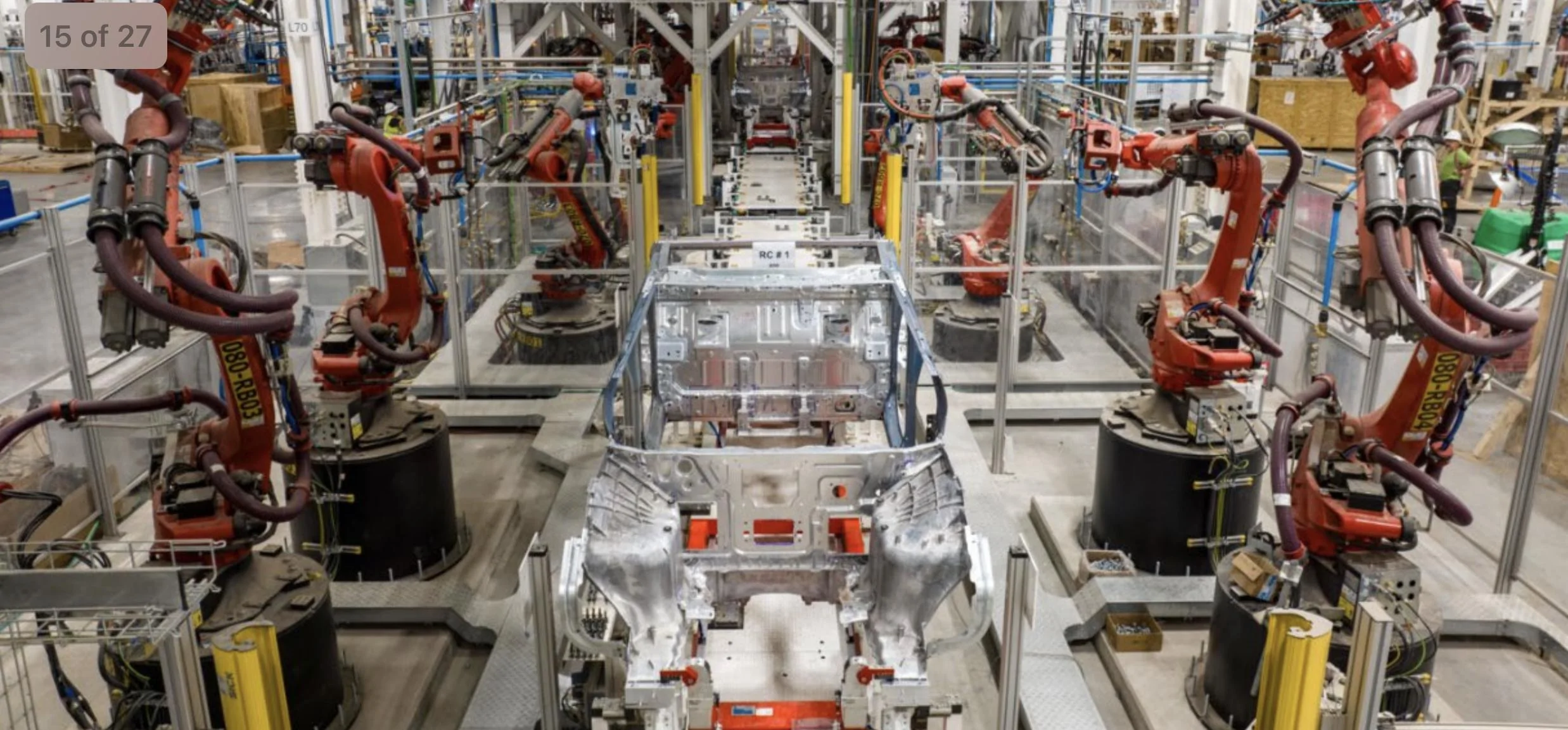

for some visual distinctions here:
here are some sanctioned views of the production line and production line area:
Tesla Cybertruck Tesla is dropping the hammer on employee leakers 3E2E9FFA-5B24-4874-B7C5-030343CF97D6
Tesla Cybertruck Tesla is dropping the hammer on employee leakers C10C7C8D-F6E3-4FF5-A89E-7CE1E15F1DE2

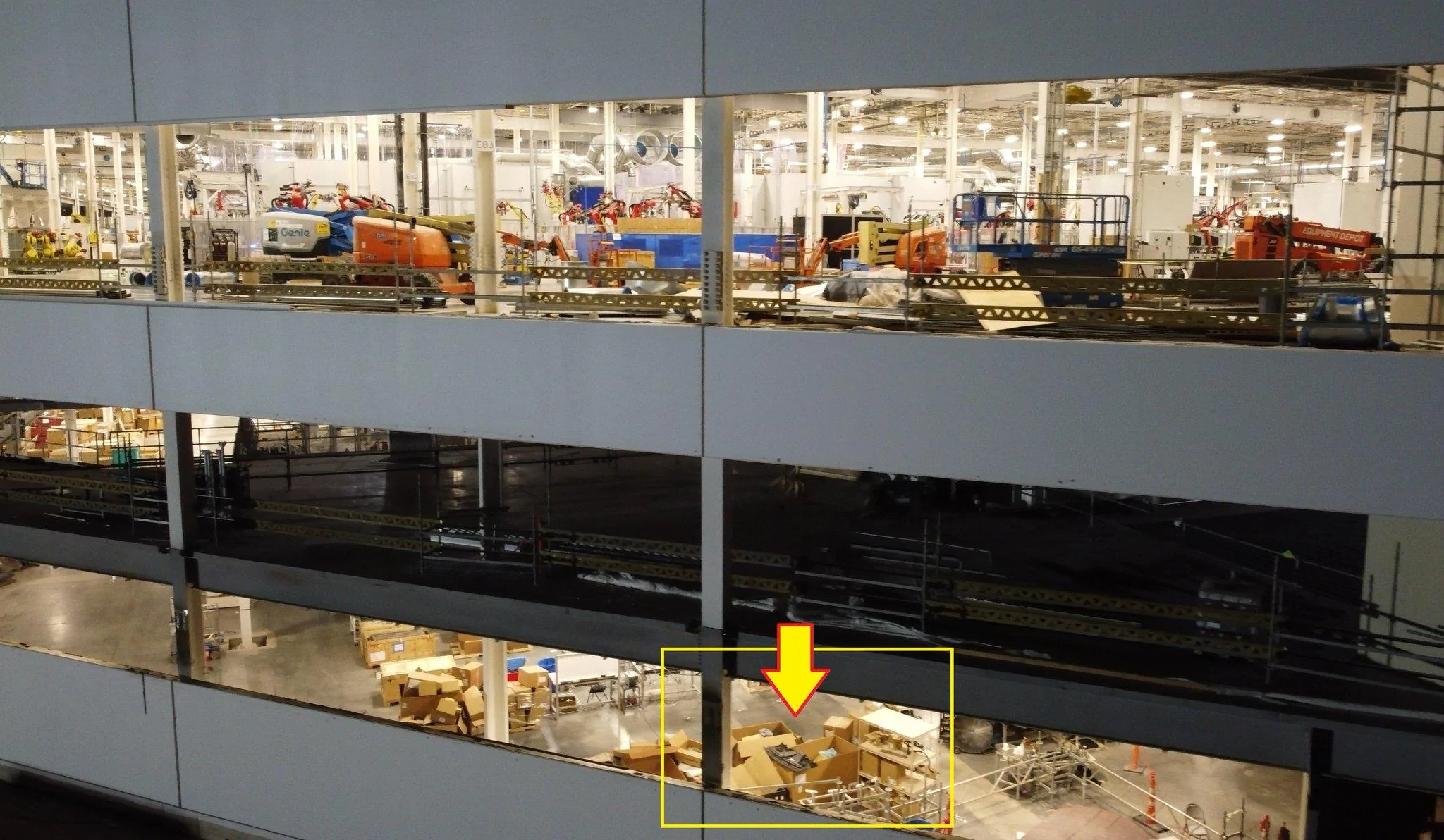

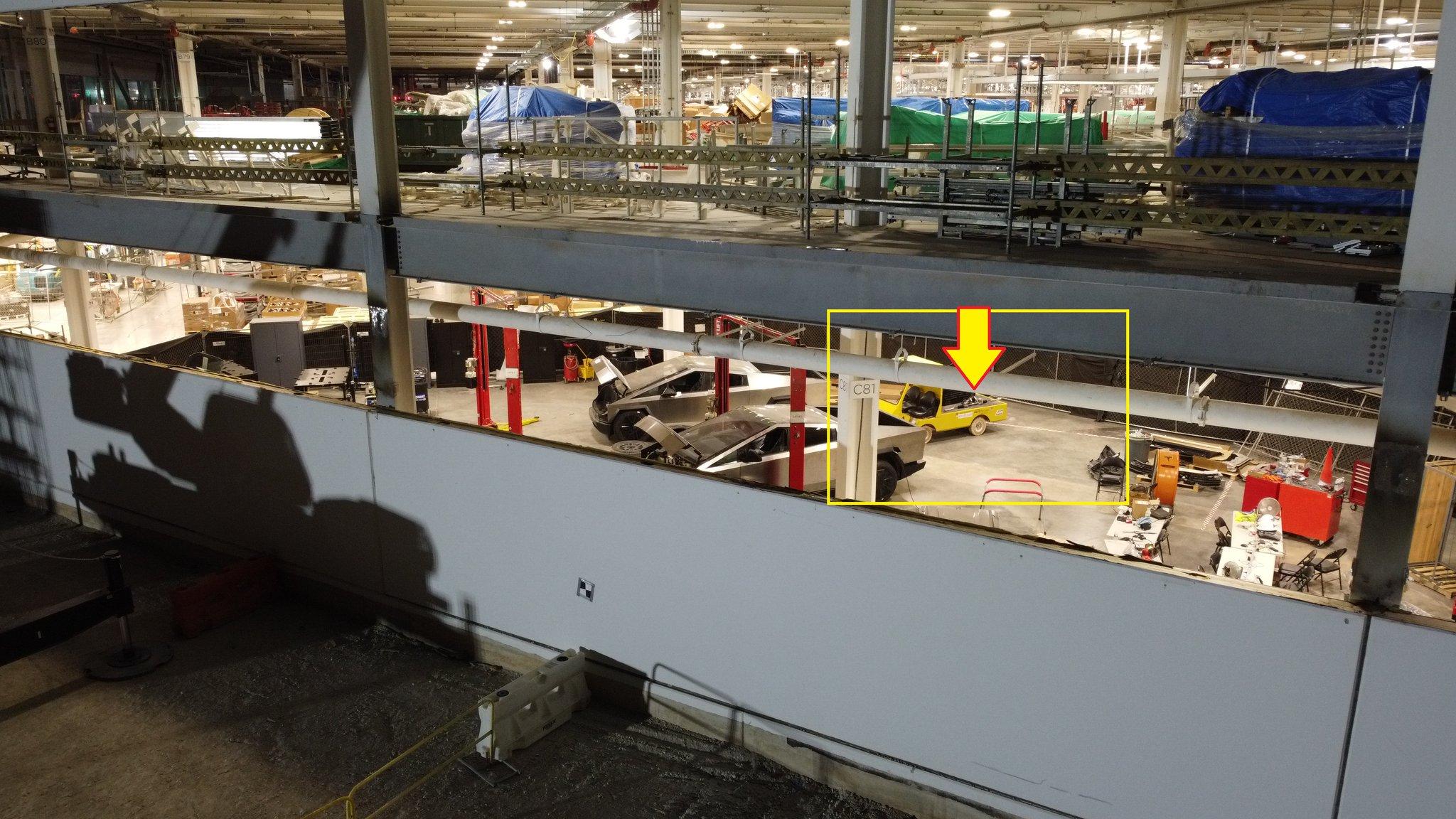

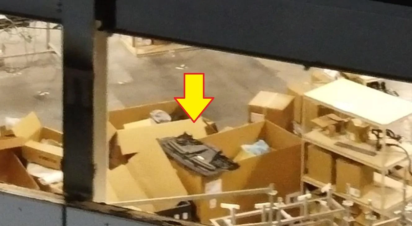

Meanwhile, here’s where we’re seeing units being finished out, and with stacks of parts boxes around, etc. (from Joe vids):
Tesla Cybertruck Tesla is dropping the hammer on employee leakers 40BBBB51-CC5E-4343-80B4-1A7EBC2C21D0
Tesla Cybertruck Tesla is dropping the hammer on employee leakers ADD70A36-2F27-47C5-8276-C1D1C7B1FC90
Tesla Cybertruck Tesla is dropping the hammer on employee leakers 7B93BD15-7663-4CDE-AC00-0D5937954588
meanwhile, leaks like these show the RCs on dollys for manual movement between build stations
Tesla Cybertruck Tesla is dropping the hammer on employee leakers 1692455776714
Tesla Cybertruck Tesla is dropping the hammer on employee leakers 1692455831703
