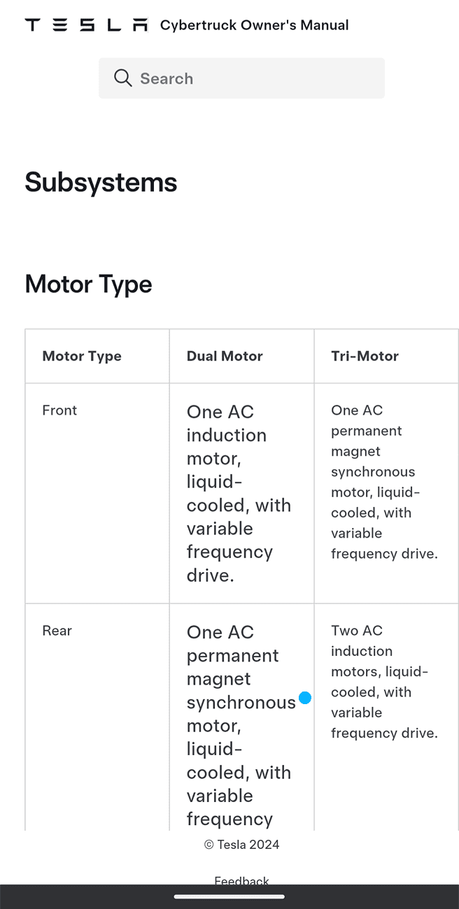

Per below and figuring front motor would most likely be permanent magnet front motor.
we shall see!!
From Wikipedia for motors.
The dual-motor AWD version uses an induction motor on the front axle with a maximum output of 303 hp (226 kW) and a permanent magnet motor on the rear axle with a maximum output of 297 hp (221 kW) for a total power output of 600 hp (450 kW).[75] The tri-motor AWD version—"Cyberbeast"—swaps motor locations (PM to front axle, IM to rear axle) and adds a second induction motor on the rear axle, offering a maximum combined output of 845 hp (630 kW) in Beast Mode,[6] split as 276 hp (206 kW) for the front motor and 284 hp (212 kW) for each rear motor.

I want all three motors to be upgraded! What the logic in just one?
My understanding is that one motor does most of the work most of the time. Permanent magnet motors can be more efficient.

Assuming the AWD Cybertruck manages power between its drive units similarly to the S3XY models, its front drive unit is quiescent during most steady-state and regen situations. So I wouldn't expect a faulty front drive unit would be the cause of the vibration issue some have reported... and, conversely, if a motor replacement was contemplated as a fix for that problem, it would be the rear, not the front.
The alternative being that it is, in fact, when that front drive unit is not delivering power that that motor generates the vibration.
The Beast is different.

The CT has different styles of motors, induction or permanent magnet... Perhaps only one type is the issue.. (and probably just one batch)
