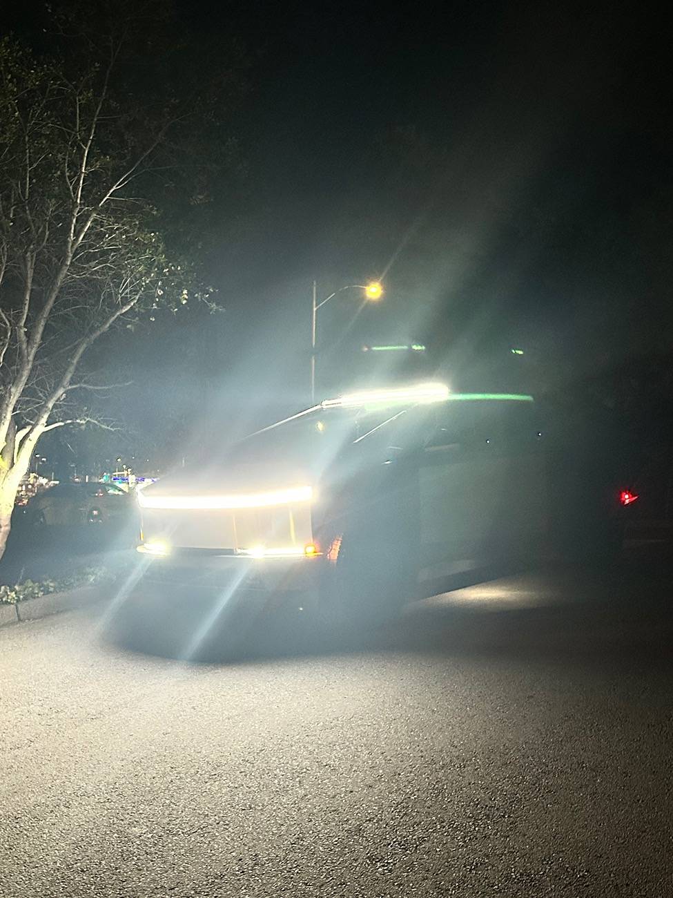

Very excited to have gotten my lightbar installed just a few days ago. Here’s my experience. I tried to make an appointment on the app, it was cancelled and told to wait for an email when available. I instead, went to a service center in person and talked to the service manager who was able to order the bar and complete installation within a week. I had to connect the bar myself ( easy 2 minute job) if you’re used to working on cars and molding. If not, maybe 15 minute then. The following day I drove down to LA freeway speeds. No issues at all, no extra wind noise, no failures. Average speed 70-80 with occasional 90 to pass. Got a chance to turn it on at night. Photos don’t do it justice but it pretty awesome. Controlled from either plugs and accessories or lights tab. You can assist the output same as bed lights. You can choose between ditch, food, or both.
