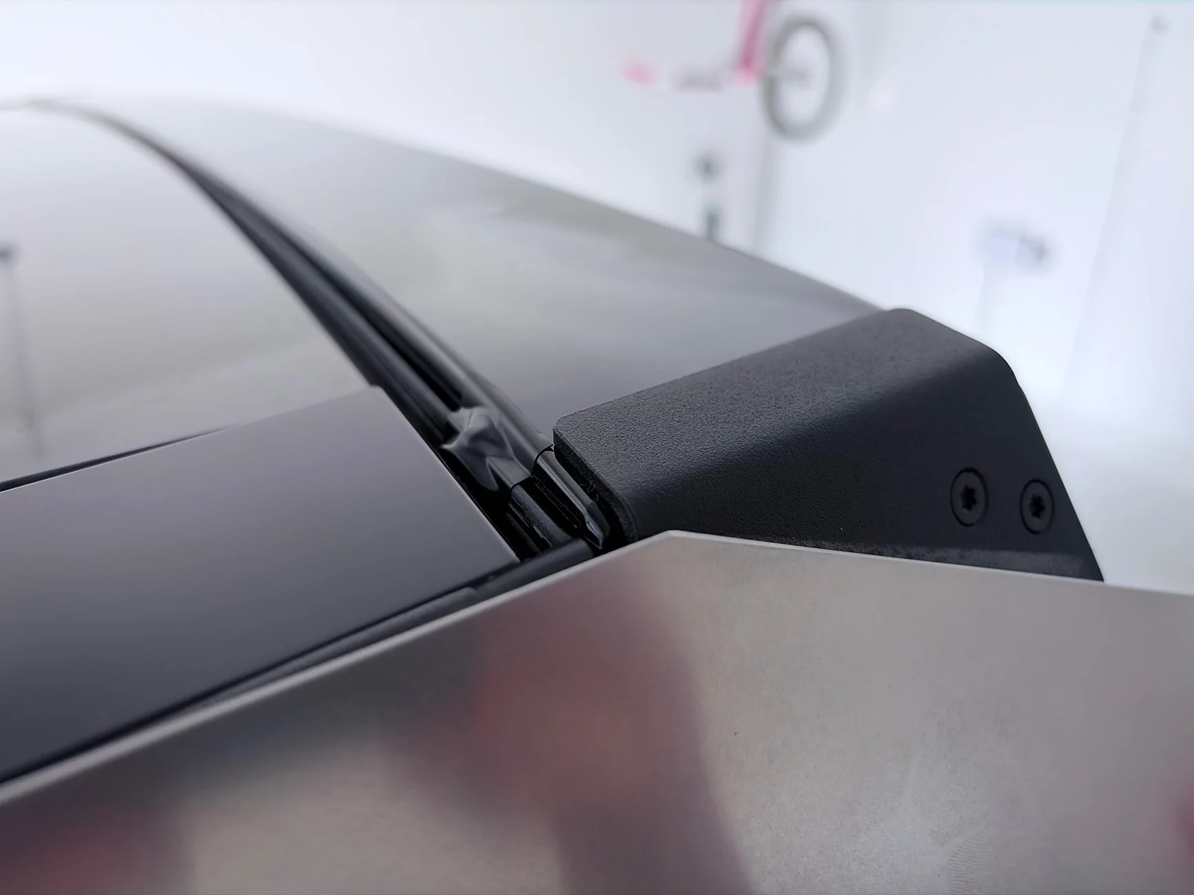

Got it installed, FINALLY!
Service sold me the mounting parts ($200) and charged m3 ($250) to drill the holes and install the two Rivnuts. Then I mounted it all and success! Overall, all in, $1600, which isn’t bad considered a replacement and install from the Service I’ve seen quoted to $2500.

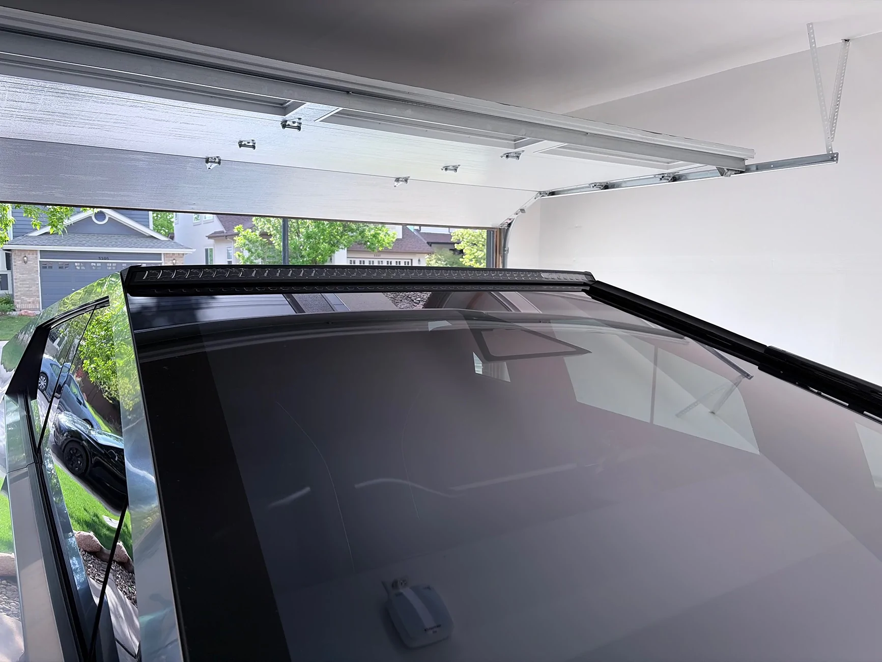

I’m loving mine so much, it looks so damn good, I’ve been just sitting in my garage turning it on and off cause I haven’t driven at night yet lol
Pics or didn’t happen 😊
I can’t wait
