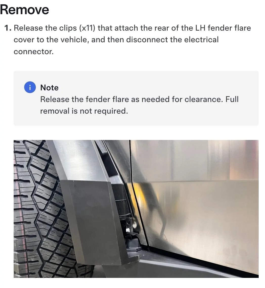

They really aren't hard to remove/ install (cordless driver is very handy though).

the rear are a pain. there are screws securing them and access is behind wheel well covers. Had to remove the entire well cover to access the screw. What a pain in the A..
