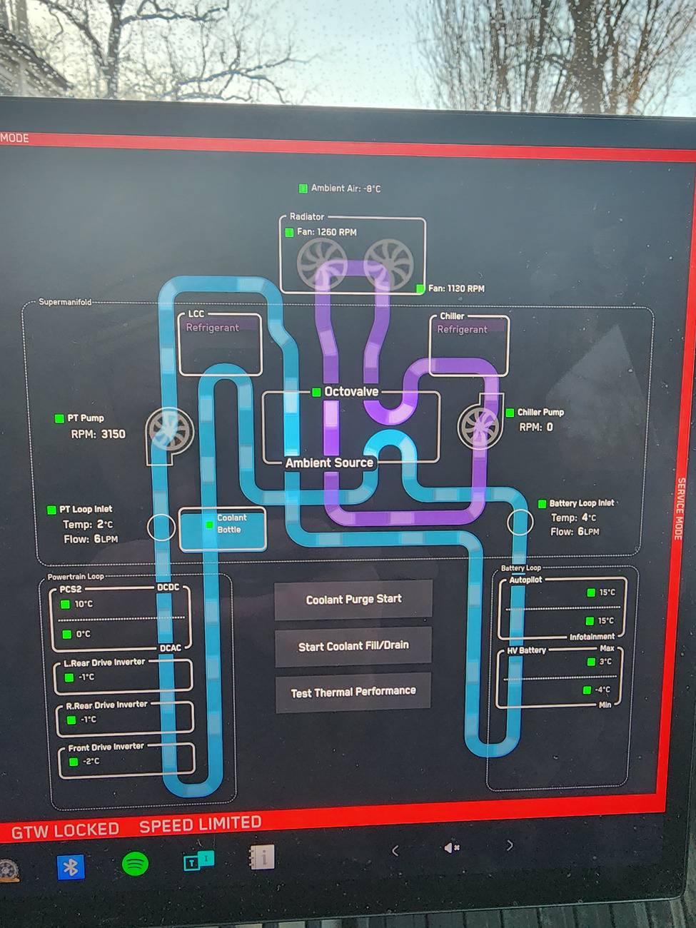

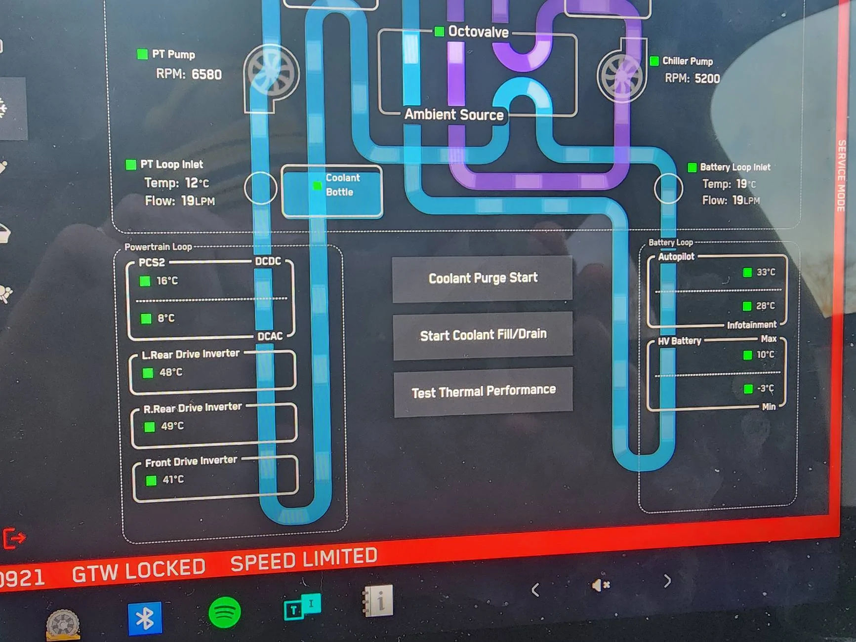

You might be too remote for this to work, but if the pack is too cold and you have available SOC, setting destination to a Supercharger while unplugged will engage preconditioning which uses upwards of 16kW (Beast) to heat the pack (22kW with cabin heat cranked up). You don't need to be moving for this to work.
That will get the pack to a chargeable temperature much faster.

The drive units can be used as resistive heaters and have higher power output (I think original PTC was 6kW). Plus the heat pump has a COP > 1.0 most of the time.
Tesla Cybertruck That was close! 😅 -32F battery 🪫 low 20250105_084854
After 8 minutes of preconditioning, around 8kW of heat transfer.
