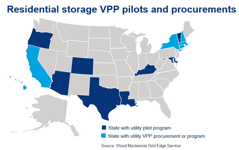

The answer to the clickbait title is no. ( Any title that asks a question, the answer can be no. ) But that's not the reason I get so triggered at this foolishness.
I had to stop after 21 minutes. So painful. Then I powered through rest just to make sure they didn't have something I missed. Even at 2x, a waste of 16 minutes.
I get that they are fanboys and that it is YouTube and that part of their thing is the fun, the pump, the geek out, but I don't have enough time to go through all the inaccuracies. They speak like a green version of certain radio and TV hosts, asking presumptuous rhetorical questions and presuming an ignorant audience.
In general, they are in the ballpark. In reality, time and bureaucracy is the issue.
For starters, here's where this kind of VPP is even possible
Tesla Cybertruck The Cyber Truck may pay for itself. 1631121663328
Second, CAISO, the California market "caretaker", can get 4000MW of flex power. That flex power is not cheap. It is not clear if the CA VPP will hope to compete on the open spot market and/or part of the emergency event program (US1$/kWh). Tesla has approximate 350MW of PowerWall batteries installed in California, assuming 100% VPP Beta program signup. The participants would have to be in PGE, SDGE & SCE territory (as opposed to a municipal district like SMUD). Current net metering already exists and the ROI is/was near retail prices - more like 25 cents / kWh. The real question, still unanswered, is if the VPP as power provider can sell at spot market prices and then compensate PowerWall providers at a non-net-metered rate.
Third, the one that I am most curious about it, is arbitrage. Power companies do not appreciate it when you buy cheap power from them in the middle of the night and then sell it back to them during the peak, so much so that it was written into the bureaucracy as not allowable. Again, this is a moving target as the rules have softened somewhat. Does this circumvent that whole thing? I doubt the utilities would appreciate their customers topping up at night, then playing the shell game of unloading it to Tesla to have Tesla sell it back to the utilities.
But, that just might be the case because of the Duck Curve . Long story short, the increased solar production (good thing) does actually cause a problem (Duck Curve, bad thing) for the grid,and one of the tools to solve it is battery storage.
Back to the real issue, time. Tesla actually offered this peak shaving 10+ years ago. The regulatory environment is supportive. In the future and far future, peak shaving will occur more and more from scaling storage just not now. Now is a beta, now is a test run. When CAISO needs power in the next 5 minutes, 15 minutes and 24 hour period, they aren't even thinking about Tesla let alone calling them. This is the very beginning and the future is a long ways away, more akin to autopilot early days.

Your most informative post makes it clear that there are many regulatory hurdles to be cleared. Investor owned utilities won't be in a big hurry to get on board and will only do so when legislation forces them to.
