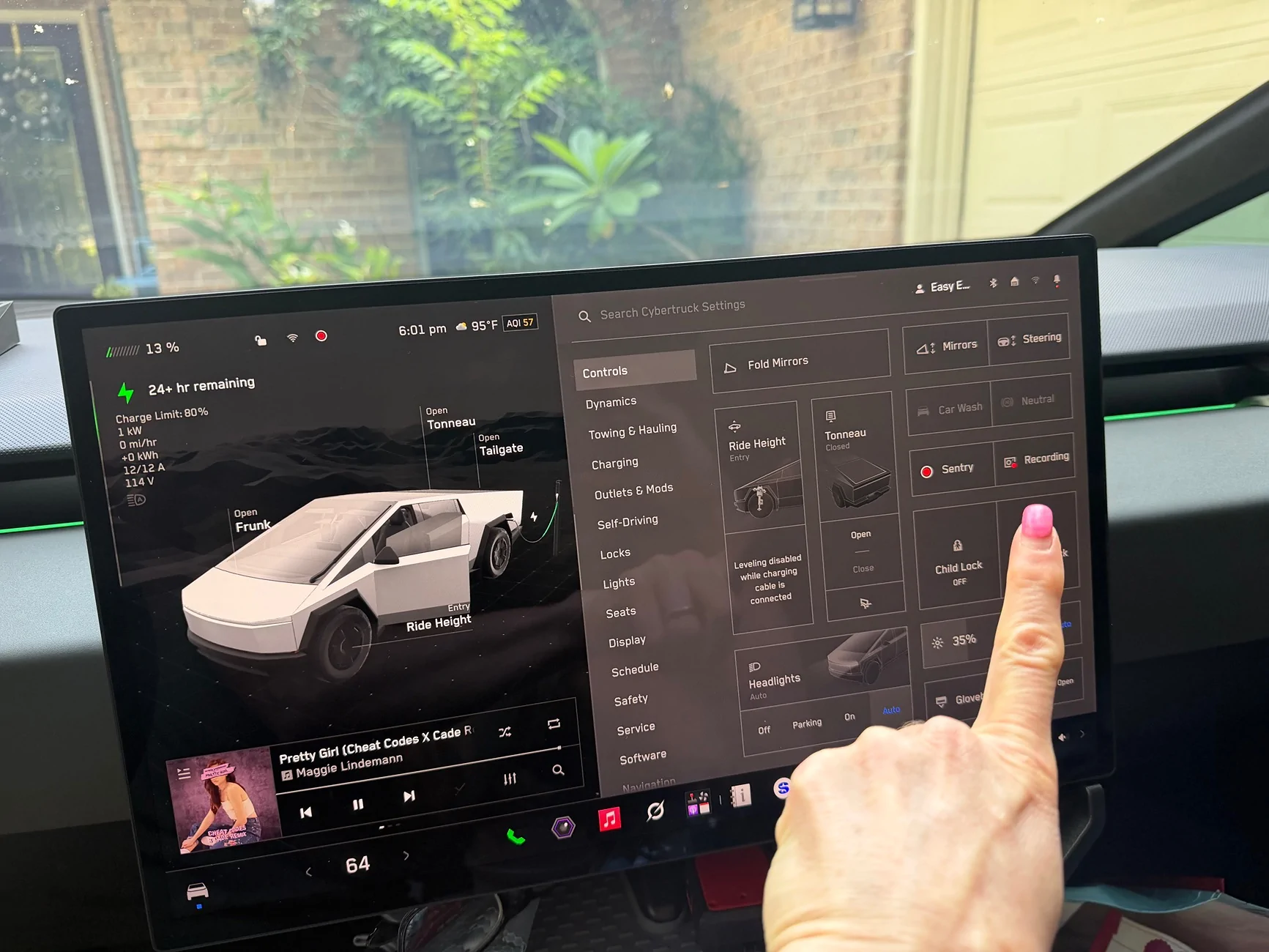

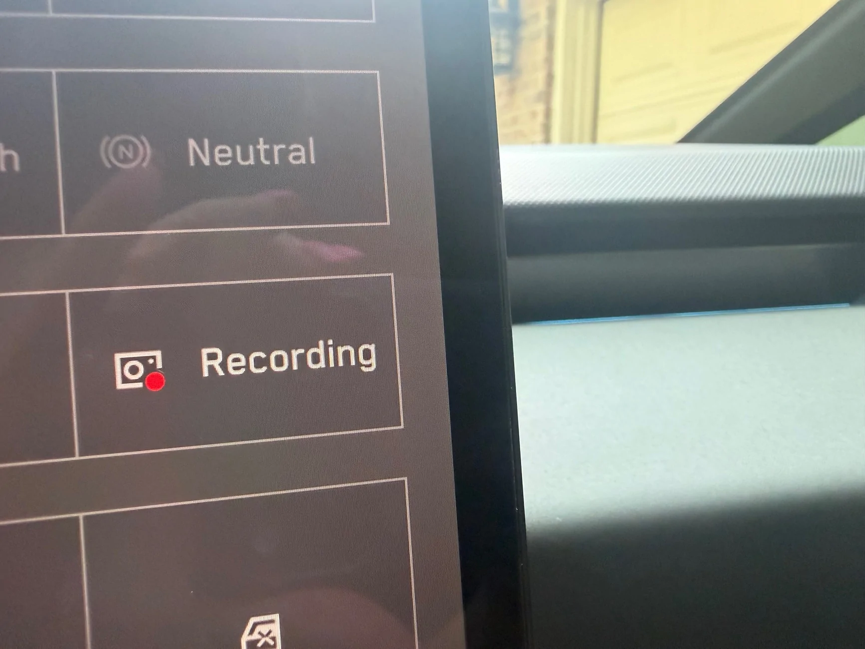

Please make sure you know how to use your security cameras and safety features on your Tesla or Cyber Truck, BEFORE YOU NEED IT!!!
Controls->Recording (camera icon button)
Immediately after incident, put vehicle in park, hit controls, to the right of the control tab highlighted in gray and to the right of sentry-hit the recording button. You will see the down arrow and downloading appear briefly. Then it will save the 10 minutes prior to the moment you hit that button. Safely remove usb thumb drive. Plug into your pc. Boom! You have access to the last 10 min. Good luck. Be safe!

You can customize the app tray, place the record button (camera icon) there and all you have to do it tap that button vs digging through the menu. Much faster if you’re bleeding out etc.

You can also hit the voice button on the steering wheel and say “save dash cam” or hit the horn and it will do the same - assuming you have that set under control to save dash cam when horn is used. But last 30 seconds only.
