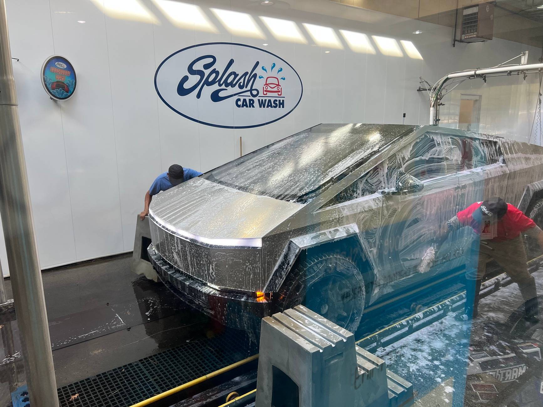

I prefer number 1 below, but have tried several things:
1) Griots Garage Ultimate Car Wash, in a bucket, with the Griots extendo-pole with their micro-fiber wash mitt on. Works so well!
2) Use ONR Rinse Free Wash on a microfiber mitt, dry with microfiber cloth
3) Use sprayway with a microfiber towel to dry clean - works great, no worry about micro scratches - can't do this on paint or wrap, so a huge win
4) Use rubbing alcohol in a spray bottle - works really well
5) Take to the hand wash near us - they do a great job and whatever chemicals are in their soap leave it spotless, shiny and clean
6) Had some dark spots - used my Griots Garage orbital buffer with Bar Keepers Friend, then rinsed - it's simply an amazing result. brings the stainless up to a really nice shine. Some will say this is a bad idea, but I can't see why as the result is terrific and not hard at all. Rinse well when done.
7) I do have some of the Citrisurf product Tesla recommends, waiting to give that a shot.
Tesla Cybertruck Tips on how to wash and maintain the Cybertruck? IMG_9389

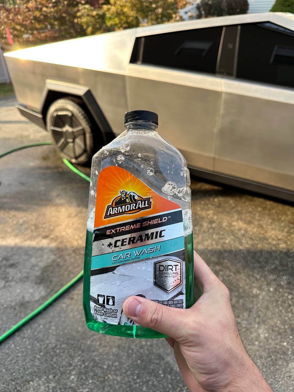

Tesla Cybertruck Tips on how to wash and maintain the Cybertruck? IMG_3555
Wanted to share… this wash was awesome. Repels water and dust. Gets rid of finger prints and everything!
