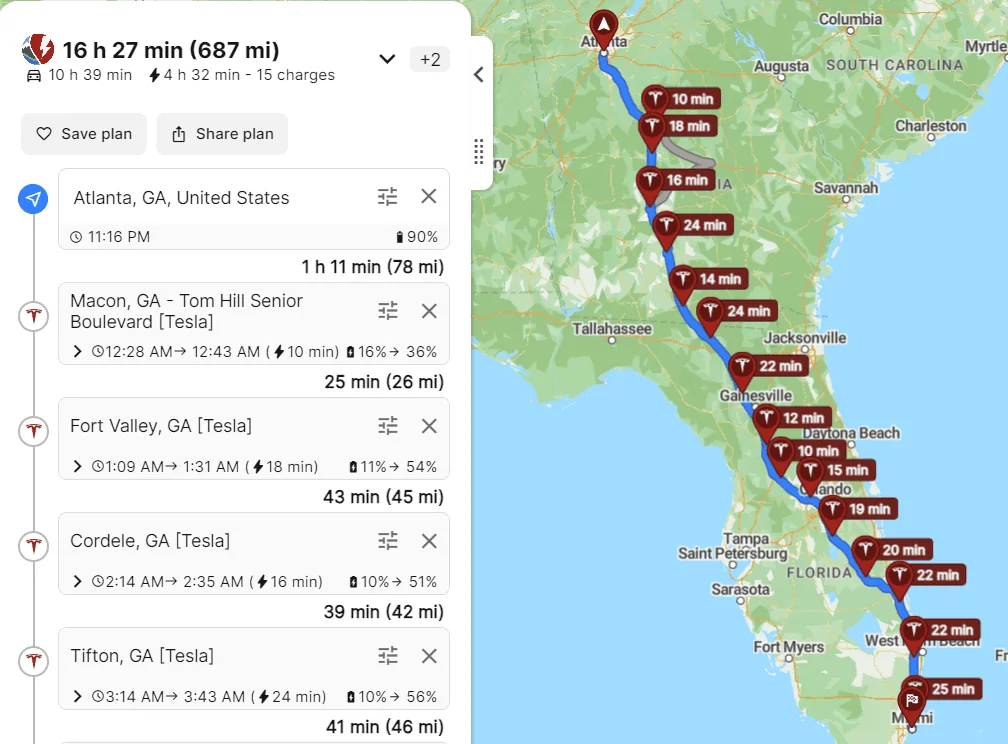

I have no idea why people even thing about publishing charging to 100% numbers. Even worse someone charging at a Supercharger to 100%
So this means that I'd have no problems towing that load from Atlanta to Miami.
Think it is fairly typical to do range and performance tests starting at 100% and getting as close to zero as possible to get a better average, but in the real world people usually don't charge to 100 or take their battery to 0.
Yea should be good to go getting from ATL to Miami might have to charge a little longer if you are hauling something bigger or heavier but LOTS of SC on that route.
Tesla Cybertruck Towing tested with 6,000lb Tesla and trailer load zimage7148
Actually most charging tests are done from 20-80%, not 0-100%.
I told you that I'd be able to do that, because I HAVE ACTUALLY DONE IT towing a boat and getting even less range.
I didn't have to go anywhere and guess. And that's why I keep telling you that since you are in Florida, running out of power is pretty hard to do.
