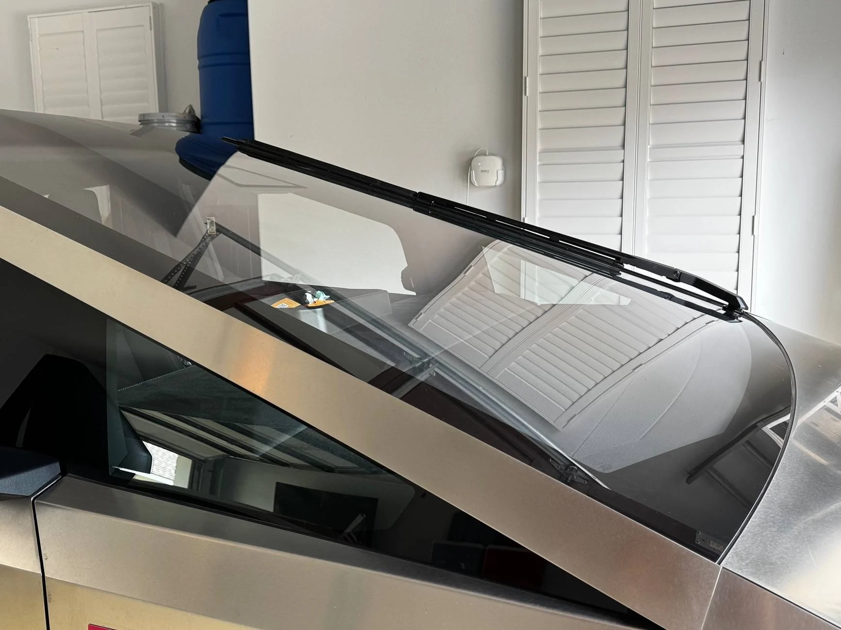

I, like many others here, have an EERO 6e network.
I repositioned one node to the garage next to my CT. Didn’t make a difference.
Tesla Cybertruck Truck won’t stay connected to WiFi IMG_0650
I tried something while I was screwing around; I turned OFF WiFi diagnostics in the truck.
The next morning, the truck had the latest software downloaded and waiting for installation.
WiFi now seems to be on each morning whenI get in the truck at home. It wasn’t before, and I had to soft reboot the truck to even show my network. It still wouldn’t connect even then.
I’m not sure if turning diagnostics off made the difference, but it seems to be working now. YMMV.
