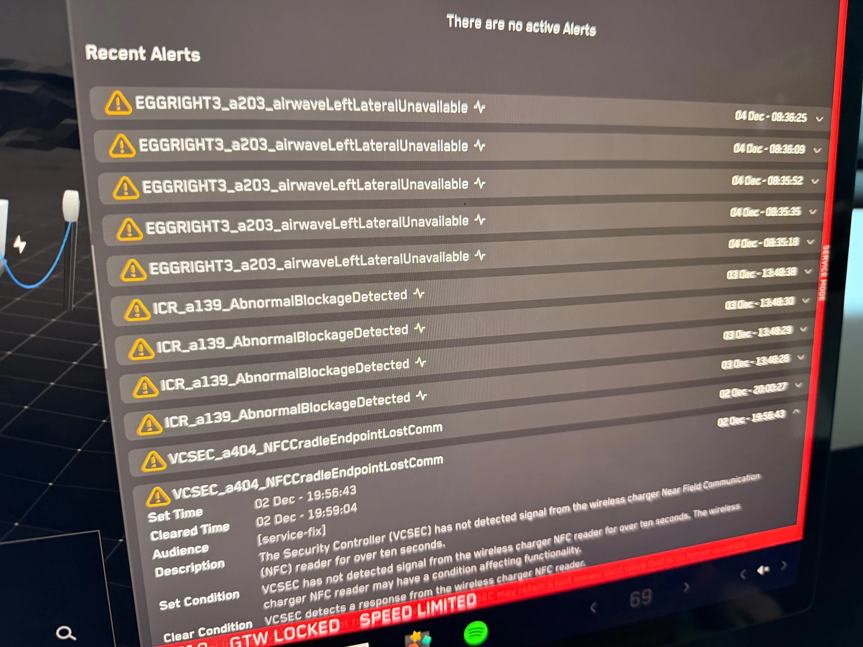

syburtruck
Matt
Jan 19, 2025
50
Cybertruck FS Cyberbeast
If the display drops down to show a lower max charge rate after it starts to try and charge it's on you more than likely have a PCS unit going bad. A quick trip to service mode for alerts would confirm this.
My foundation cyberbeast just had this issue. It's a good 5-7 hour repair.

Shows 48A max. Guessing it’s not my UWC.
No alerts.

I see some other items; but not charging related unless I’m too ignorant. Looks like unrelated HVAC.
