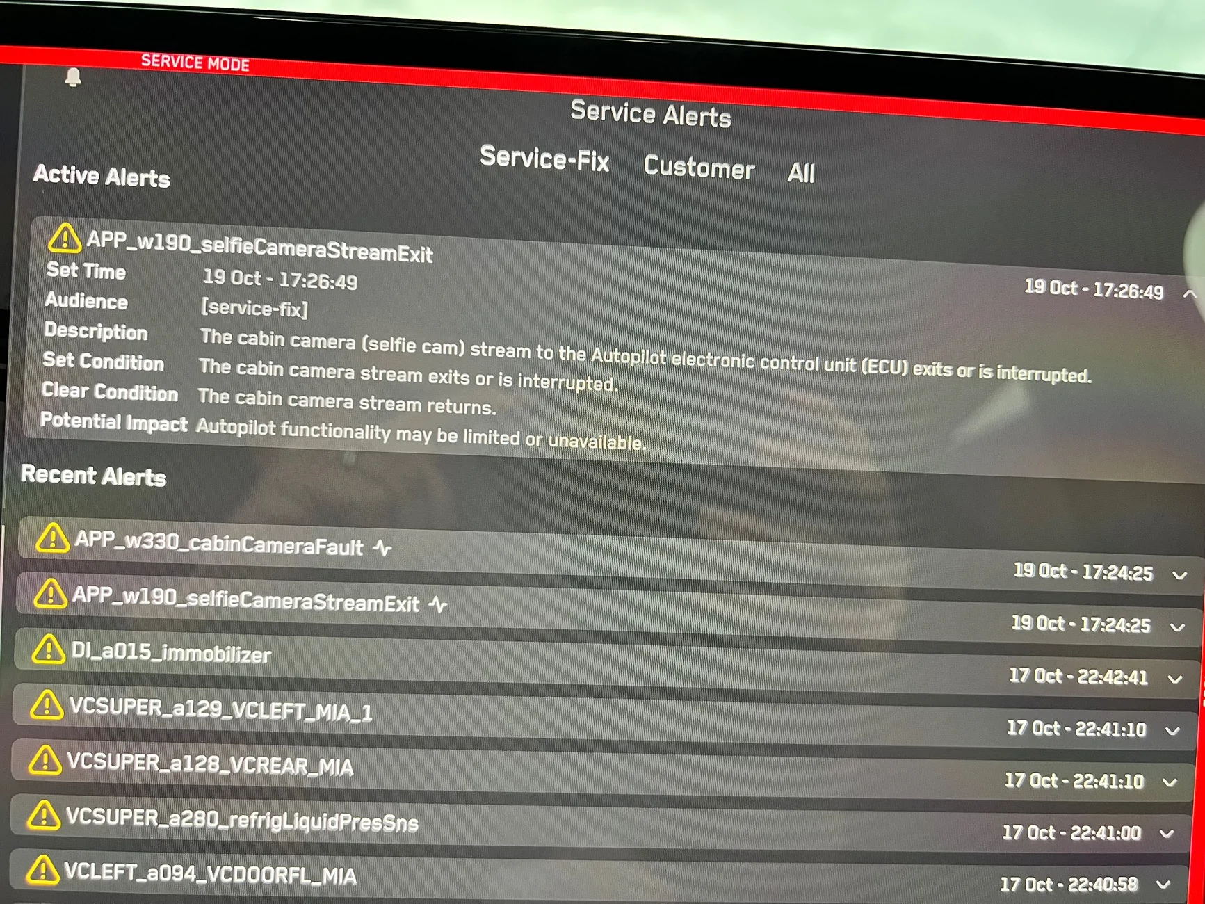

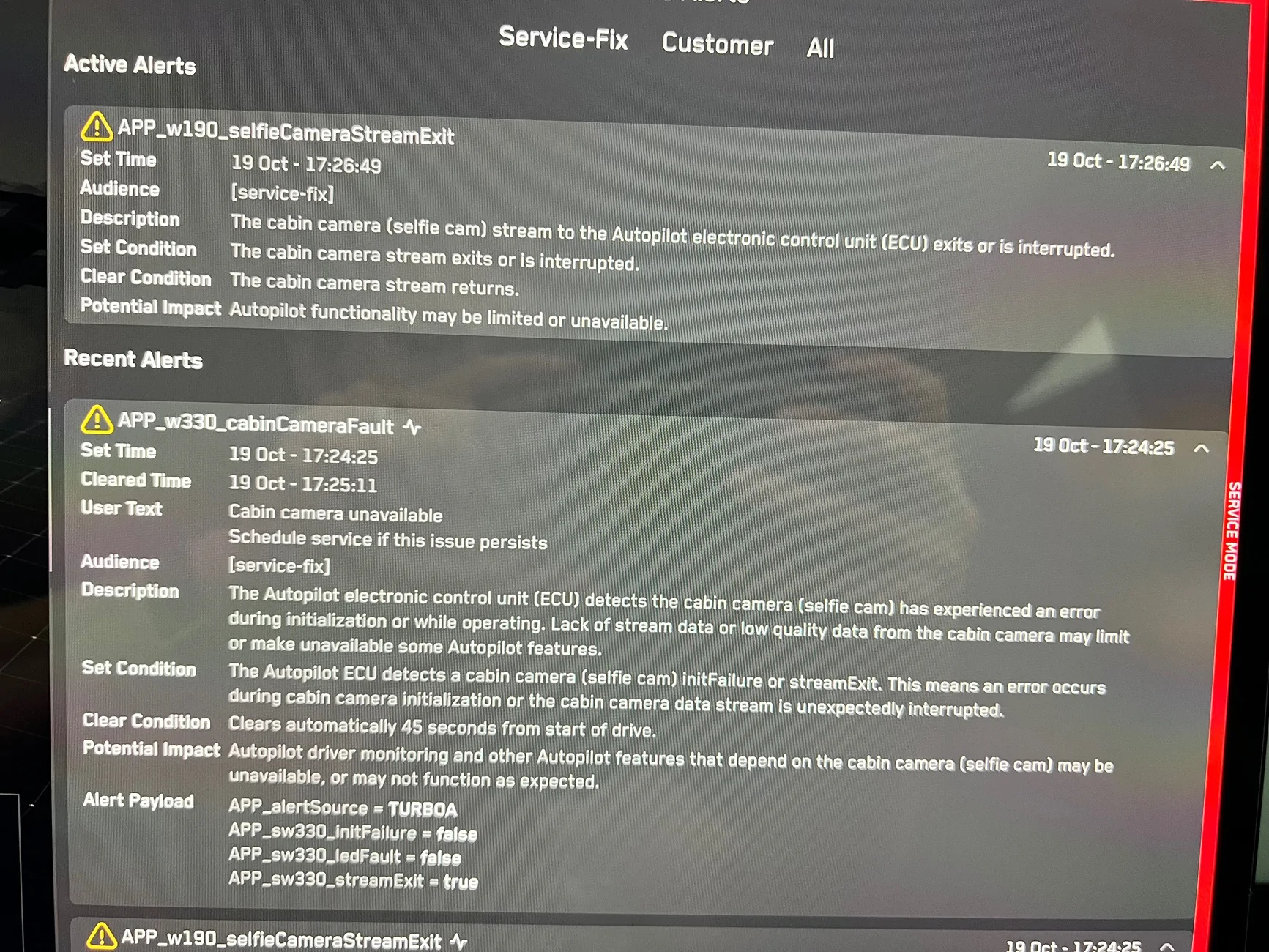

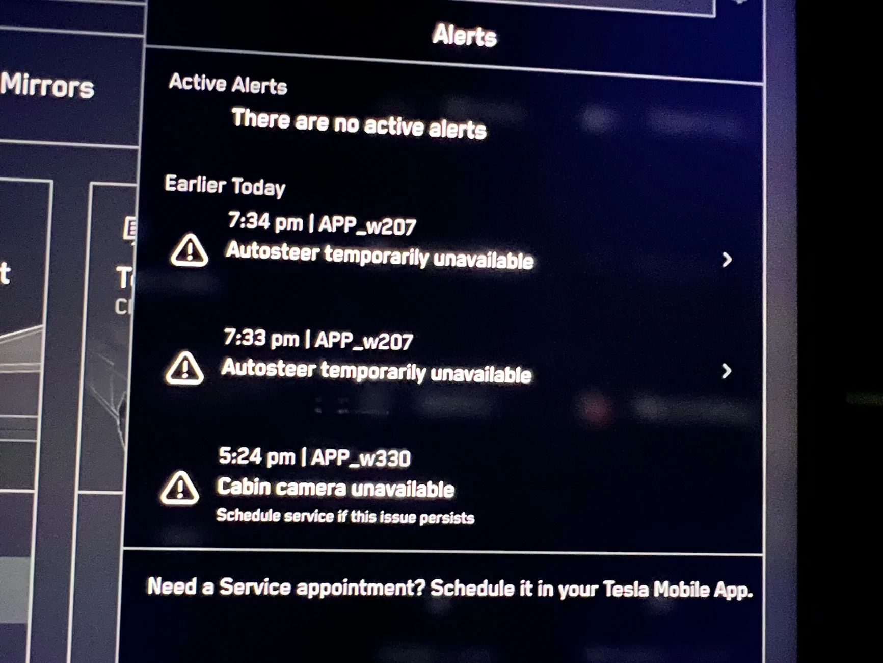

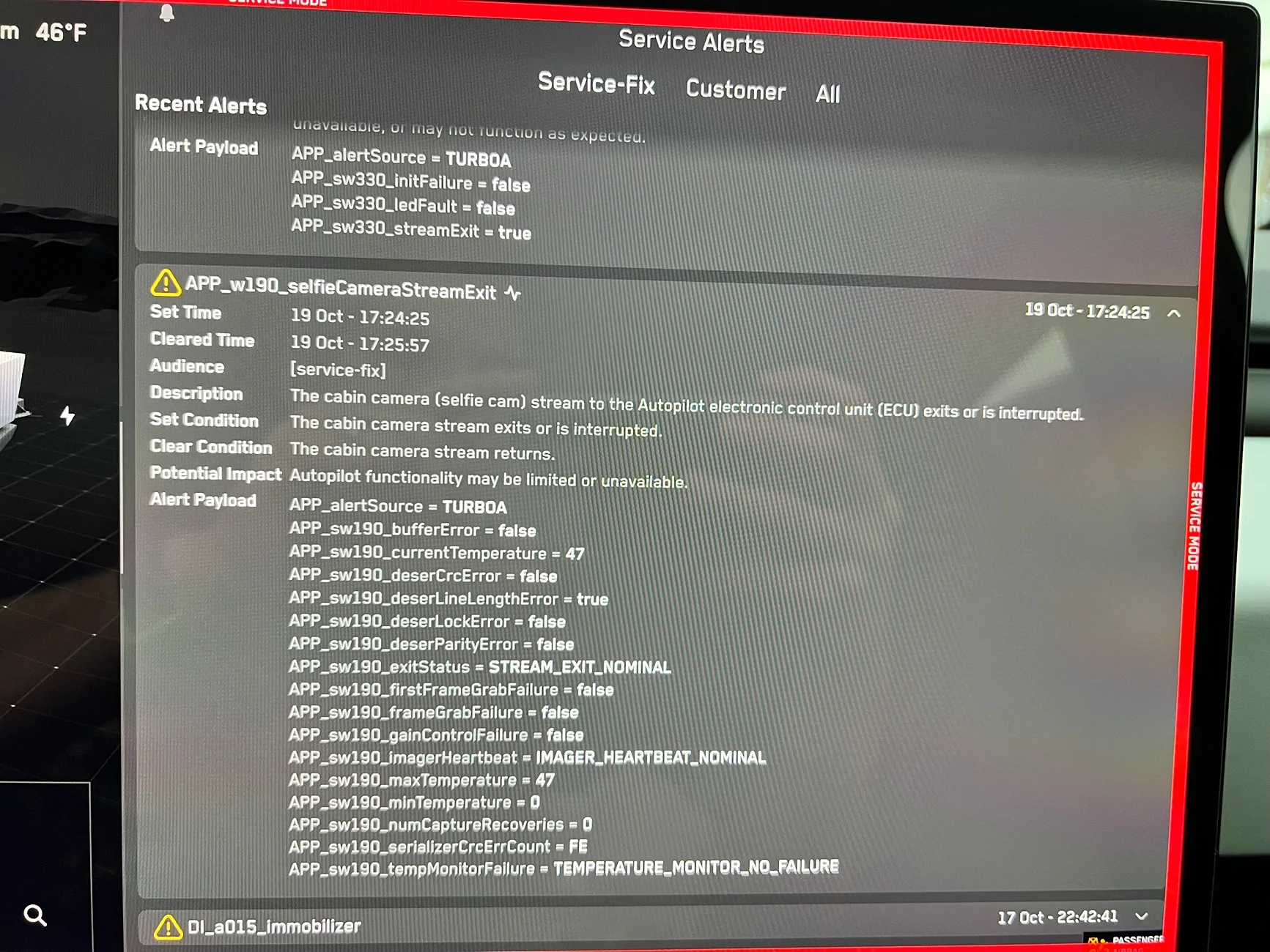

Not sure if it is related to getting this update the other day or not, but my cabin camera stopped working last night and the service menu had a bunch of errors all starting around the time I installed the update. I had to make a 45 minute drive without FSD last night 🫨 (I’m spoiled lol)
But this morning everything was working again. Anybody else have issues?
That’s why I didn’t installed 2025.38 …. waiting for a next upgrade..
