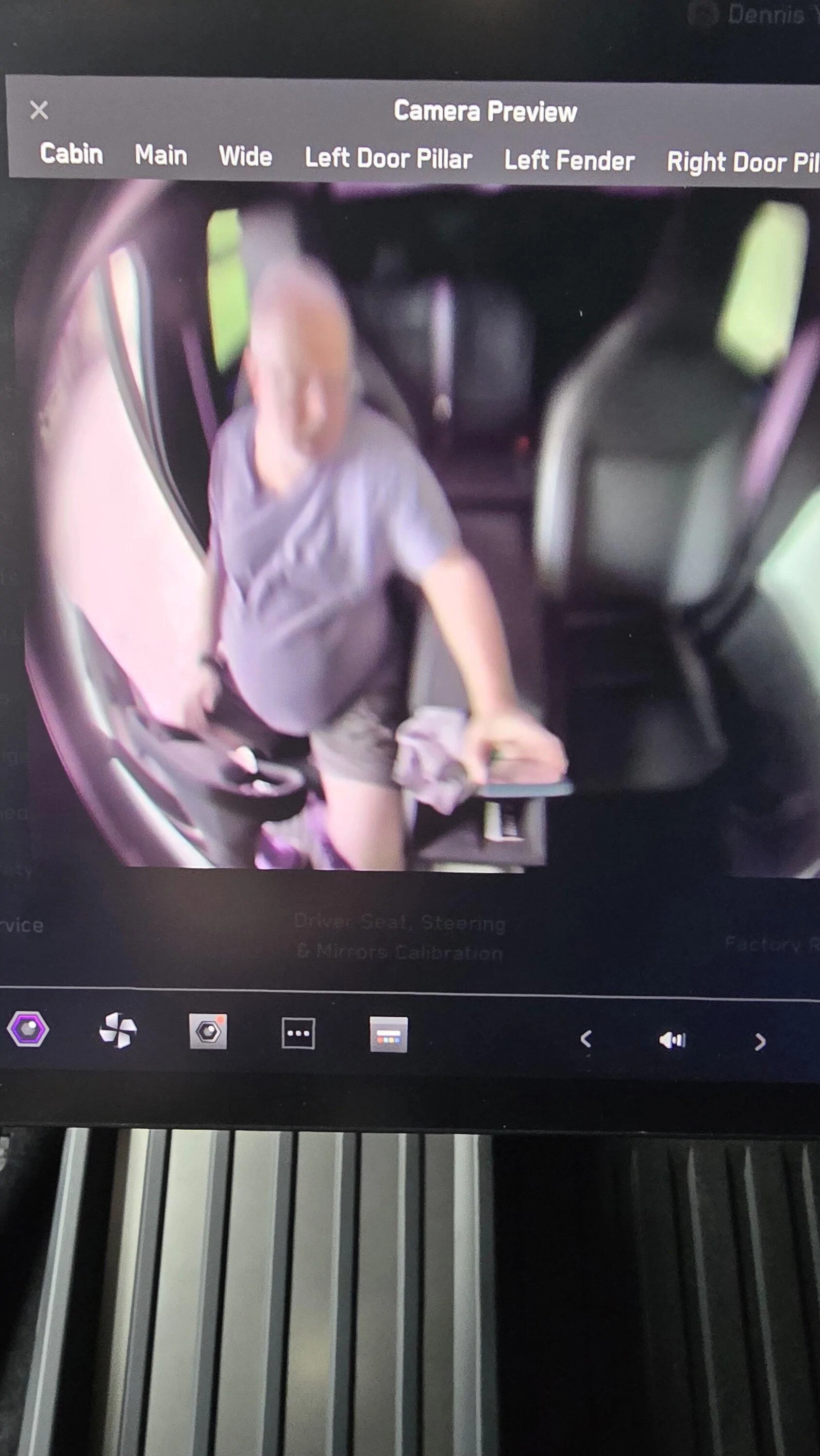

My Cabin Camera is blurry. I know in the past it was not blurry like it is now. Anyone else seen this issue and know how to fix it by DIY? I cleared/ran the Camera Calibrations and that did not fix it. Looks like a focus issue.
I have a service appointment scheduled for Tesla to fix it but that is not until Oct 21st. I'm sure this being blurry will affect FSD if and when it comes to the CT. I've searched around the web and have not found a fix.
I've also made sure the cabin camera lens is clean and nothing is stuck to it.

This looks like a lens misalignment. The camera is unable to focus because it is too far/close to the lens cover. I haven't seen that in a Tesla yet, but it'll probably require physically adjusting it. Since it's new, don't try it yourself and set up a service visit. Should be an easy fix, at least!

This is the cabin camera pointing into the cabin at the driver/passenger seats. I've have already tried cleaning the camera lens.

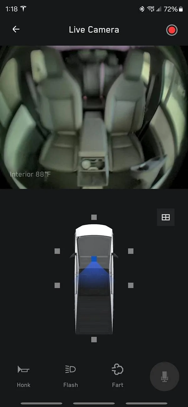

I just checked and mine is still blurry. I wonder if starting a FSD drive will clear it up? I tried doing the camera calibration reset a month ago but that did not help.
Can you think of anything you did besides a new update that cleared you cabin camera up?
Tesla Cybertruck Update-Fixed: Blurry Cabin Camera in my CT AWD, anyone else have this issue and know how to fix? Screenshot_20241003_131800_Tesla

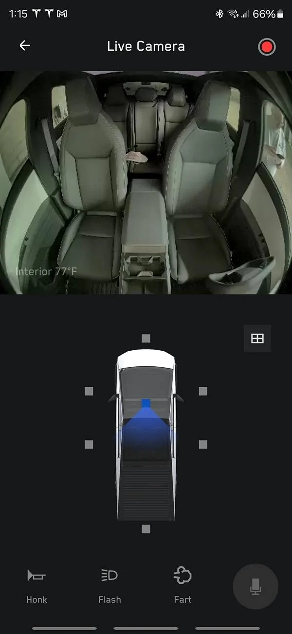

I finally got my CT cabin camera replaced today by mobile service. Took them 15 minutes to fix it. They also fixed my wiper blade park position (after they replaced wiper motor in Sept) from being parked too far to the right (common issue when wiper motor is replaced).
Before:
After:
Tesla Cybertruck Update-Fixed: Blurry Cabin Camera in my CT AWD, anyone else have this issue and know how to fix? Screenshot_20241216_131551_Tesla
