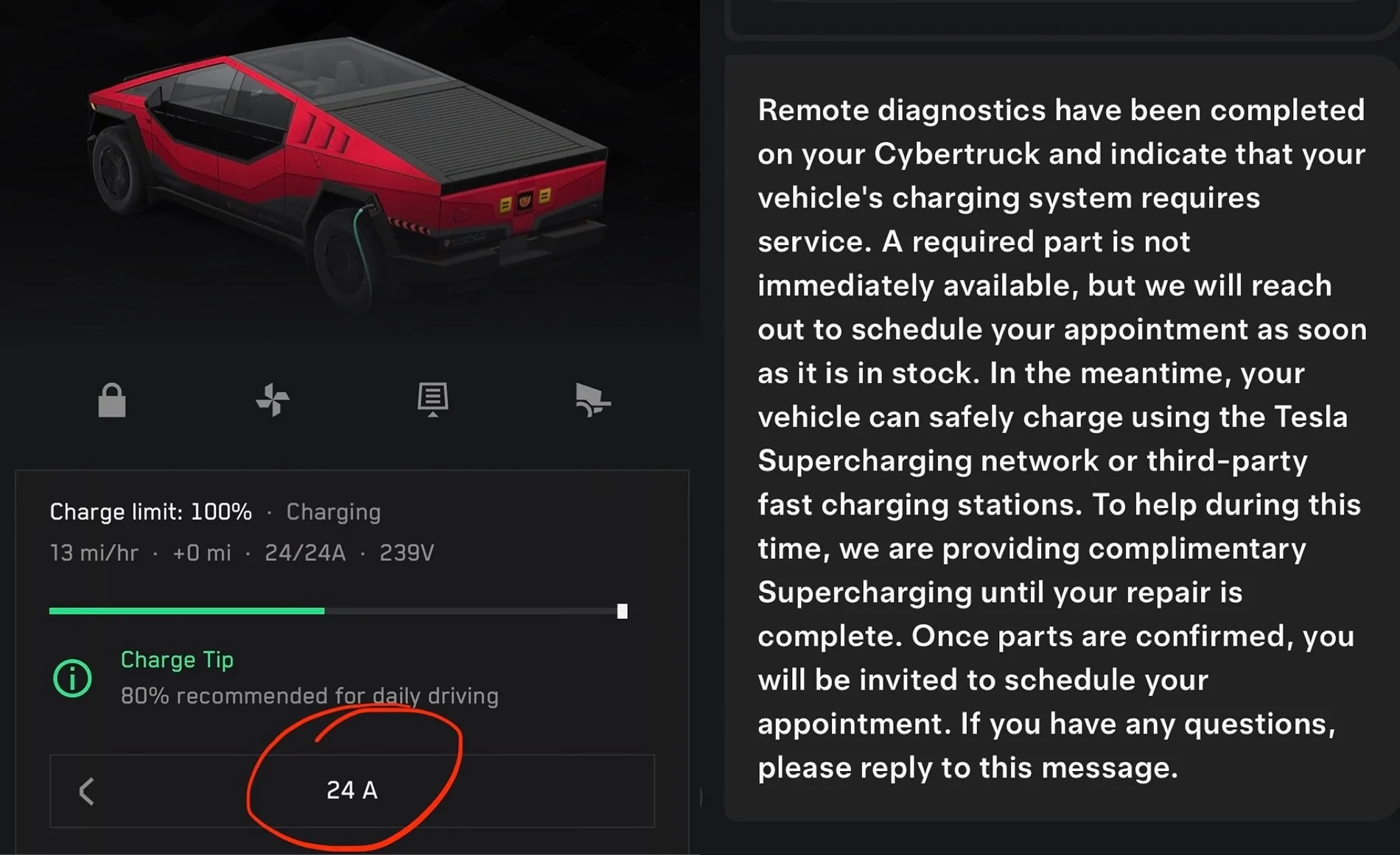

Well, it’s my turn now. Plugged in last night and would only charge at 24 amps. Made an appointment and got confirmation within ten minutes.
How long is it taking to get parts and once they take my truck, how long is it taking for them to fix?
This is VERY inconvenient as I will have to drive one county over to charge now. I wouldn’t even own an EV all these years if I couldn’t charge at home.
And of course Tesla putting a service center near me has been cancelled three times.
The fix should be less than a day. Book time is 4.2 hours.
