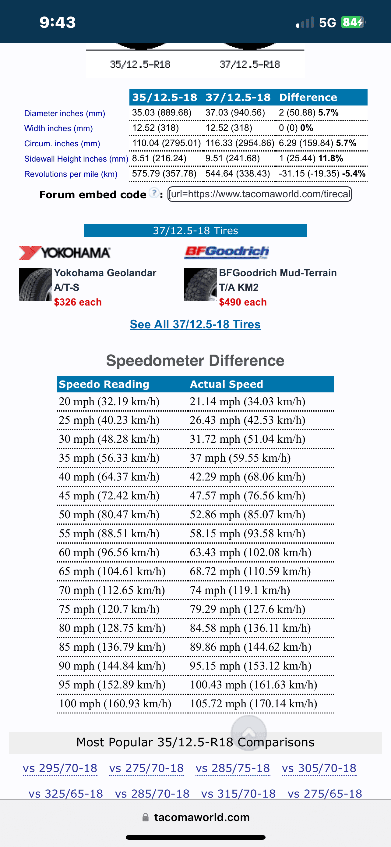

Once you verify the correct speed with radar you’ll know what those specific tires and pressure read out as. Just mentally add that to your indicated speed.

I know I’ll lose significant range with bigger AT tires, probably KO2’s. I’m assuming it comes with a 34-35”, I’d like 37’s.
so we’ll see how it does with range.

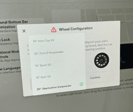

On our Model 3's, driving a few blocks after I swtch from summer to winter tires, of exactly the same size wheels and tires, a dialog box pops up asking me to confirm the new tires. The system is incredible in its ability to sense a new set of tires, even when they are almost identical in size.
It's not only the tire size that the car takes into account, its also whether they are summer or winter tires! I think this is why the traction control is so precise and fast-acting when driving on icy roads, the system is just very sensitive, in a good way.
Come to think of it, I think it must be detecting the new tire pressure sensors!

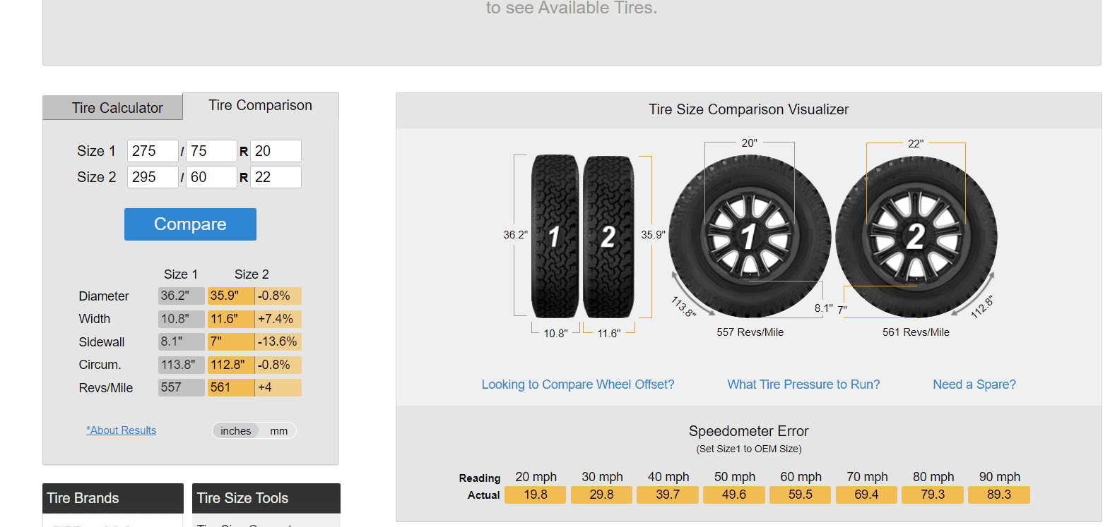

I imagine it will be similar to the current tire size selection available in the cars
Those different wheel size configurations don't change the outer tire diameter or circumference. The various wheel and tire sizes are all designed to have the same outer diameter so that the revolutions to speedometer conversion will always be consistent.
The purpose of the wheel configuration menu in the Tesla U/I is to allow the car to more accurately predict range based on different wheel types mounted on the car. Even though the outer diameter of the tires are the same, other factors such as aerodynamic drag and wheel weight will make the range slightly different. The wheel configuration in the U/I is designed to help calculate a more accurate estimate of remaining range.
However I do think it would be a cool feature if Tesla could somehow use GPS over a certain distance in combination with the number of wheel revolutions it takes to go said distance for a speed calibration function that would work with varying sizes of wheels and tires. Only problem with that is some would abuse such flexibility so Tesla would have to specify tire size limitations. Some would put tires on so large that unexpected torque loads could risk harming the drive unit, or there would be no doubt be some people going the other extreme and putting tiny wheels and tires to make the vehicle very low, which also risks damage to the battery and decreases driver visibility.
So if such a feature were ever activated there would have to be reasonable tire size limitations but some would most likely still abuse them anyway. But if Tesla took this a step further and made the final drive unit gear ration slightly variable adjusted with software, then the drive units would have no problem and speed calibration could be compensated for in that way. But that adds cost and complexity for all VINs to allow for use cases that really aren't in high demand by everybody.
