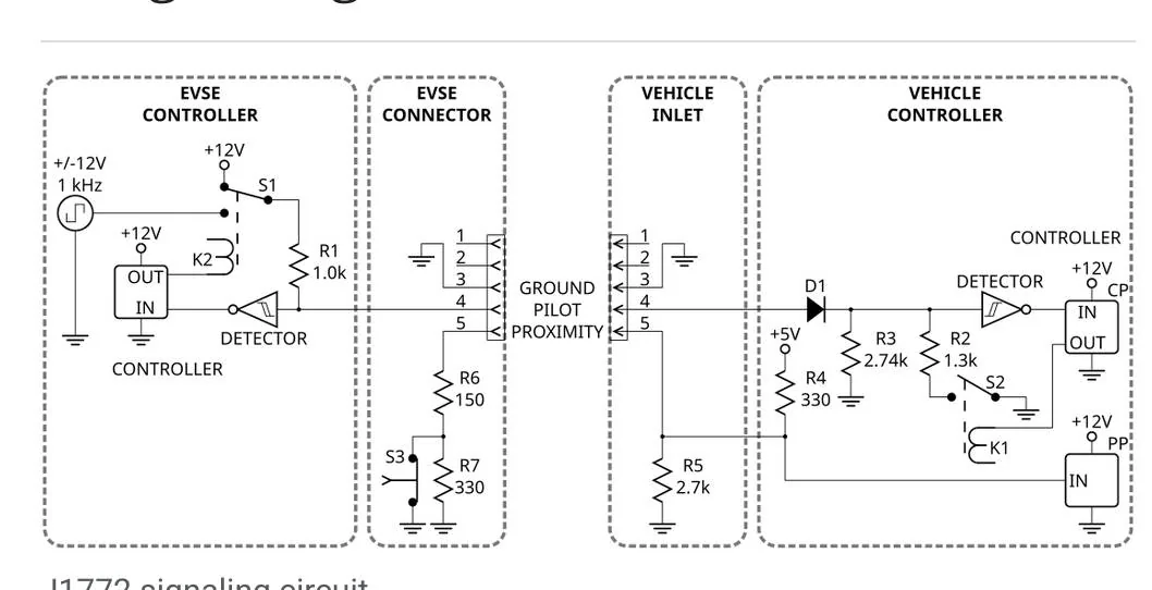

I am wondering if it's possible/practical/reasonable/safe to use another pilot contact to activate
a new, small signal, relay in the EVSE that opens the PP wire just like pushing the button on the handle?
Is the continuous release signal going to burn up the release in the vehicle?
What else am I missing?
Anyone come up with other ways to disable the EVSE without adding an external, full current, contactor

Sounds like you want various load shedding based on power generation.
Opening PP is different than pressing the button.
Switching the vehicle's CP signal to +12 would theoretically be equivilent to the EVSE saying it can't source power.

https://groups.google.com/g/openevse/c/fcVLBOc6xK8?pli=1

Thanks for the tip and link to the openevse group.
Both quite helpful!
