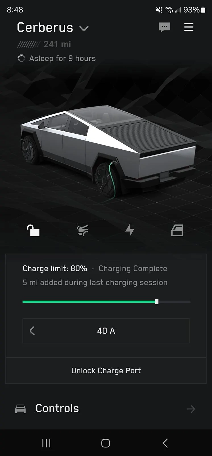

No need to do firmware the most recent update of 2024.20.1 fixes the Vampire drain. I haven't turned off camera detection. App still runs on my phone while I sleep and now the Beast goes to sleep and stays asleep. Last 9 hours has been asleep with no drain no loss of mileage, etc. Here is my app showing that my truck has been asleep for 9 hours and still charged to the max of 241 miles at 80% charge for a cyberbeast.
