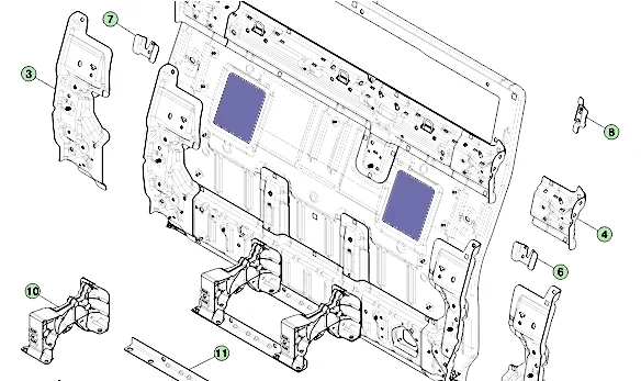

Regarding air infiltration to the vault, there is a pathway for air to pass between the vault and the cabin. There's a 1.5" gap below the back window where the tonneau cover passes to and from its storage compartment. This 1.5" x 59" gap provides 88 sq in for air to pass from the vault through two vents in the back steel wall of the cabin (behind the rear seat) and down to the cabin floor. The blue sections in the diagram below mark the openings in the back wall where air can pass.
Tesla Cybertruck Vault Bed Heat Pump Build (Heating & Cooling) 🥵🥶 Rear cabin wall vents
To ventilate the vault to reduce humidity and CO2 buildup while sleeping in the vault, all that's needed is an exhaust fan on my Lexan panel to draw air from the cabin into the vault. The air can be temperature controlled by setting Camp Mode in the cabin as long as some loss of battery energy is acceptable. The only question is the size of the exhaust fan needed to achieve a healthy air exchange. That can only be determined by experimentation.

It turns out that those two openings in the back wall of the cabin are covered by fabric that limits the amount of air that will pass between the cabin and vault.

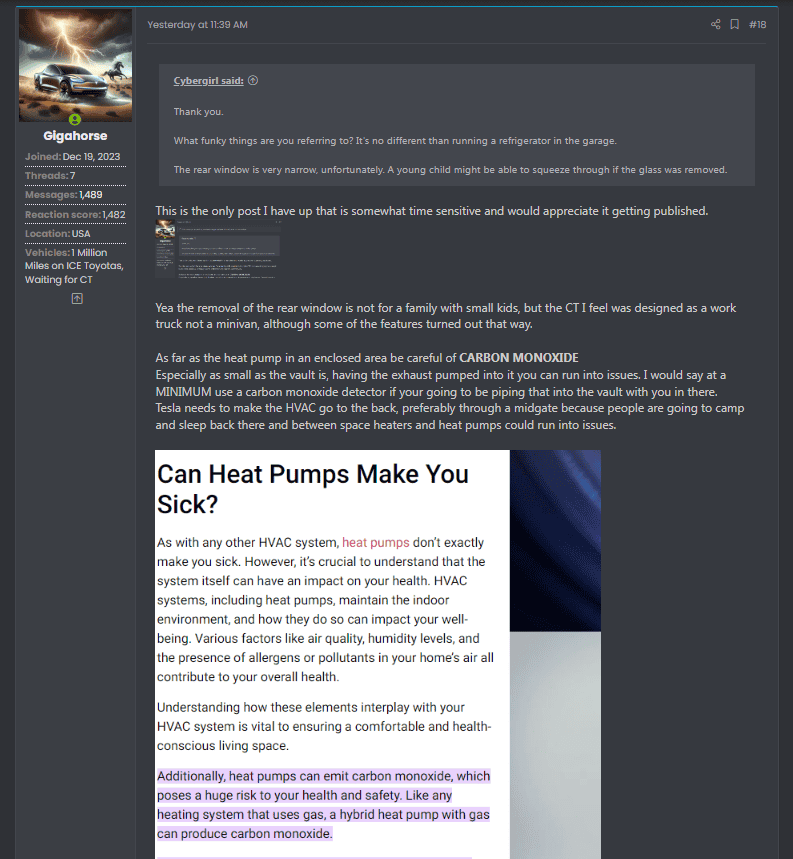

Careful running it in your garage overnight as there can be some funky things if your pumping heat into an enclosed space with a heat pump so maybe park outside or leave the garage door open a little.

please describe what can go wrong using BougeRV?
It looks like there are paths through the vault floor to allow water to escape...? That would also provide air passage if using a fan to create positive/negative pressure.
You should fill the fault using a smoke machine, induce a positive pressure, and watch where it goes hahaha

This is nonsense. The vault air is pulled over a heat exchanger coil and pushed back into the vault. There is no combustion of any sort involved that would produce carbon monoxide.
Yeah, the only way there'd be CO is if there was a generator or another idling vehicle nearby.
