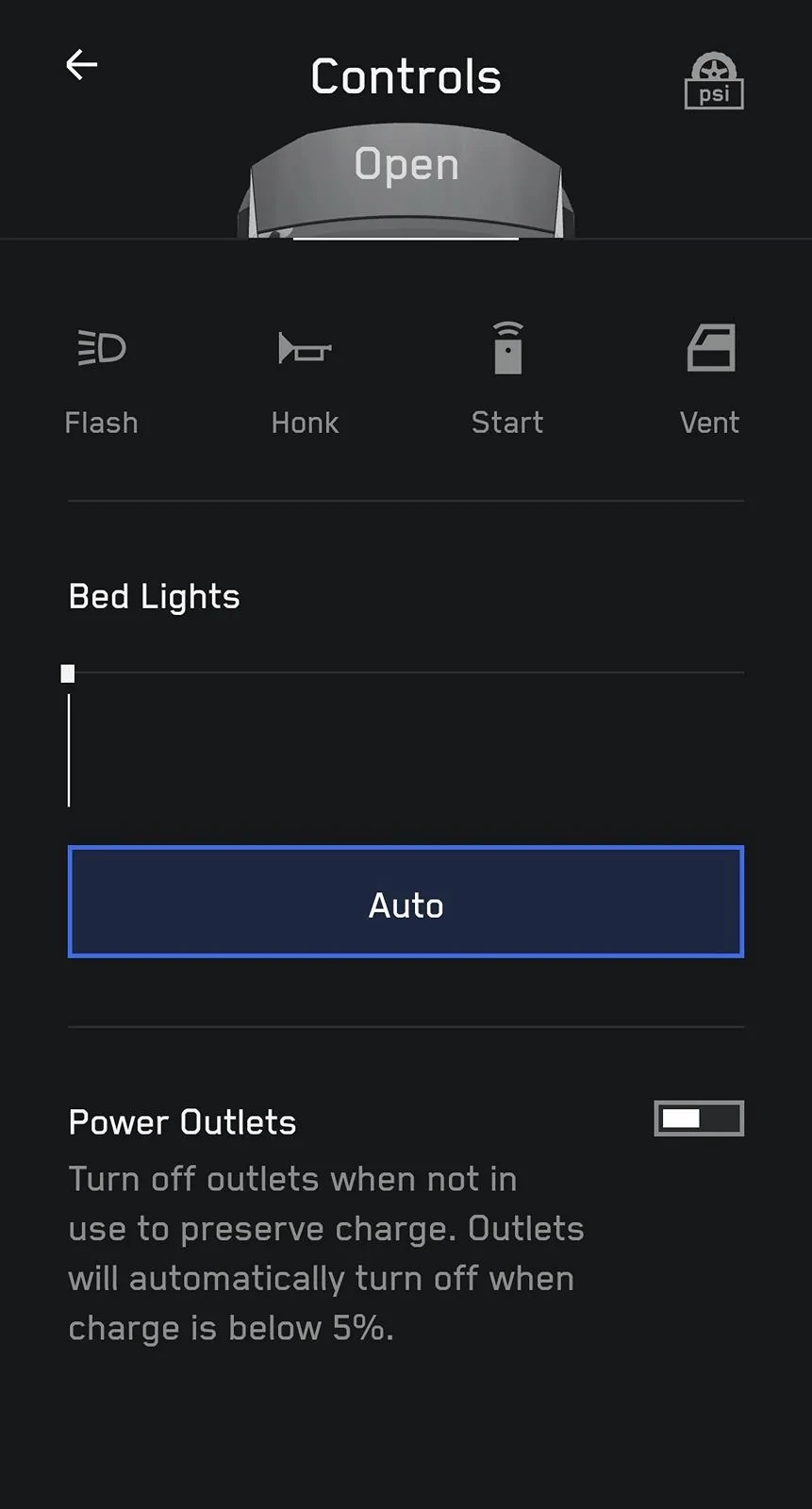

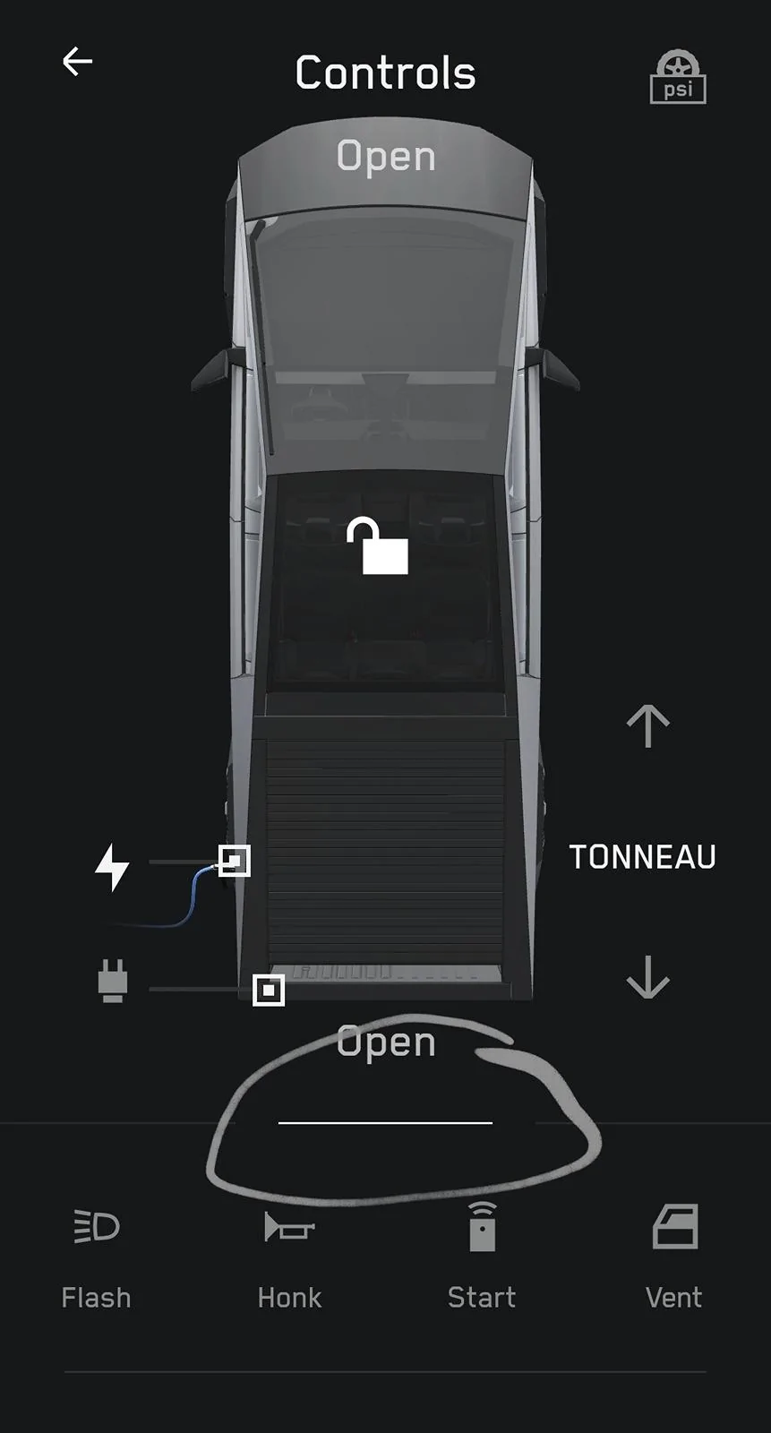

I couldn't find a button for the lights. Where is it in the app?
10,313
34,183
Have you downloaded the latest app?
Indeed.
However, I'm using the iPhone SE, which has a slightly different aspect ratio from the newer "notched" iPhones. I've noticed other places in the Tesla app where text and objects are misaligned, so I'm guessing the horizontal line on the "Controls" page is rendered below the visible part of my screen.
[UPDATE: The controls appear in the app now, it must be an intermittent rendering issue.]

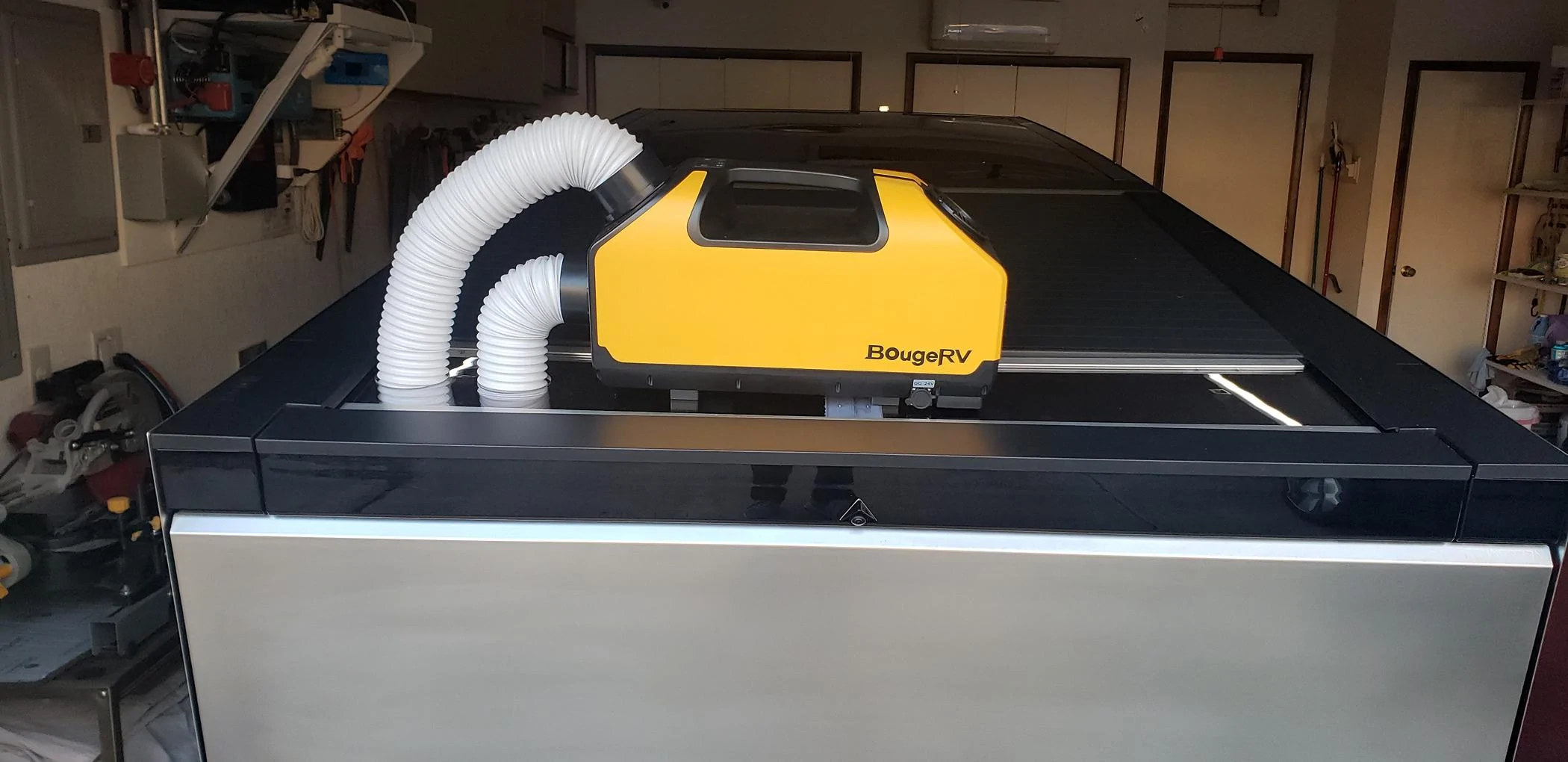

I'm not sure I understand what you are suggesting. I originally wanted to pump cabin air into the vault through the rear window, but removing the rear window proved to be too challenging for me, and there's no aftermarket replacement for the rear window at present that features a sliding section.
I suppose one could run 4" ducts from the cabin to the vault through one of the cabin windows with some kind of window insert with 4" duct connections like this:
Tesla Cybertruck Vault Bed Heat Pump Build (Heating & Cooling) 🥵🥶 Screenshot 2024-04-12 at 9.48.11 AM
In that case, I wouldn't need the BougeRV A/C unit since the CT's heat pump would provide heated or cooled air to the vault. The reason I didn't pursue this approach was because I thought it would be too inefficient. Why heat or cool the cabin AND the vault when the cabin is not being used?
What I came up with is this installation of the 2900 BTU BougeRV A/C unit (plenty big enough to cool the vault's 50 cu ft volume.)
Tesla Cybertruck Vault Bed Heat Pump Build (Heating & Cooling) 🥵🥶 BougeRV installed
I still need provision for ventilation, though. I'm thinking of putting some kind of a 4" diameter PVC or ABS plastic collar on the intake port with holes to allow a small amount of outside air to be drawn into the circulating air stream.
I'm not sure I answered your question.

maybe i misunderstood your post about the 1.5" ports that were covered with "material". i thought they were under the window, in which case i was thinking of putting the tubes through them and venting the heatpump through them.
have you tried your setup in the rain? i don't like the idea of having the heat pump on top of the vault and getting rained on, and having to keep the vault partially open (cause of rain).
When camping, I usually set up my 10" x 10" Crown Shades canopy and park the back of the CT under it at night for protection from forecasted rain (not often needed in the desert). In the day it provides shelter from sun and rain (and wind with optional side panels).
Tesla Cybertruck Vault Bed Heat Pump Build (Heating & Cooling) 🥵🥶 Screenshot 2024-04-12 at 10.15.57 AM
Without the canopy, you can't open the tonneau in the rain without getting soaked. Even opening the tonneau in the morning after a night rain will allow some water to drip into the vault onto your bedding. Set up is easy but attaching guy ropes takes some time.
