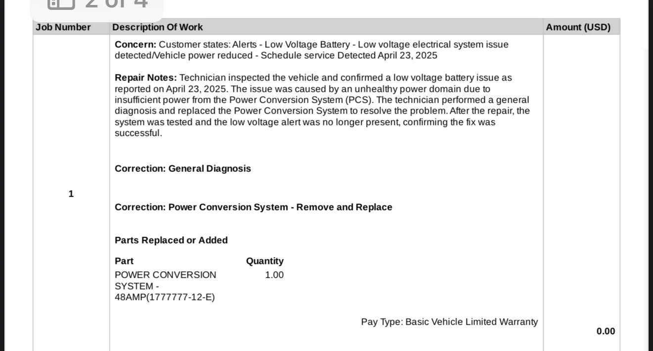

Someone on Reddit is saying they had this issue, and turned out to be not only a bad PCS, but they replace the entire battery pack too. I wonder if these errors are generic HV gone bad errors that can mean multiple things.
EDIT: Did the vin lookup and I have the latest T2-G PCS.
