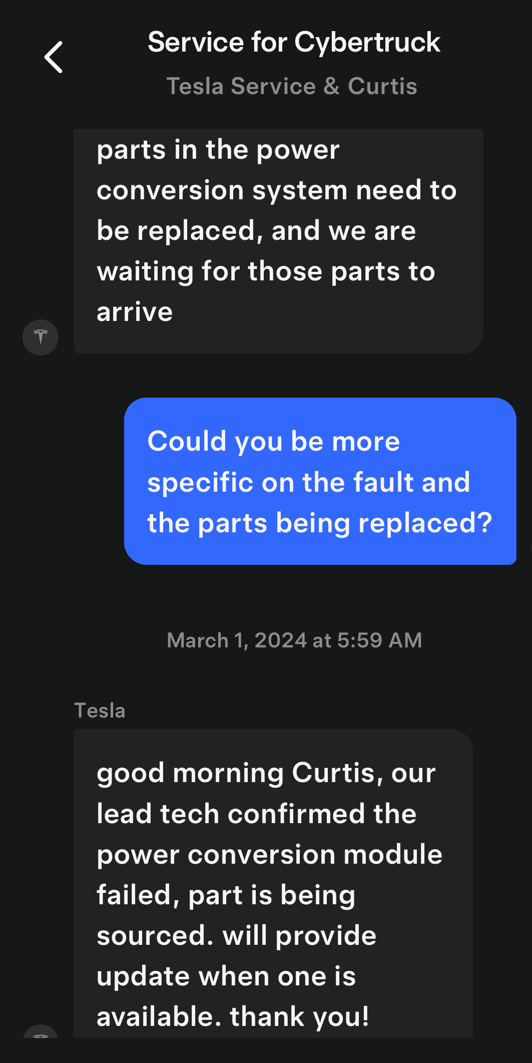

I thought we have a very similar problem, but we appear to have a different path to resolution. They said to me:
"We are progressing through service and technician diagnostic, Bed and Backbone Harnesses - Harness - LV Backbone is faulty. The part is special order and plan to have the part by 03.08.24. Once we install the part we will need to perform a extended road test to ensure there is no other alerts."

looks like I better order a spare power conversion module and harness before I get my cybertruck lol
