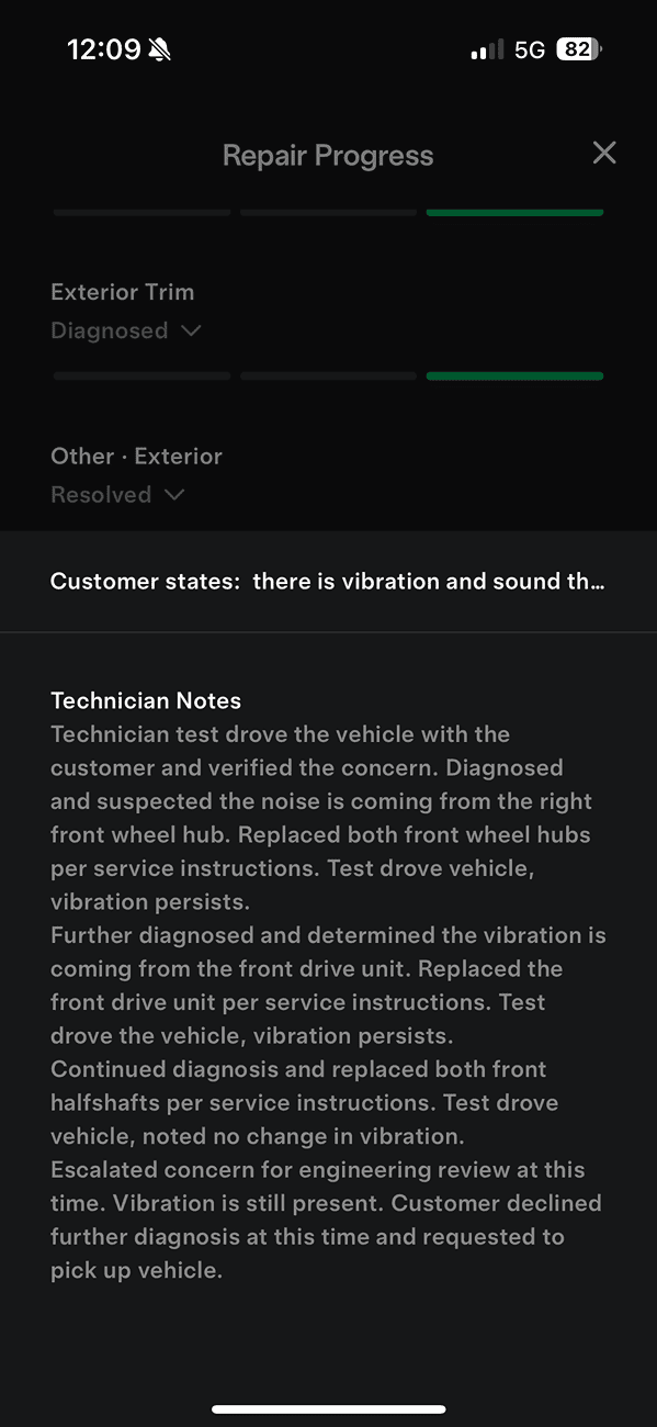

Wish I had a better report to give, but after 9 days at SC, they released it saying they’ll send the data to Tesla engineers and let me know what else they want to try at a later visit. I told them about the forum posts with identical issue and that rear drive unit seemed to be the common fix, and that’s about the only thing they didn’t replace… Here’s what they threw at it:
Tesla Cybertruck Vibration when releasing accelerator IMG_9868

Pilot
Just picked up my truck from service they replaced both drive units and there is zero vibration now between 40 and 50 mph or on the interstate
