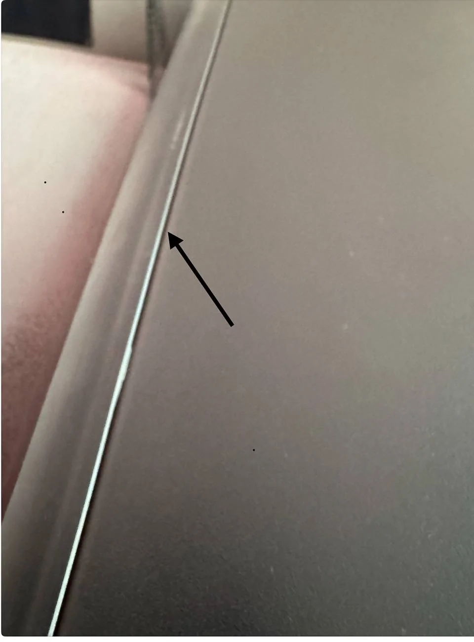

Oh man, thanks for this. I'll be testing mine and sealing it off this is where it's leaking from. My tonneau has been "reworked" three times by the service center and it's still too wet to keep, say, suitcases back there on a road trip.
Edit: Just tested. Yup, just watched water run off the glass right through the gap between the glass and the applique. Hot damn.
Edit2: That particular windshield rubber seal is currently on sale at Amazon. I have never been so excited to stick on a piece of tape in my life.

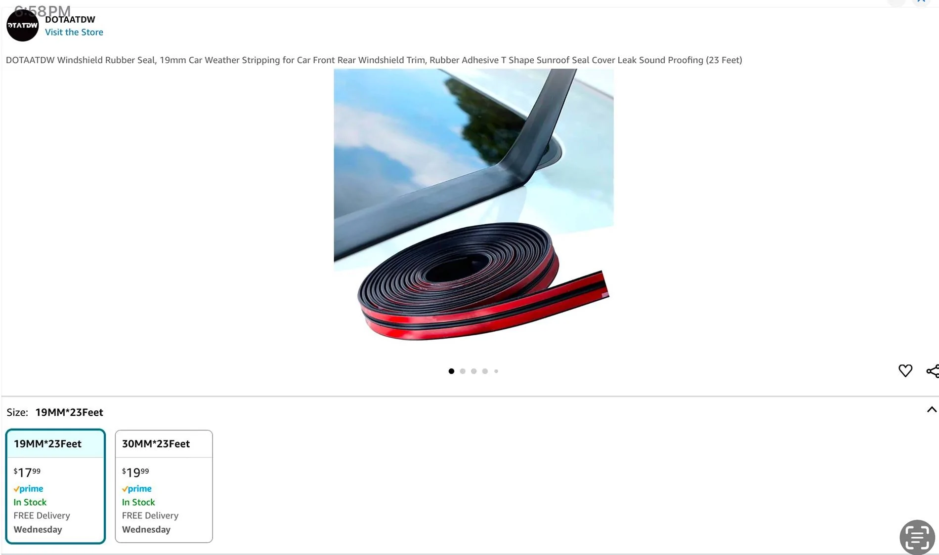

Didn’t help me either,but put an auto glass seal between the appliqué and roof glass and it did the trick. Appliqué edge abutting the glass needs to be cleaned with alcohol. Using an adhesive promoter/enhancer will allow a tight seal. When applied looks like it’s part of the appliqué . It’s an inexpensive and effective way to minimize the drips.

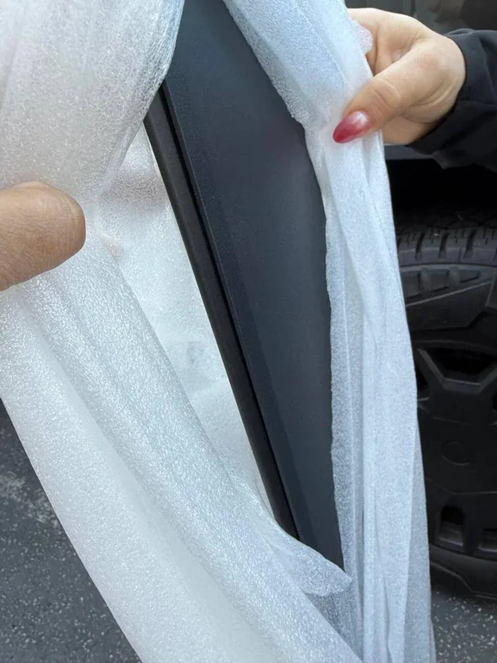

I tried the video weatherstrip and it didn't fix it. The strip with the middle part removed was far too soft and let water beads in through that curvature, instead of creating the gutter that the video spoke of. Couldn't withstand regular rain, was a sieve in a soft cloth car wash.
Then I added an additional weatherstripping bulb type, that also let water beads in, albeit less and slower.
Today, I gave up trying to make it invisible from the outsideon the underside and stuck on this exact windshield tape on the seam between the roof glass and the appliqué. Cleaned it up with the alcohol wipe it came with, made sure it was dried out with a bounty paper towel and stuck it on end to end, including over the side roof appliqués. Poured a big bottle of water on the roof after (winter here, hoses are already stored away and spigots off) and watched the water bypass the seam and continue towards the tailgate taking a normal drainage course. This might be the first time since getting the truck in October that my rear window is dry.
Only got some drops in after opening the tonneau cover with water on it.
I am impressed and grateful for this fix, @Art138 .
Hopefully it stays stuck on. Didn't use any adhesive promoter as I didnt have one. Worst case scenario, will add some clear silicone to the underside if I see anymore drips. Don't need the appliqué to be removable, as I don't have the tent or anything like that.
