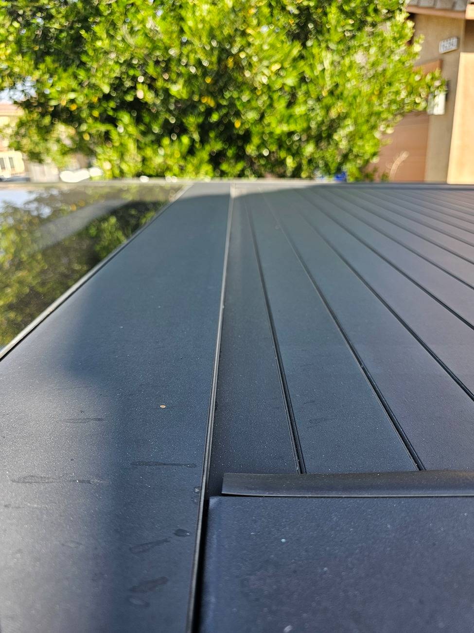

Thank you so much for responding. Can you post a picture of the same area AFTER the repair? Thanks again.
Here is the after picture. Again, just say your CT is missing parts....dont complain about leaks. .
Tesla Cybertruck Waterproof your bed vault - how-to DIY 20250713_091447
Harsh.
So in my case adding the slat did nothing for improving the leak. It was mostly cosmetic. The real issue was the aeroflap seal.
116
8,504
9,791
check the seal right where the glass meets the cover that you can take off to install the cybertent. if adding the slat didnt help then your issue is probably there.
That’s where mine was

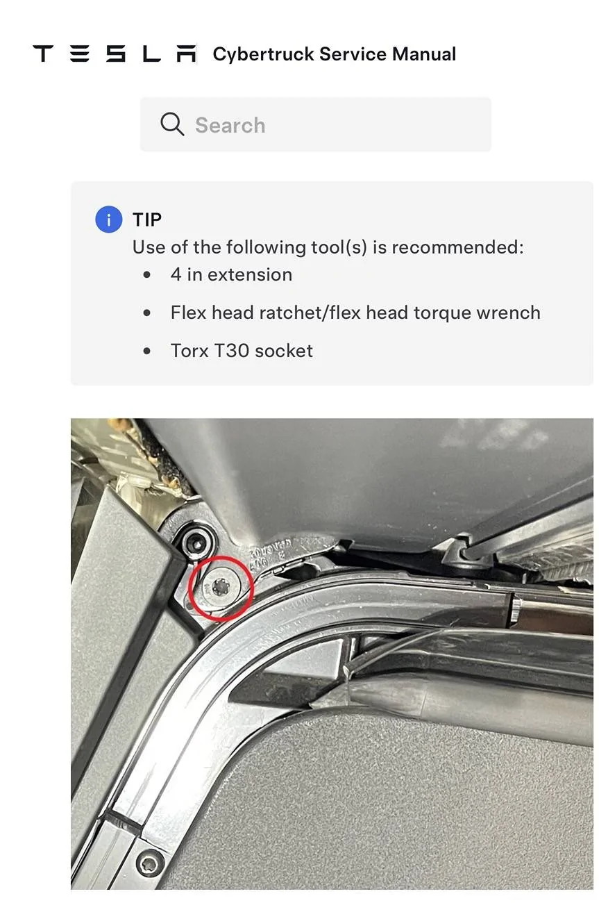

I don’t have the tent, but could you provide a link or explanation on how to remove said plate?

people are saying that leaving the aeroflap in place and covering the gap between it and the the roof glass with something like this:
https://a.co/d/dlgpSCR
or this:
https://a.co/d/jiVZepB
helps. I think that Im going to go with the first product if adding the extra slat doesnt help.
also my CT (2025 AWD) had an aeroflap seal already in place place that was not seated properly in a small section, so I just fixed it by running a pry tool along the seal and that seemed to reseat it in the proper position. hopefully some combo of all three of these fixes (aeroflap reseat, adding extra slat to tonneau, applying weather strip to cover leading edge gap of aeroflap) will create a dry vault.

Does anyone have their aero flap off at the moment? Can you share a picture of that area with and without the tonneau closed?
116
8,504
9,791
My car is at the wrap shop but anyone who has a cybertent should be able to send you that picture pretty easily
