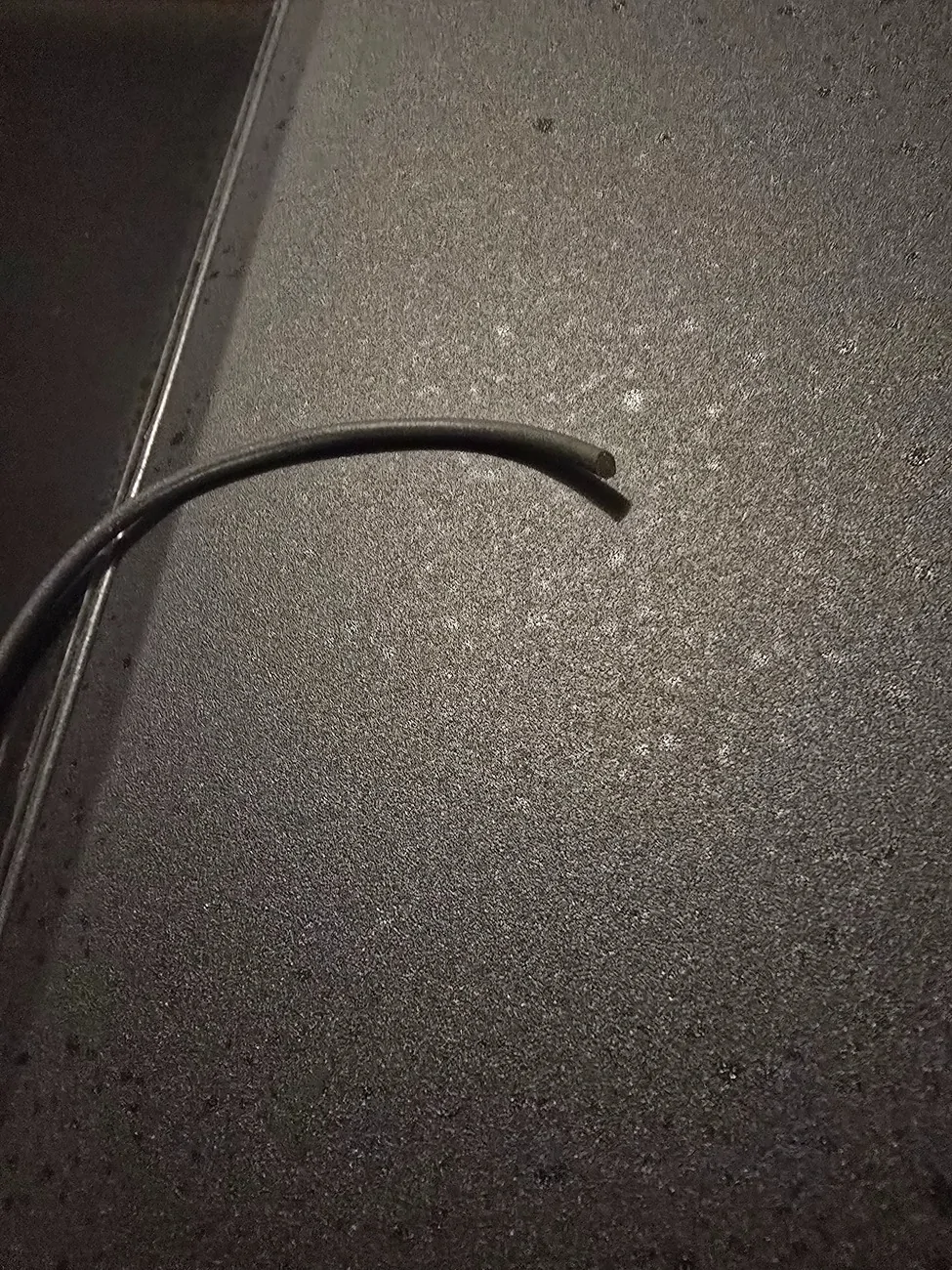

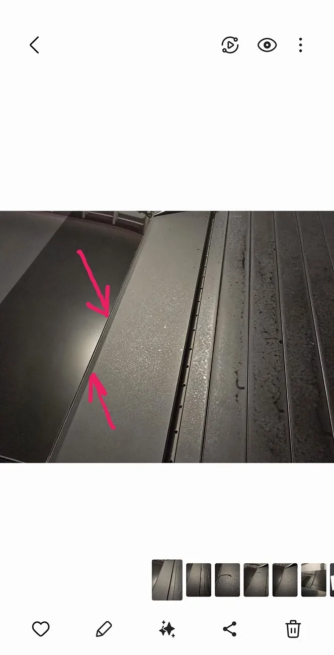

Interesting solution, did you remove the trim pieces or applique in your installation?

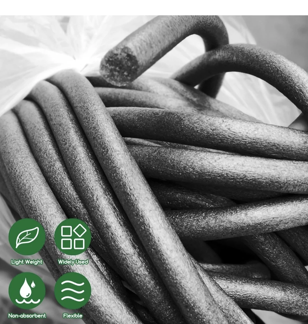

No, I precut the length as not to have breaks in the foan rod and pressed it in with one of those orange plastic tools. I have noticed over time that it does not keep the bed totally dry. It helps! The last toughless car wash I visited got a good bit of water in the bed. I have also noticed with this fix it depends on how hard it rains and the angles of a hard blowing rain. It's strange though. Sometimes it makes it through a rain storm and a car wash dry as a bone and other times water find it's way in. But it never really floods.
Also, the wire powering my rearview mirror camera is not helping my case. I did introduce a spot of clean silicon where the camers wire tucks in.

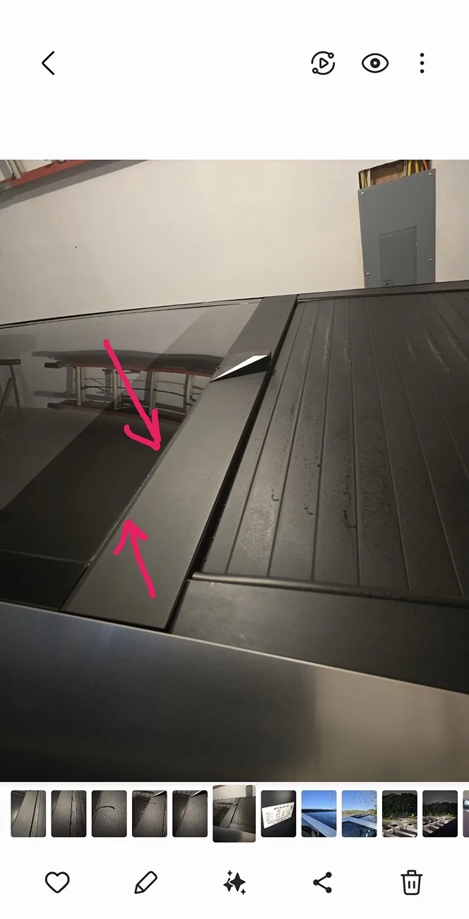

I did the backer rod over the appliqué between the glass and it HELPS. But the sides that are exposed on that appliqué, water still goes in there. But it’s definitely reduced.
Tesla definitely needs to redesign that piece

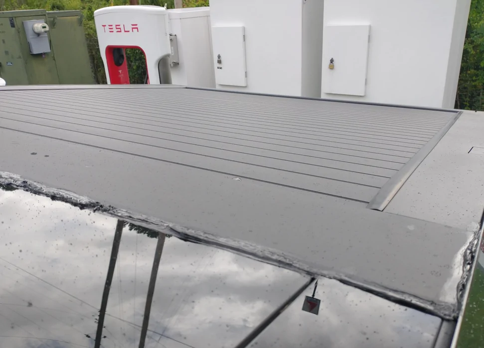

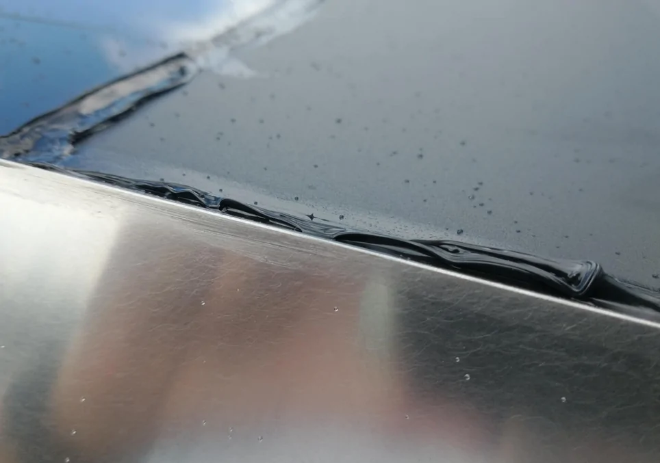

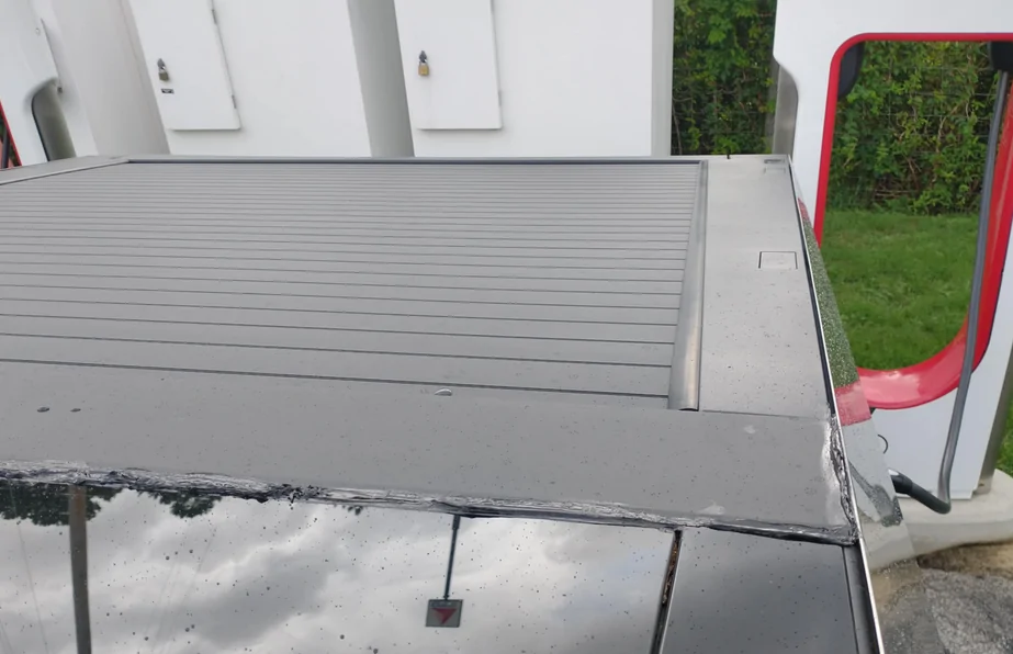

Yea it seems like his silicone mess over the top may be the only option to keep the vault truly waterproof until Tesla finally addresses this.

I did the backer rod thing and it’s improved but still not bone dry. Also put waterproofing weatherstripping over it. Still allowing water in (ever so slightly)
gross silicone bead may be only solution but at this point I’m probably fine with it until the release a new applique cover, might be only solution. Curious how this will hold with heavy snow?

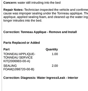

Looks like Tesla is finally addressing this with a new part and foam seal.
Is this confirmed? I wonder if they will charge for the improved part, like with the wireless charger.
My parents paid $800 for their Santa Cruz cover and drove through a monsoon without a drop of water in the bed. I wonder if T-Sportline or another third party will ever produce a working waterproof tonneau?
Wireless charger overheating is a free swap due to the first one cooking phones, considering how badly some vaults leak I would assume this would be fee as it corrects a manufacturing and design defect.
