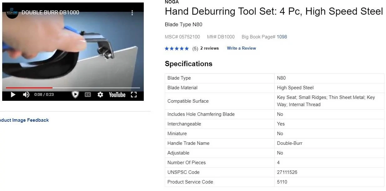

Deburring tool would help get rid of most of it and probably make sanding it smooth easier as it'd be more even

I'm wondering if the Noga DB1000 dual edge would work on the SS.
Noga - Hand Deburring Tool Set: 4 Pc, High Speed Steel
Blade Type N80
MSC# 05752100
Mfr# DB1000

My concern would be this wouldn’t work on surfaces where you don’t have clearance for the inner roller. But for sure it looks like it’d work on the door…
