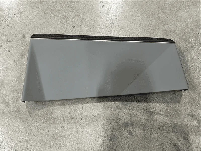

Sorry the question came off a bit harsh. What I meant to ask was: is this what you did? Or did you have to take off the whole door panel?
gray panels aside, is it possible to change it without the whole plastic welding?
No it wouldn't look good. There is no gap in the panel to tuck the fabric between it and the light mechanism. YOu need to break the plastic weld to be able to fold the fabric over the top of the panel under the light cleanly. Requires plastic welds being cut to do so.

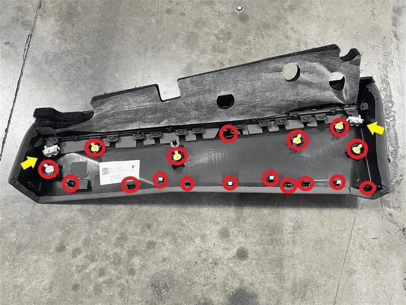

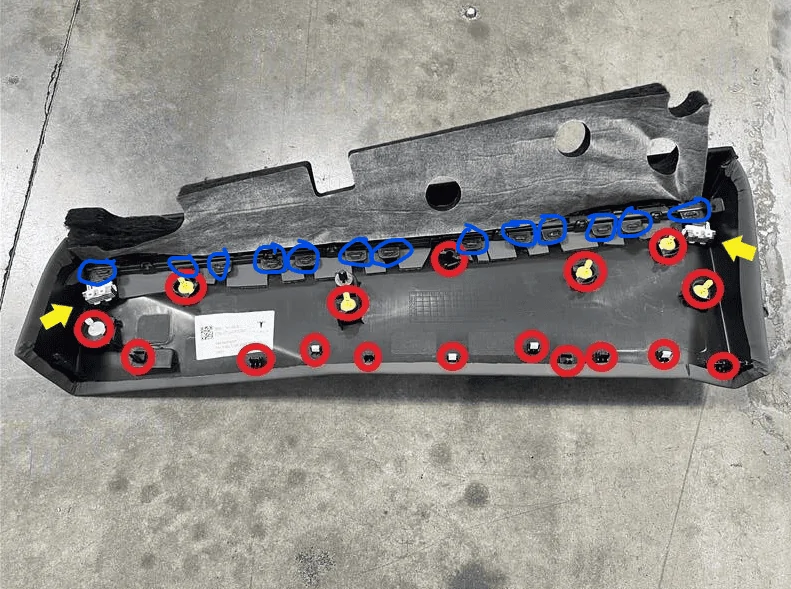

Can you mark on this image which welds do/don't need to be separated?
THANKS!
Your workmanship is nothing short of beautiful
See image below. All the tabs circled in blue must be separated. The best way to do this is take an osicalating tool and cut into the very top of those tabs where the OEM welds are. Cutt off as minimal as possible so it goes back together easier. Grind off just enough and then use a razor blade to break any remaining that still may be attached by a thin piece. This will make it the easiest to put back together once separated.
Now what you can't see in the photo because it has the foam backing pad blocking the upper black panel back. There are additional plastic welds on that panel. THOSE WELDS DON'T NEED TO BE CUT. I learned this the hard way on the first panel I took apart. Those welds hold the light mechanism to the black panel. The only reason you would need to cut those welds is if you wanted to reupholster the upper black trim as well. Assuming you are not, do not touch them.
