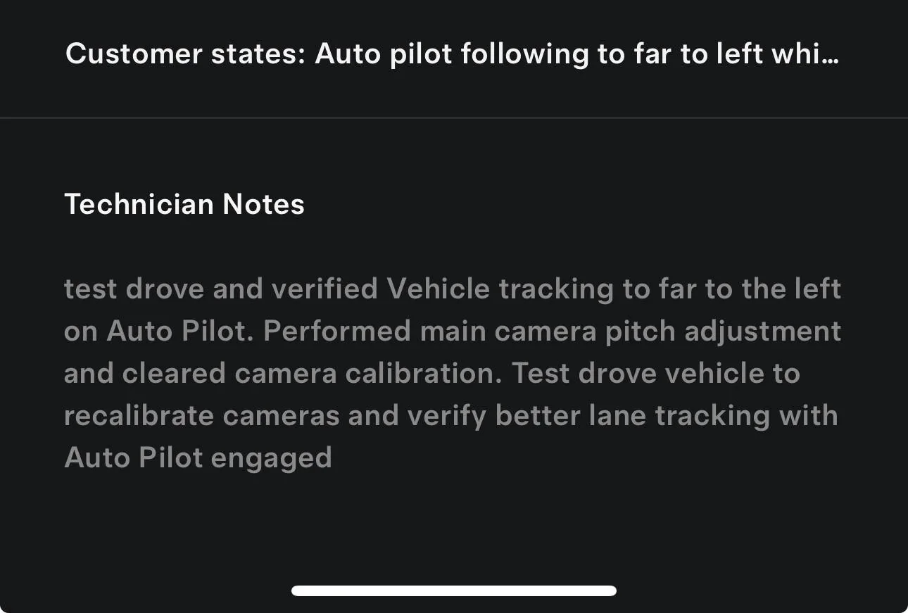

I’ve had the same issue. Took it to Tesla today and the issue appears to be resolved now. Y’all might want to look into how to do the ā€œcamera pitch adjustmentā€ that’s listed in the tech notes. Here’s the note from the tech:
Good to know! I may try to recalibrate mine before exploring a service request.
