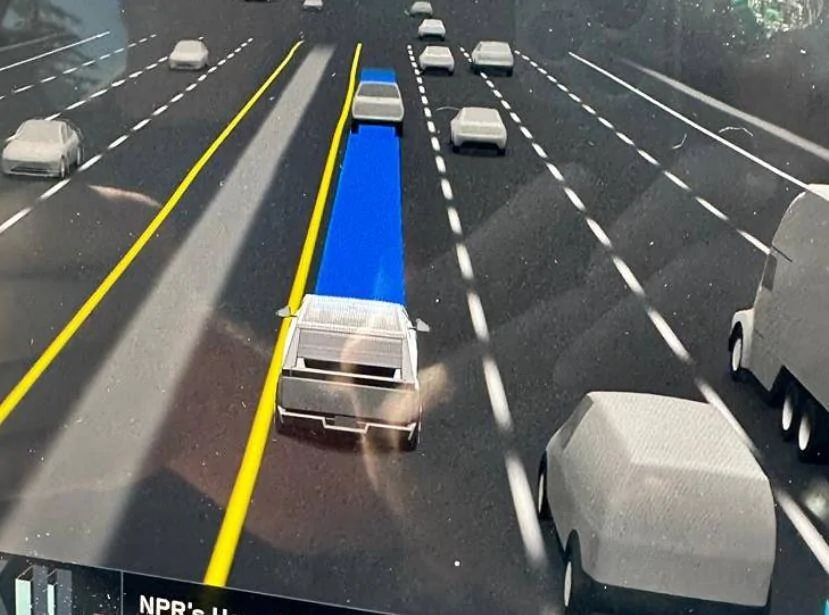

Why is FSD not staying centered? CALIBRATION? Am I alone with this issue???
Pops
Dec 31, 2023
35
1,209
2,562
Houston, TX
MY, CyberBeast
Am I the only one who doesn't have this issue?
2 weeks ago my wife was driving the CT while I was the passenger. She didn't intervein like I would have and the tire rubbed the right side curb. It will hug the lines or leave the lane a couple times per drive. Her Model Y does much better with FSD.

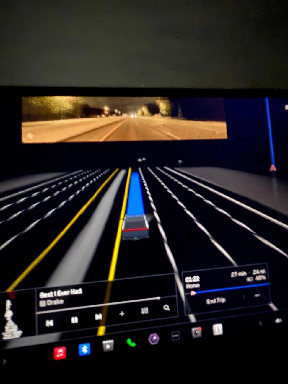

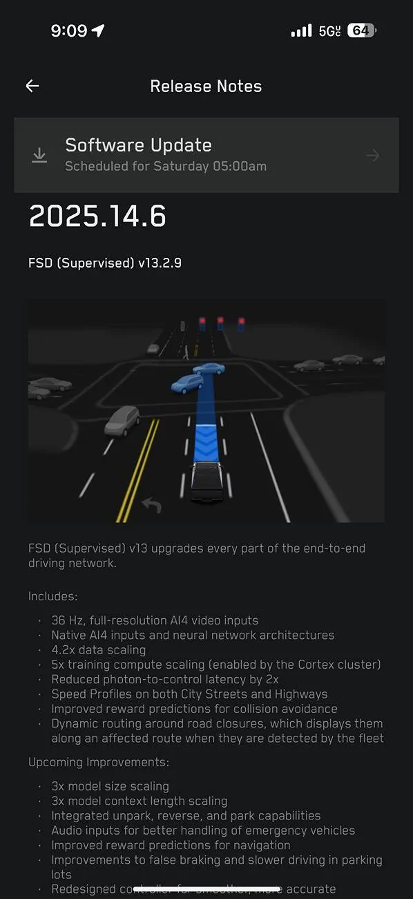

New update for FSD, I’ll see if my issues still persist.

I don’t either based on the rainbow road setting always centering within the lanes. Those who have the problem have probably tried recalibrating their cameras and rebooting so I wonder why they have the problem and we don’t? Luck if the draw?
No. I’ve never recalibrated my cameras and I didn’t have this issue until probably three releases ago. Also, the AWD that they gave me for a loaner about a month ago had the same issue.
I do not feel its a calibration issue because when the truck leaves a lane or hugs a line it shows itself doing this in the UI representation. That tells me it understands exactly where the truck is in relation to the lane. I suppose its possible the code that positions the truck in the graphics and the code that drives the truck are not directly related.
Agree. All I know is it’s frustrating and it’s really annoying that it’s taking them so long to fix it.
It’s also weird that it isn’t affecting everyone universally and those who aren’t seeing it really don’t have a frame of reference of how bad and annoying it is.
It really does make it unusable and it’s such a simple thing! Get your ass in the center of the lane and stay there! What are you even doing! Why would this be happening [rhetorical]???!!!
