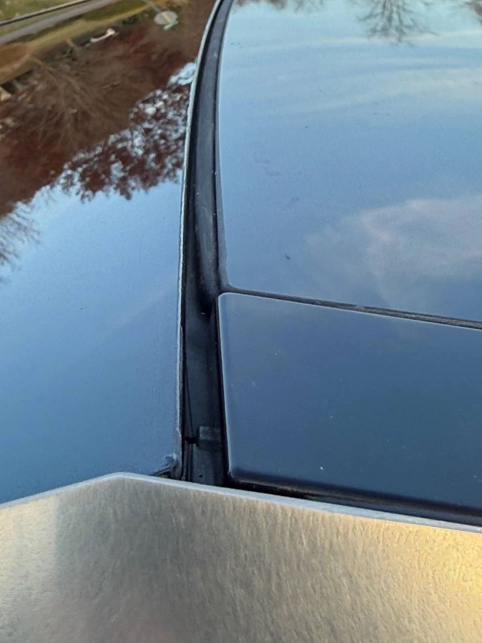

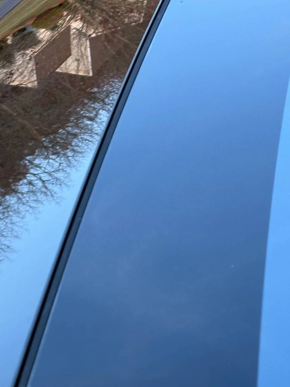

the noise reduction kit from RPM Tesla for the model S fits the Cybertruck very well. Took a few tries but I was able to install in about 15 minutes with painters tape as a helper (they have an installation video which was helpful). It is a loop of rubber - I ran it around the perimeter of the roof glass - easy on front and back, but with sides I had to decide whether to run along the roof glass or the side piece that abuts the stainless steel side. I chose the former because it made the perimeter smaller and much closer to the size of the model S - I was afraid it wouldn’t stretch enough if I ran it down the outer sides. See pics.
And … it really helped! Definite reduction in noise. Thinking much of the improvement was closing the gap between the windshield and roof glass. Only $30 bucks. If you have windshield noise, maybe give it a try.

My CT sounded like a tea kettle at speeds above 50 mph. The service center resolved the issue: "Fixed Glass Roof Assembly - Remove and Replace." Part: FIXED GLASS ROOF ASSEMBLY (1770891-00-D).

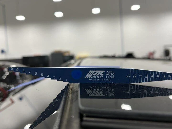

The service manual for Windshield location on the cybertruck shows the top border of the windshield is supposed to be 1mm over the sunroof glass. If it does not have that clearance, windnoise results. If your windshield shows either level or slightly below the sunroof glass, that is probably the cause of your wind noise and it should be covered under warranty since the Telsa Service manual includes that spec.
https://service.tesla.com/docs/Cybe...UID-28743D4C-E164-4741-8C95-D09F014DC857.html
See this picture about 85% down the page on the above URL:

Another consideration which might be a consideration--the lightbar sits atop the windsheild, might channel windflow and correct the issue if it's determined that the windshield is not 1mm above the sunroof, I have no knowledge of this but posts on this board I've seen seem to indicate the lightbar does not add any windnoise.
My CT is in the shop currently with a windshield being replaced (Helene dropped a tree on it) and so I did research to find out install specs and led me to above 1mm issue. When I asked the mechanic to ensure they check that (they said they would), I never got the feeling they actually had done this before or knew about this placement. Windshield is a bear to install, and suspect being off by 1mm may not be uncommon, perhaps:)
Thank you for this! My windshield is also being replaced due to a windstorm and, in the process of fixing it, they broke the roof glass. While the truck is waiting for parts, I'll make sure to bring this 1mm thing to their attention. (I'm sure they'll just love that...). I get the impression they also haven't done many replacements in my shop either.
This is super helpful information, thanks! I am also experiencing windshield noise where it sounds a lot “windier” than you’d expect even on days with minimal wind. I looked at my windshield and the gap looks good between the windshield and the roof but I noticed my windshield sits slightly above the roof line and not flush. Do you know if this is correct? In the picture the windshield seems flush with the roof line. Thanks!
