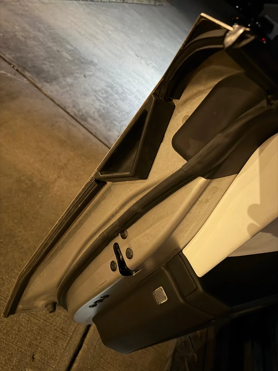

I had the same exact issue, and dropping the rear windows SLIGHTLY greatly reduced the noise.
I installed the aftermarket door seal kit, and it stopped completely without having to fiddle with window positioning.
Awesome! Can you provide some details of what you bought, and maybe a picture of the seal? We would be super grateful! :)

Thanks for sharing this. I would have assumed the fix would be some kind of upper seal near the top of the window, but if you’re saying this so solved the same issue all of us are having, I’m going to assume they’re related in someway and take your word for it.
It worked for me for sure

Thanks! Just bought these, because why not? But I have some doubts that it will reduce ALL wind noise, especially the noise caused by the windows flexing. Seems the best self-help solution offered here so far is the re-calibration we can do through settings - still need to try it myself though.
