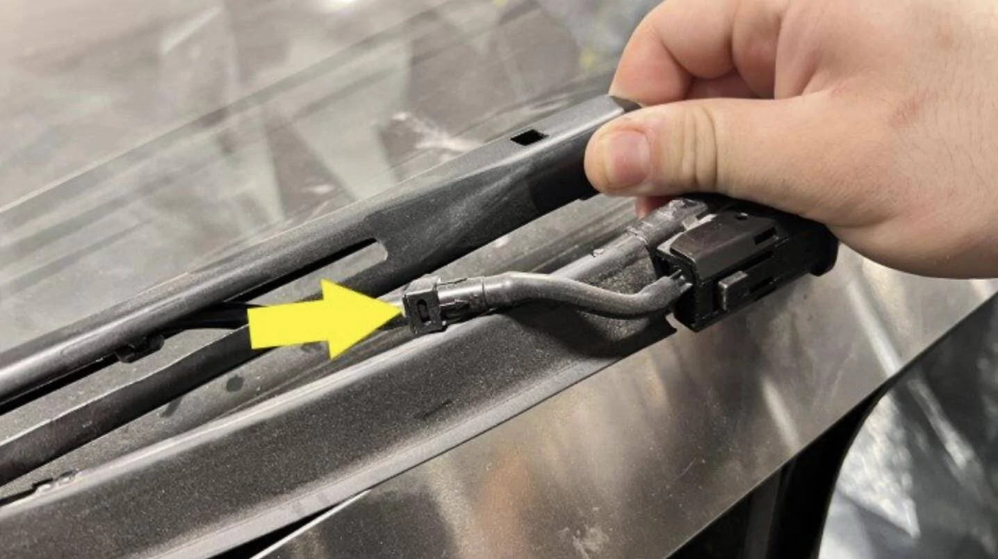

I just got back from the Tesla dealership, where I had my windshield wiper fixed for the same issue. When I went to pick it up, I noticed that no washer fluid was coming through. A technician came out to inspect it with me, and soon, two technicians were looking into the problem. They discovered that the hose near the very top of the wiper blade, where it connects, was kinked. The tubing was approximately half an inch too long, causing it to kink and block the flow of water. The technician then took out a pocket knife and literally cut off about half an inch of the tubing to prevent it from kinking, which completely fixed the issue. Here's a photo of the tubing he cut down that was kinked. He just pulled that tubing off, trimmed about half an inch off, put it back on and it worked.
Hopefully this can help a bit. It's a super simple fix that only takes a few minutes to fix.
In my experience with replacing the blade, the washer hose must be pulled out to get enough play to R&R from the blade. It will be kinked if left this way, but you can pull from the bottom of the arm to take up the slack and prevent kinking.
I don't believe it's necessary to shorten the hose, but that certainly works lol
