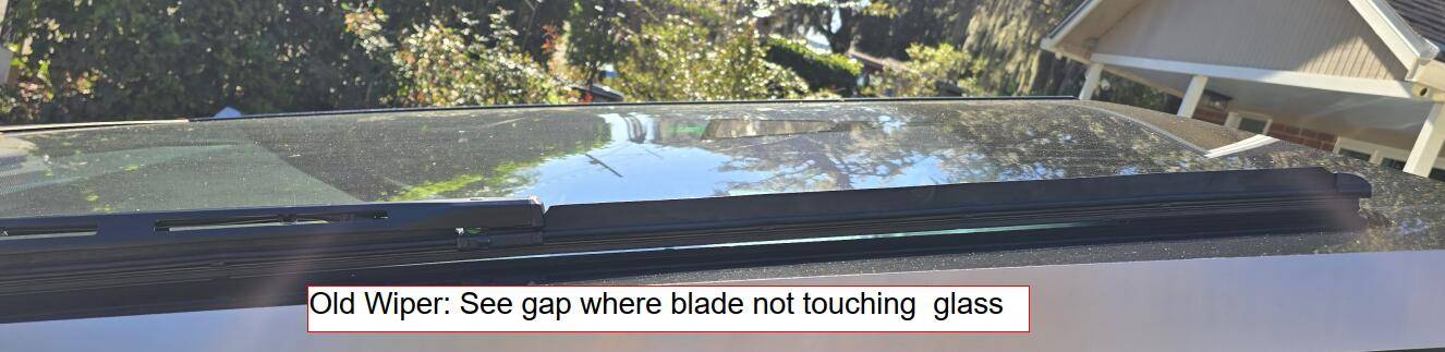

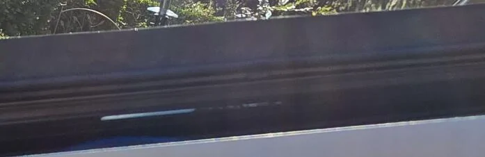

My windsheild was shattered in Hurricane Helene when it dropped a tree on it. Winshield completely replaced, along with new wiper control arm and blade. I got the truck back 11-29-2024 and ordered a new wiper blade from Tesla on December 10. See photos below of the before and after blades, both of which were new.
Tesla Cybertruck Windshield wiper/sprayer not cleaning full windshield anyone? 1736007924346-n
Tesla Cybertruck Windshield wiper/sprayer not cleaning full windshield anyone? 1736007965444-au
Tesla Cybertruck Windshield wiper/sprayer not cleaning full windshield anyone? 1736008012415-hv

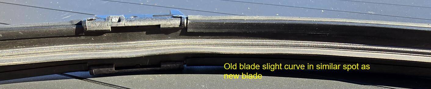

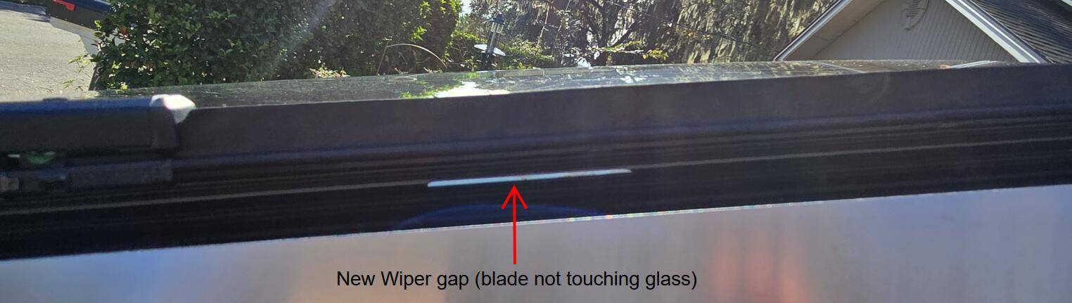

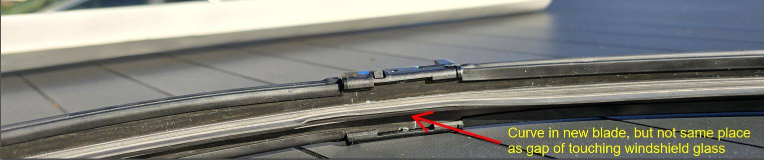

Same new wiper blade, but pulled the wiper to me to shift the blade on windsheild glass as though it was on the upswing (see reflection of trees on the glass):
Tesla Cybertruck Windshield wiper/sprayer not cleaning full windshield anyone? 1736008163521-uy
Tesla Cybertruck Windshield wiper/sprayer not cleaning full windshield anyone? 1736008220335-gl
Tesla Cybertruck Windshield wiper/sprayer not cleaning full windshield anyone? 1736008257931-5i
I didn't take a video, but the newest blade had a much better washer spray than the older blade (the one that came with the whole new wiper assembly). But it only spray on the upswing, nothing on the downswing.
The wiper metal assembly asserts downward pressure on the blade from an arch design, and for some reason the blade does not apply equal touching on the glass from that central arch-pressure. Perhaps it is due to inconsistency in the manufacturing of the rubber blade? or somehow the result is a material difference in how these two blades leave a gap in how they touch the glass. I happened to get the sunlight exactly opposite the blade so it shows the light coming through. Maybe others can check blade gap and see if there are consistencies.
