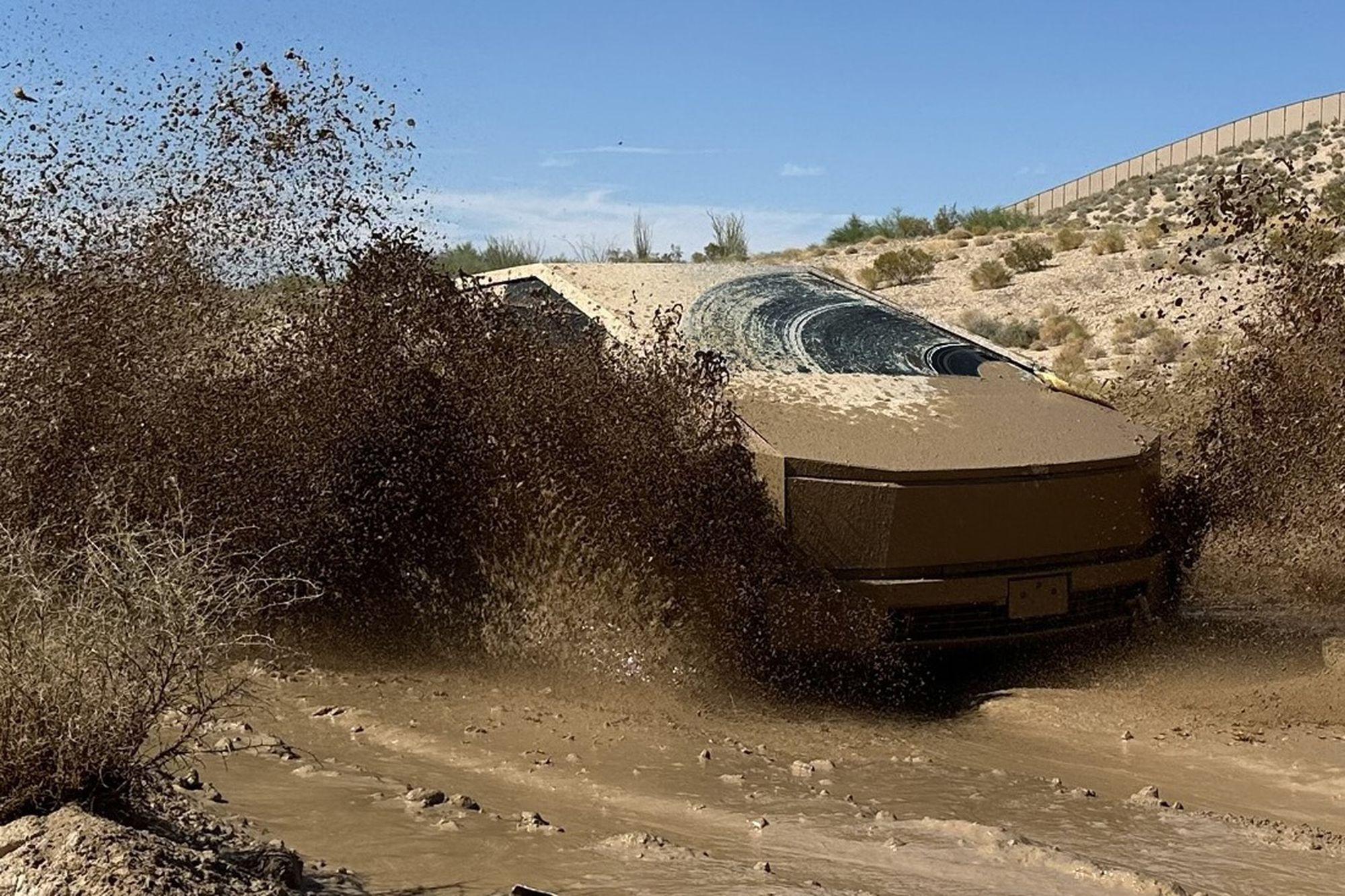

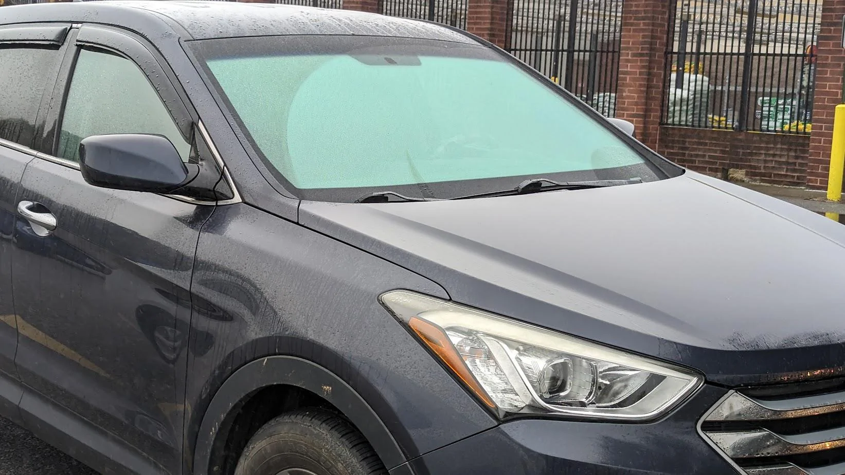

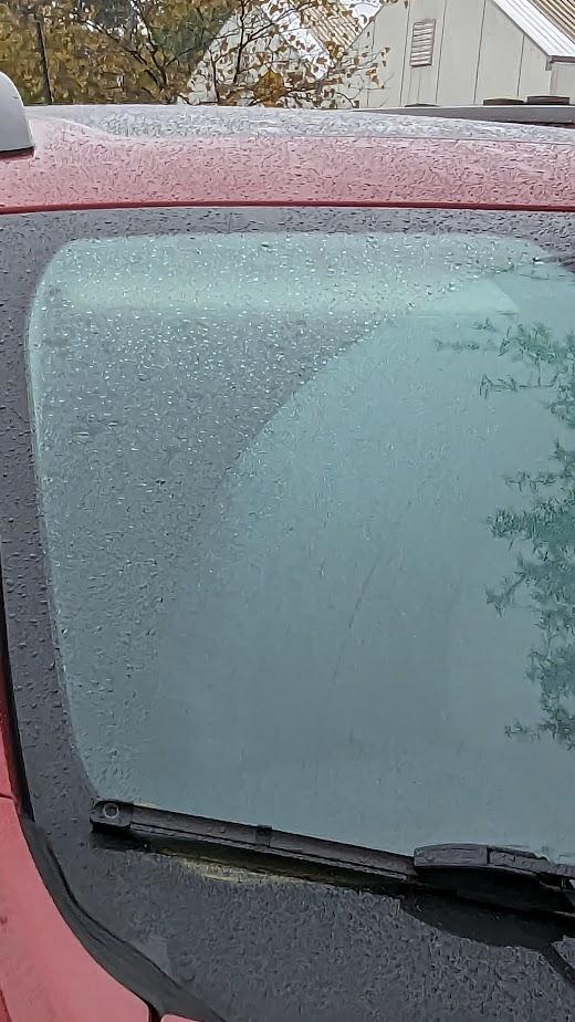

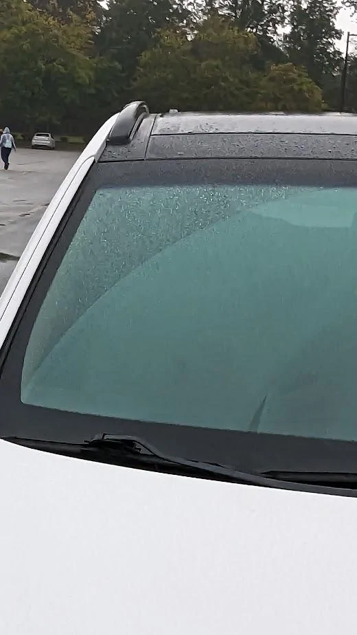

All, please forgive me if this has been covered before, I'll delete if so. I've had this conversation a few time in other places. So this morning, I snapped a few pics while cruising through the Wal Mart parking lot. The standard for wipers breaks the windshield into three columns, and the one in front of the passenger only requires 80% sweep. I think the BAW will do a better job at that than most.

The area NOT covered by BAW and others results in "Wipe LEFT'

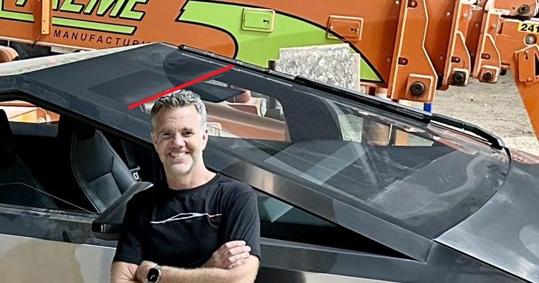

So, first lets confirm we are talking about the things I think we are. These are the forward most of four on each side. Now, no reason you couldn't mount a set of lights there, and Tesla might even offer one, but I don't see it be stock for the reasons of cover requirements.

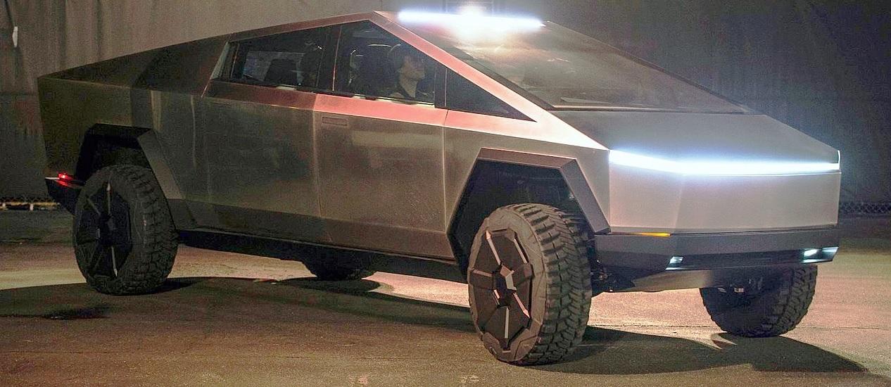

Thank you for KChilites link where they have links to state rules. I reviewed CA, specifically 24400 and 24411 of vehicle code, where headlamps must be below 54 inches (so overhead in CT is too high). If auxiliary lights are mounted overhead, must be covered and off when on-road.
https://leginfo.legislature.ca.gov/...12.&title=&part=&chapter=2.&article=7.&goUp=Y
So the 2019 reveal with lights under the top end of the windshield (see pic, they are under the glass, not mounted outside on top of roof) will need to be covered (maybe an internal flap like a sun-visor can slide in place).

See the dark slots visible through the glass above the red line. There could be lights deep in there and a solid flap internally to cover them when on-road.

Have the light bar adjustable and pointed downward by default, making it a “map light”. It is mounted inside the cabin, right?
I mean it could be, and Teslas been know to lock horns with regulators, I just know if this is a hill they want to fight for. Might be.
