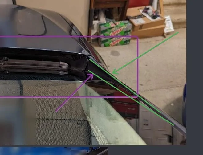

I 100% think they could have figured out how to drop down the front of the windshield and cradle the lower part (green) beneath the straight 3MM stainless side.
To me, it is an absurd failure that most will think is just an engineering team and leader throwing their hands up give up. 🤷🏻‍♂️
Tesla Cybertruck Windshield Wiper Ideas - Let's Help Tesla! UewtUSZ
Green is windshield like the Model X.

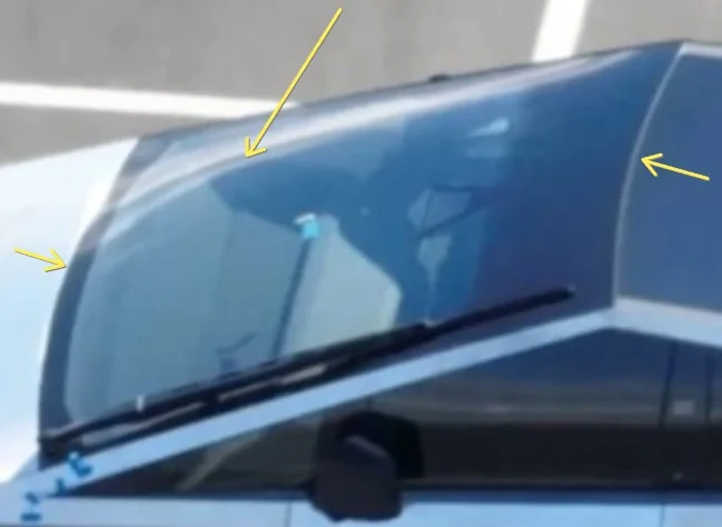

It is mostly flat but definitely has a curvature. The picture below shows it well.

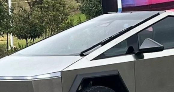

Re: Muddy water effect on CT windshield wiper.

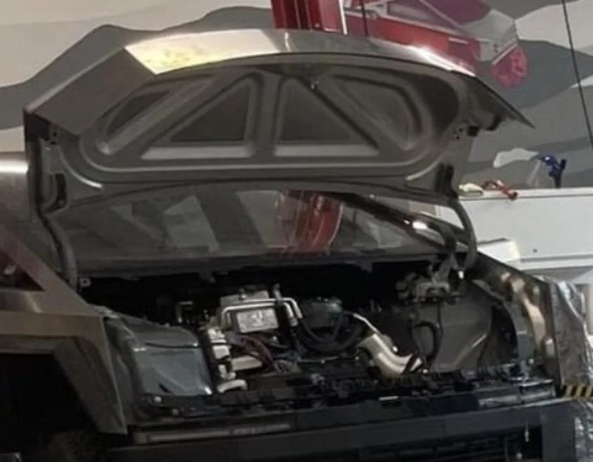

Re: NOT my red arrows. I was just looking for proof of nozzles integrated within wiper. I see a tube. Unclear if it works like Model X tho.

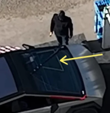

Re: Driver focused wiper testing it would appear based on the 'test tape outline'.
