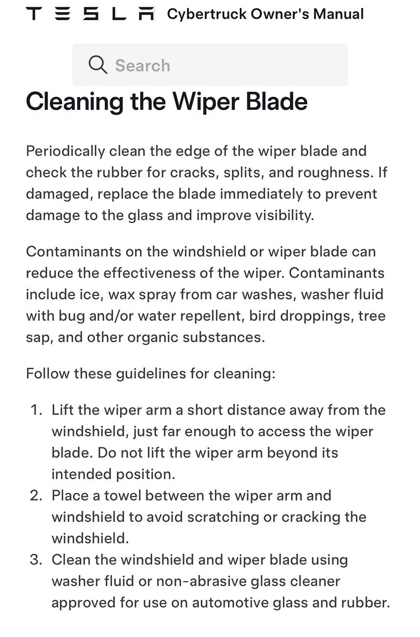

I hate to be that guy that tells you to read the manual, but I kind of have to here.
Tesla Cybertruck Wiper blade issue - blurry streak IMG_0260
