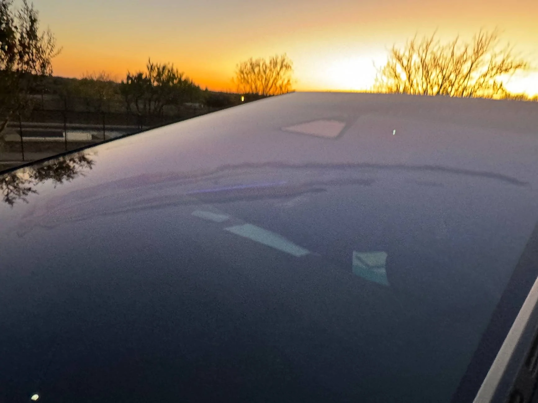

Anyone else having this issue where the middle of the wiper blade leaves a blurry streak? Makes it really difficult to see out that area.
Yep! They replaced my wiper arm, wiper blade and wiper motor... when i said it was still happening they adjusted tension, when I said it was still happening, they said "yeah, it's a known issue and engineering is working on it, but don't know when they will have a resolution."

I I cleaned and cleaned using glass cleaner. Still got streaks. Looks a bit oily with rainbow color reflection.

With an otherwise great car the blade is really a very weak link. I’d love to see Tesla fix this, and I wouldn’t mind it if the NHTSA were to get involved.

Yea mine does this from time to time. Also several spots down to the edge half, spray away glass cleaner then I will lift the blade and run my bounty towel down it to clean the rubber contact blade. I also apply rainx at washing and have rainx bug and tar juice in the reservoir. Helps keep the issue at bay.
