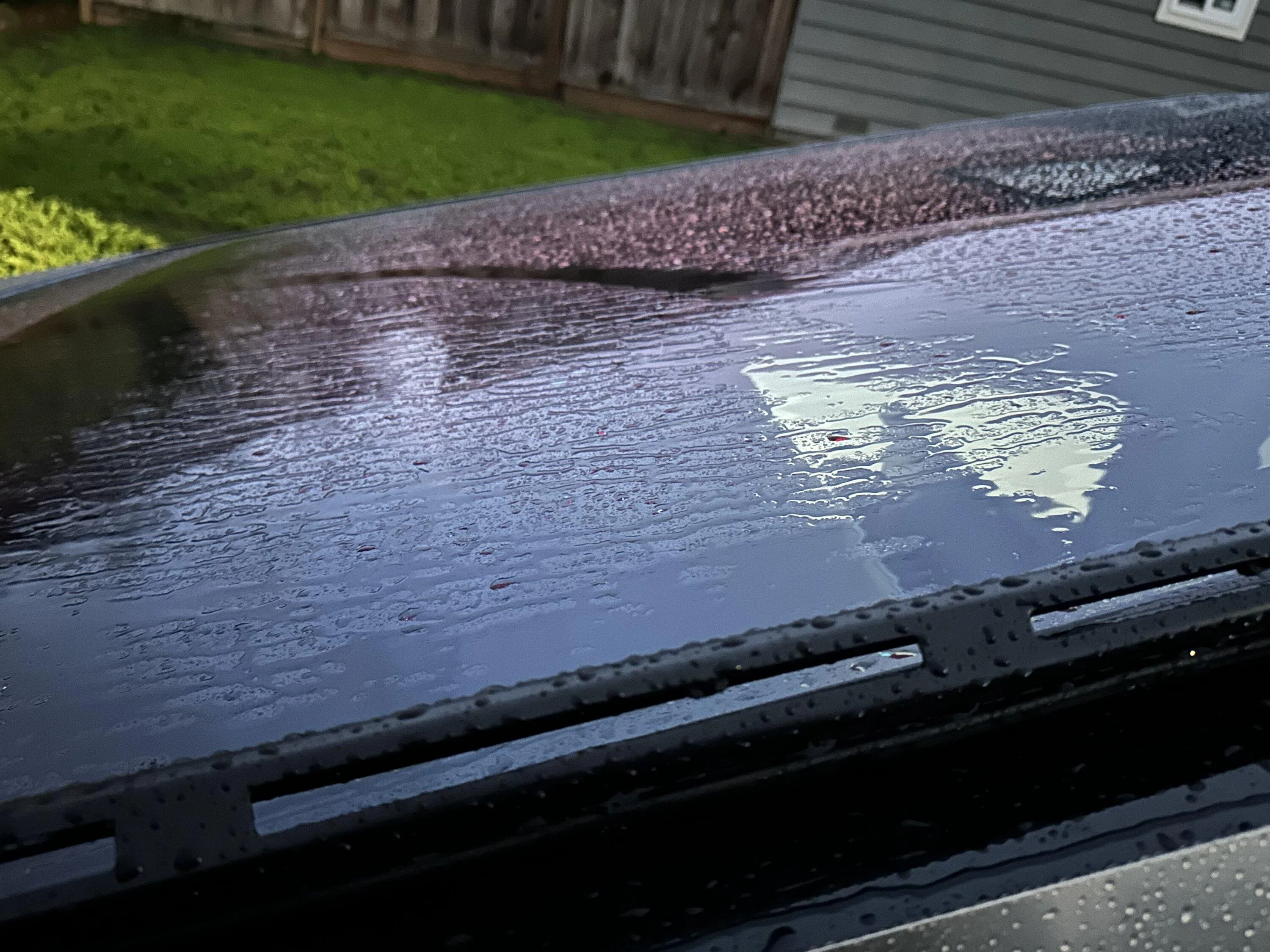

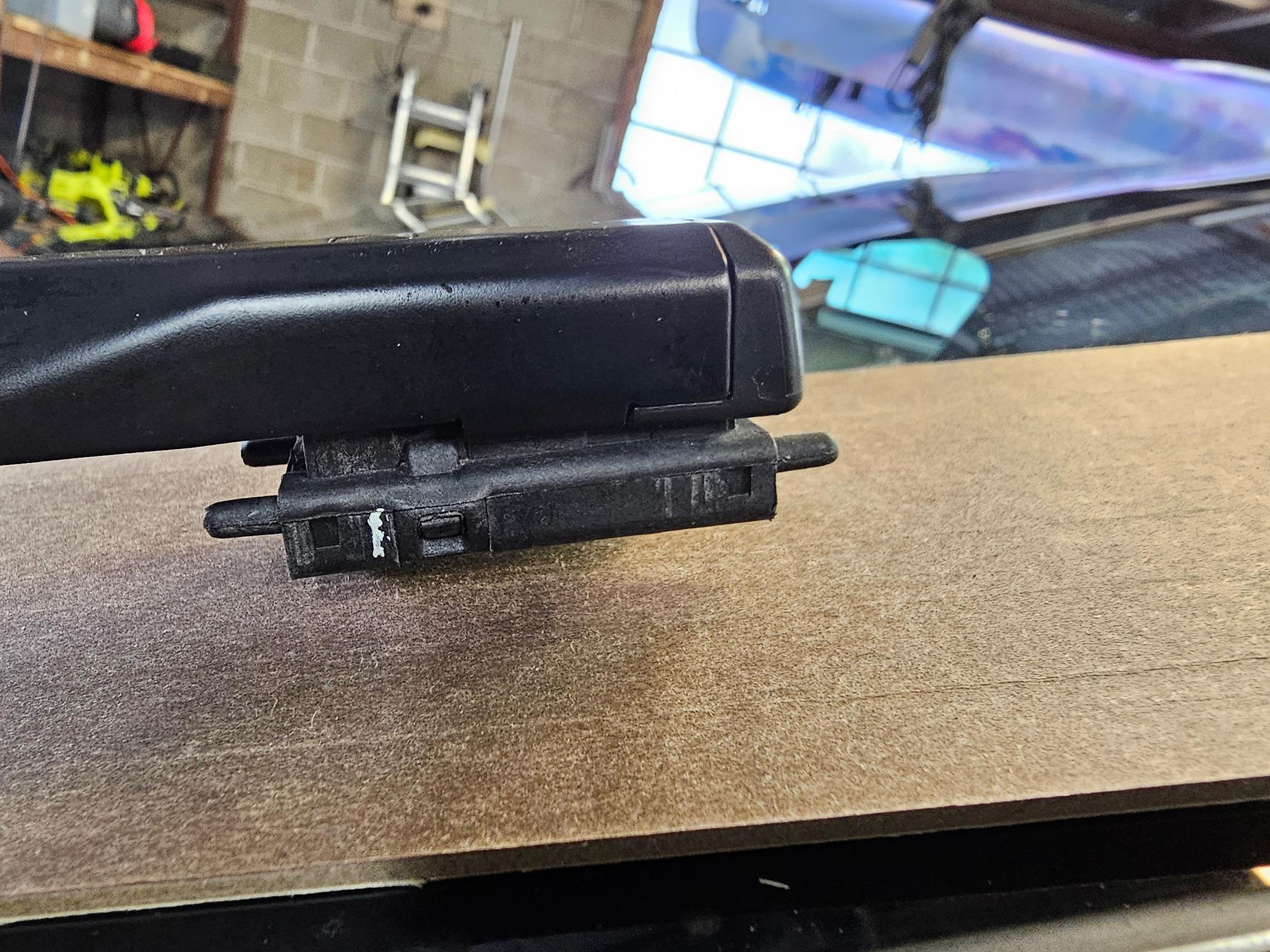

Omg. My wiper fell off this morning in light sprinkles. Scratched windshield before I could turn it off. Kinda folded at the top edge then just disintegrated.
haha happened to me but luckily at the service center
they said the bolt was completely stripped. Not sure how.. I'm wondering if this is going to be an issue with use

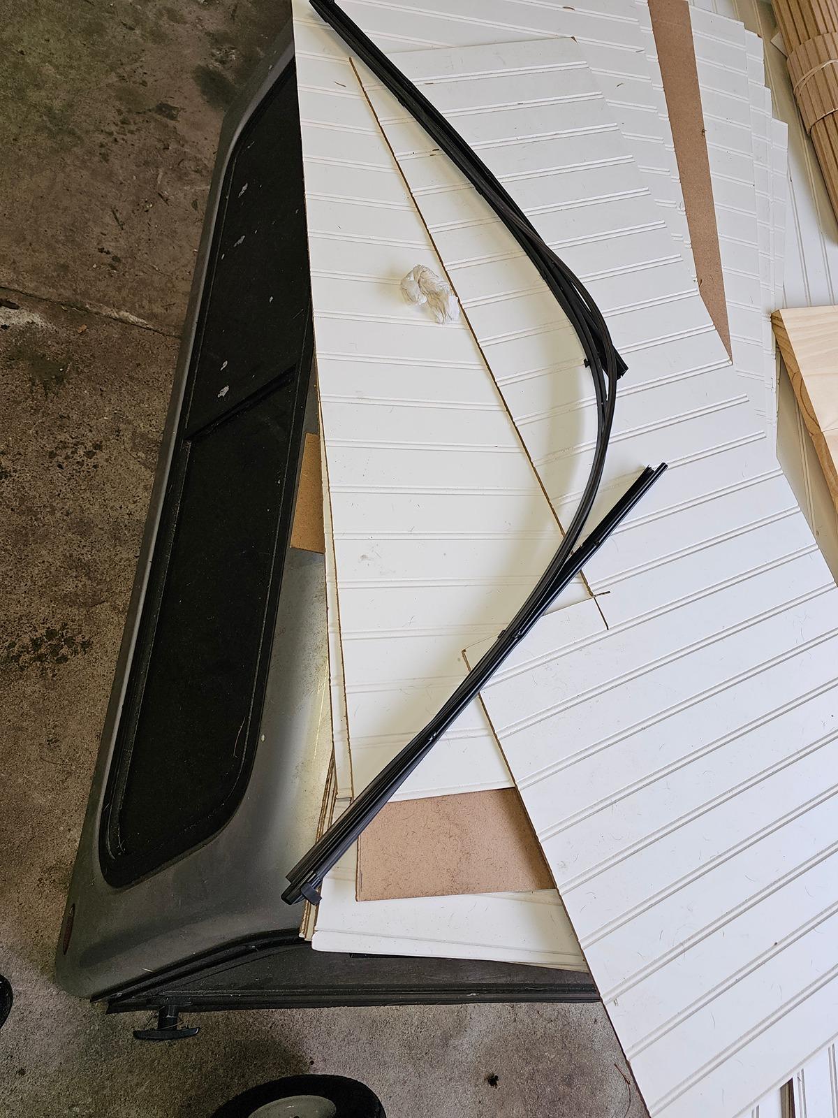

After 3 hrs of cursing I managed to reassemble the wiper blade. Which is great because they wanted to keep my truck for 3 days till replacement wiper arrives

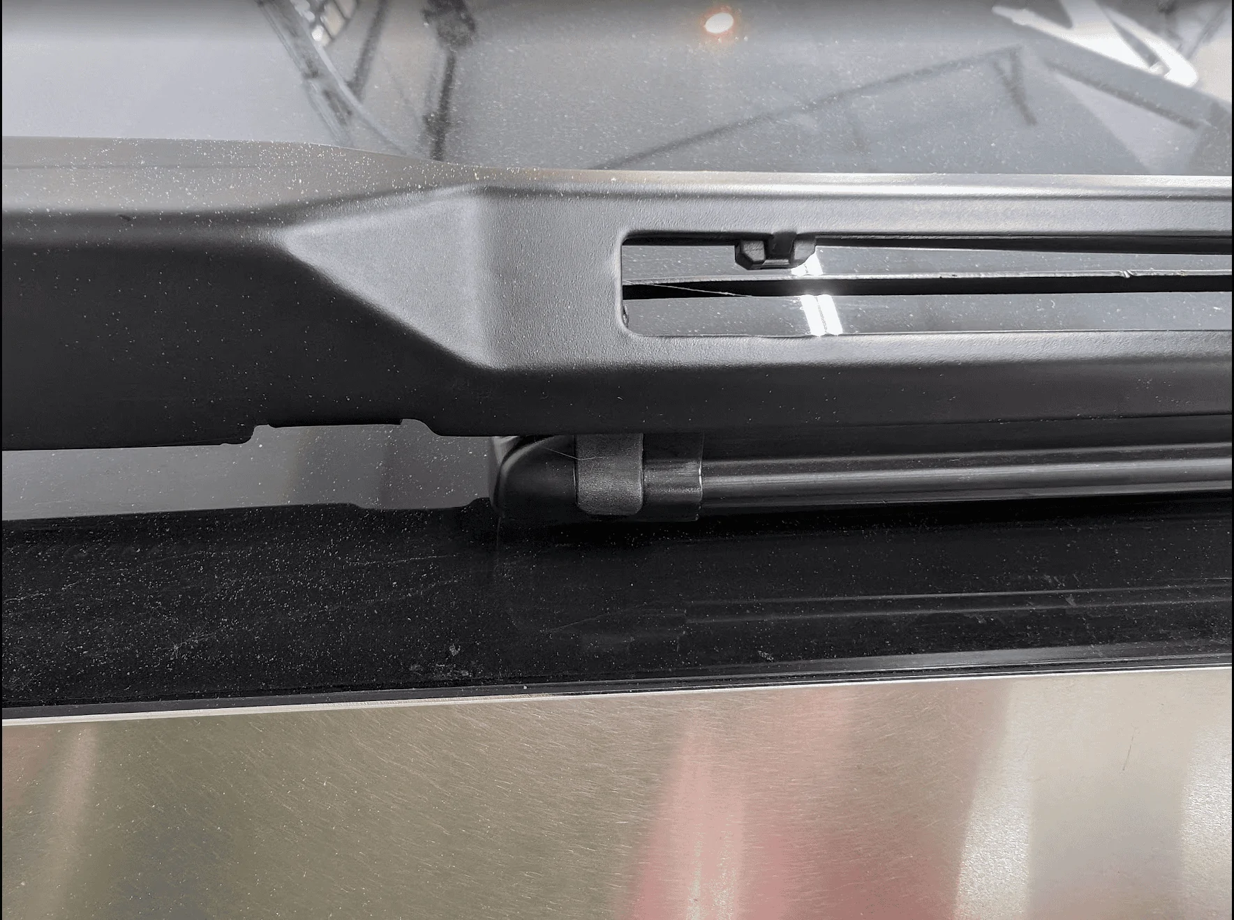

An update.... service replaced the wiper blade. They placed the new one with the clip thing at the bottom held by the edge of the arm on the inside instead of it being centered. Looks wrong but when I asked the service guy insisted that's how it belongs. I put it back inside after I left.... this can't be right..... although my old one was inside and it curled and died.

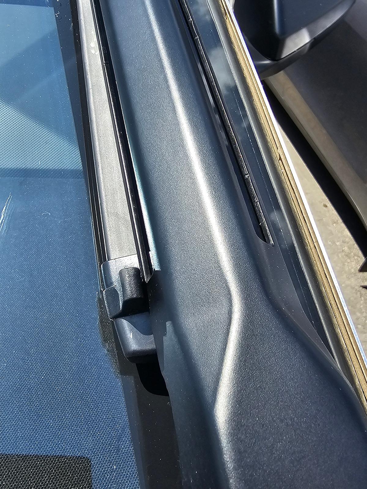

Huh. Mine is inside the arm shroud.
