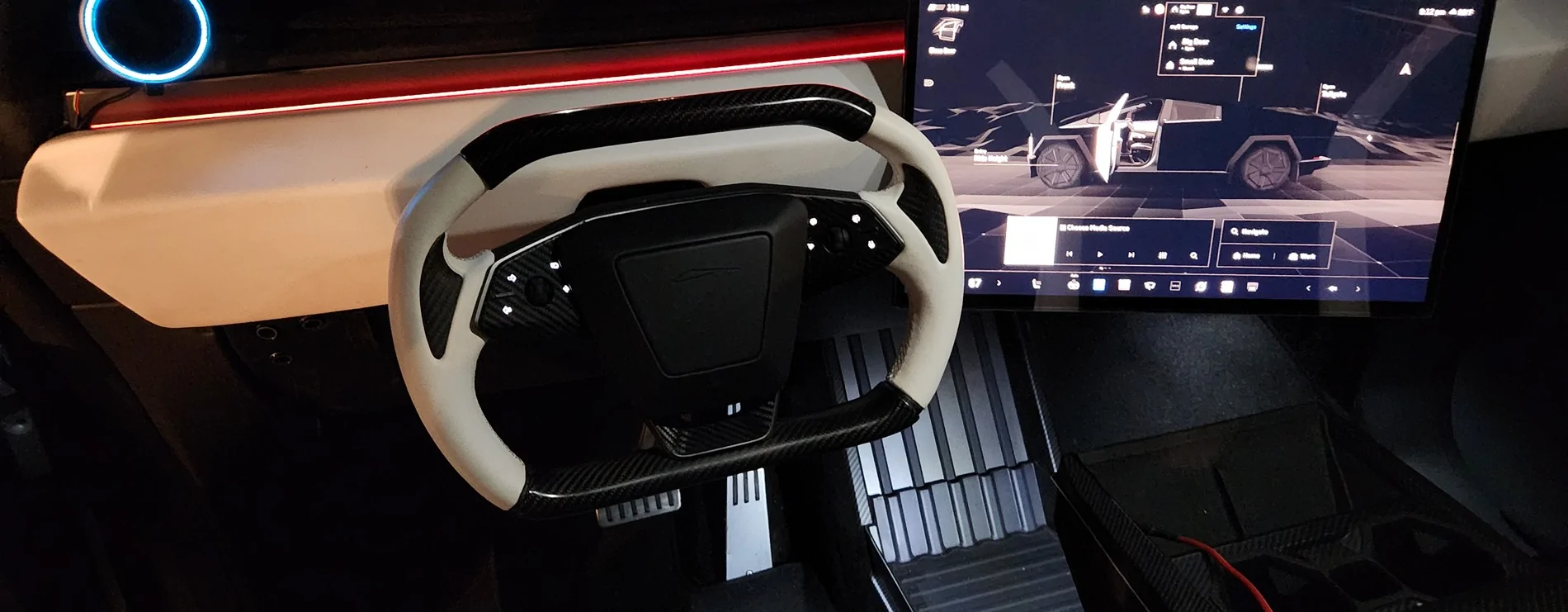

Niceee. I purchased the one all carbon fiber but I wasn't able to install it. The screw was to tight. Did you replace it yourself? You didn't need to recalibrate after install it? No problems on FSD? or any other issue after installing? I really love it but I m afraid to mess it so it s sitting in a box for now. Any advice is appreciated. thanks
Yea the bolt required a little extra elbow grease but i just used a ratchet with an extendable arm and had someone hold the steering wheel and got it off that way. The only issue i had was when pulling the steering wheel off MAKE SURE ALL ELECTRIC CONNECTIONS ARE DISCONNECTED. I disconnected one and forgot the other and i pulled hard and all the internals flew out. I just sat in shock watching the column rapidly vibrate back and forth. After my local SC fixed it I tried again this time with more patience and it was a smooth process. No recalibrating, No FSD issues.

Everyone - Please follow @cypherbeats recommendation. The Cybertrucks Steer-By-Wire system is a totally different animal than the other Models. You can do great damage to your vehicle if you don't follow Tella's instructions. Don't use YouTube videos. Half of the videos out there are garbage when describing how to do this..
Follow TESLA's installation instructions to disconnect BOTH the accessory (blue) connector and the MV low voltage (red) connector as stated here: <--- before you start.
Disconnect MV Power
Then remove your Steering wheel. Please remember to follow Tesla's instructions to the letter.
Steering Wheel Pur Heated (Remove and Install)

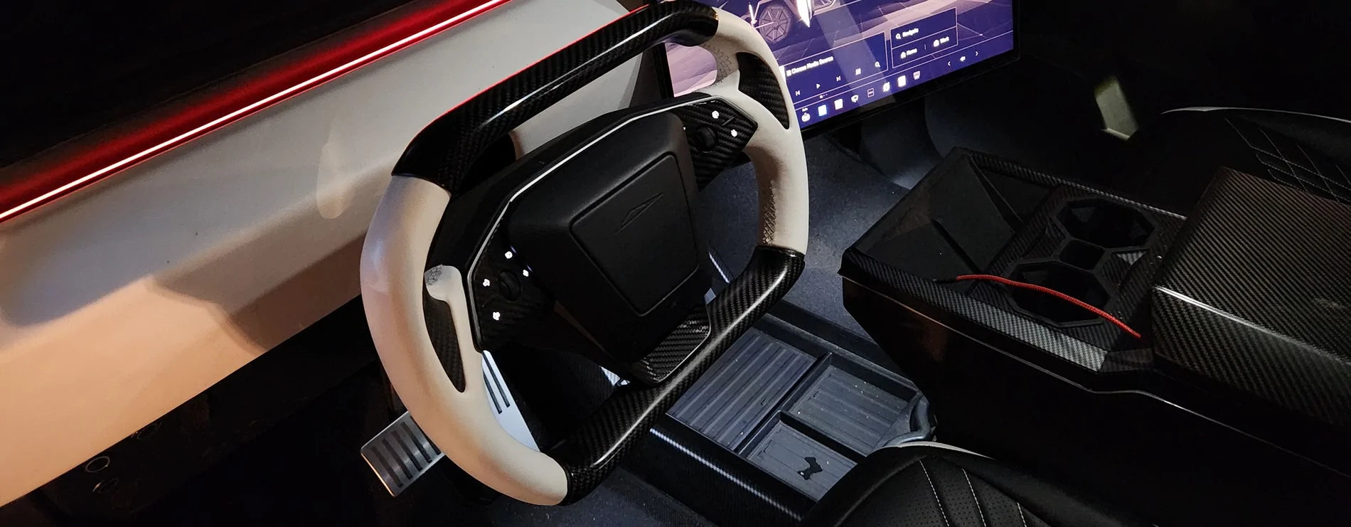

I replaced my steering wheel with this carbon fiber and white napa leather one:
Tesla Cybertruck Yoke Alternative 20250921_211243
Tesla Cybertruck Yoke Alternative 20250921_211258

I would never do this because I don't know what I'm doing, I'd be afraid to screw things up and I like the OEM one (I have gray interior), but that wheel looks really great with the white interior.
