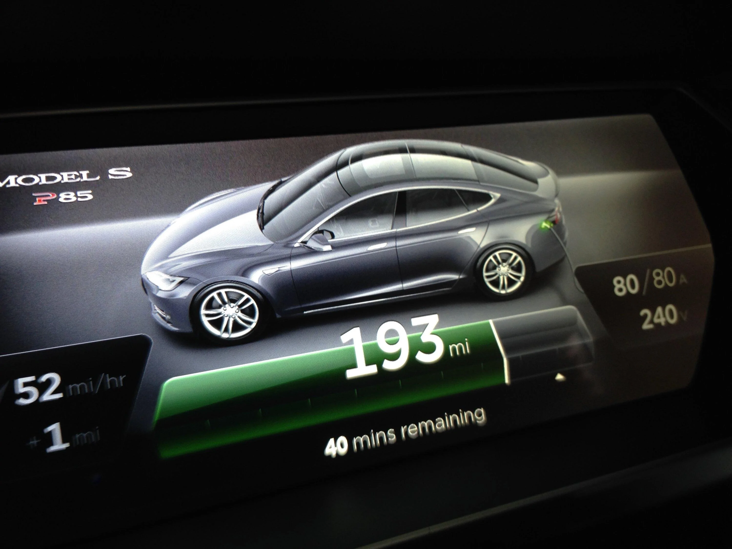

AFAIK, It's not correct. The Model S never went to 92A it was limited to 17.2kW
From a kind of random site, but it jives with what I know and remember.
  1. Maximum power intake of your Tesla: This is either 17.2 kW or 11.5 kW depending on which variant you own.
    • All Model S variants come standard with 11.5 kW charging to for a maximum of 32 miles of range per hour charging.
    • Model S variants with the “High Amperage Charger” option can accept up to 17.2 kW of power for a maximum 52 miles of range per hour.
AFAIK, each vehicle has two separate "chargers" (I had one go out a while back and AC charging was cut in half). The Model S and I think the Model X has some models that supported a third "charger" So if you had the extra module installed, you got a higher charging rate.
That brought the circuit requirements up to 100A, which is far beyond what many homes have available. There are a huge number of homes that can't even support 60A charging.
Can confirm via a picture of my 2014 Model S Dual Charger on pickup day. 80A charging (on a 100A circuit in my garage) getting 52 miles of range per hour.
